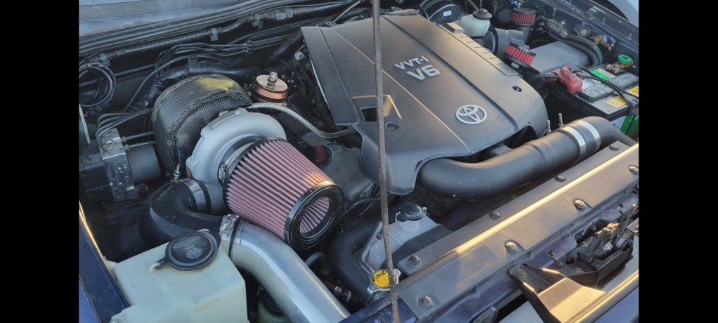

    Just signed up to TW. Here's my 2013 Xrunner with a S366 @ 7.5 psi. I have my brother's @RedLantern old hotside. Fabbed up my own intercooler piping. Its tuned with Hptuners, but im really intrigued with @Xrunner2nv and @Torspd using Haltech to get rid of their Maf . Cheers!Screenshot_20250327_062602_Gallery.jpg

    Nice, really clean

    That's a great kit. Glad it's still around. Welcome!

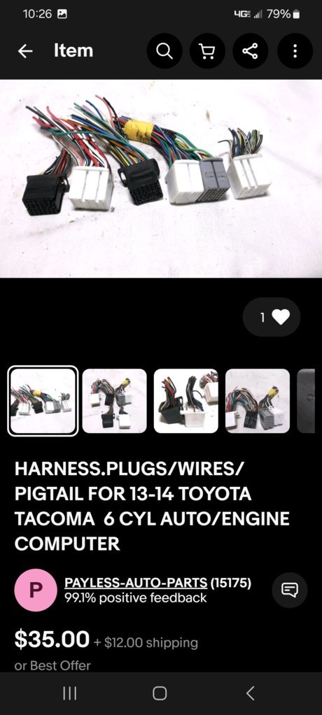

    A wise man on here once repinned and soldered the 05-08 ecu plugs onto a 09+ ecu. That way he could use the UCON on his 09+, we'll before URD made the new plugs. That thread still exists, with fine details.
    That would work. The other way, is to get a UniChip harness for the 09+, and send that to Boomslang. Then they can make their harness work with the Unichip to work with the 09+ ecu.
    That has been done before as well. A member on here with a turbo XRunner did that. I helped simply by sharing that knowledge, and it worked.

    Screenshot_20250328_102630_eBay.jpg So if I got something like this and sent it to Boomslang........
    I definitely got some research to do, lots of good info, thanks for getting the ball rolling for me!
