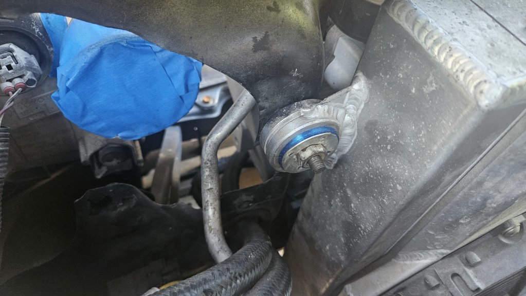

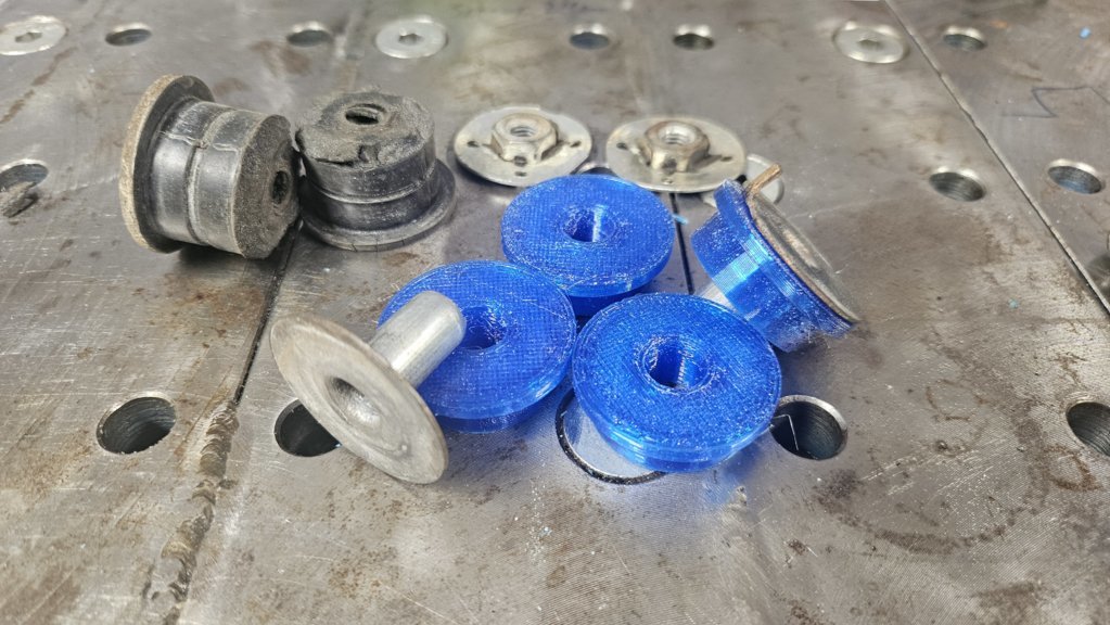

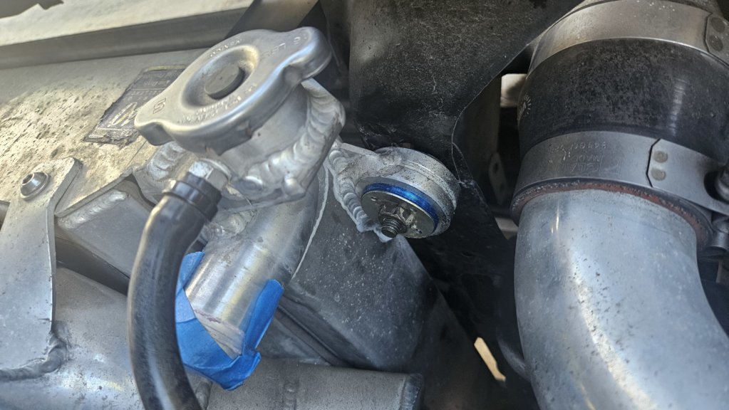

    My current radiator bushings were crumbling. Now yes, my radiator is an aftermarket one (Ron Davis Radiators). However, it was modeled off of the OEM radiator. So these bushings should work with the OEM radiator and other aftermarket radiators. Such as AEM, or the other brand that eludes me currently.
    Compliments to @Brice for getting these made for me. I took some measurements and sent them to him. Voilá. He shared with me some other pieces that they have used, which have been in service for years in the elements. Without failure.
    Time will tell, but I feel confident at this point that they will last without worry.
    Hit up @Brice if any of you guys are interested.

    Nice, but the original ones are rubber for a reason- allow for manufacturing tolerances in mounting, absorbing vibrations, thermal expansion/contraction of the radiator.....

    These are Not Delrin. These are meant specifically for what you say. Simply a little higher durometer than the rubber.

    These are 95a tpu (thermo-polyurethane). They were 3d printed. They are likely harder than the factory rubber ones, however, while this particular set hasn't been tested in exactly these conditions (stationary circular mounts) I have extensively tested them in similar conditions: C10 radiator mounts (where they mounted directly to the end tanks), motor mounts, door bump stops, control arm bushings and as trailing arm bushings. I'm fairly confident they are still plenty pliable to give when the radiator expands and contracts.
    The C10 radiator isn't apples to apples because they were c-channel shaped and weren't captive in aluminum, the mount was fully tpu.
    Could be wrong though, I'm sure @Torspd will let me know if I am :D

    You could always go to more of a sparse infill to reduce the rigidity. TPU is super resistant stuff, they'll probably outlast the OEM.

    These are 50% rectilinear, but 20% would likely be a bit better for flex.
