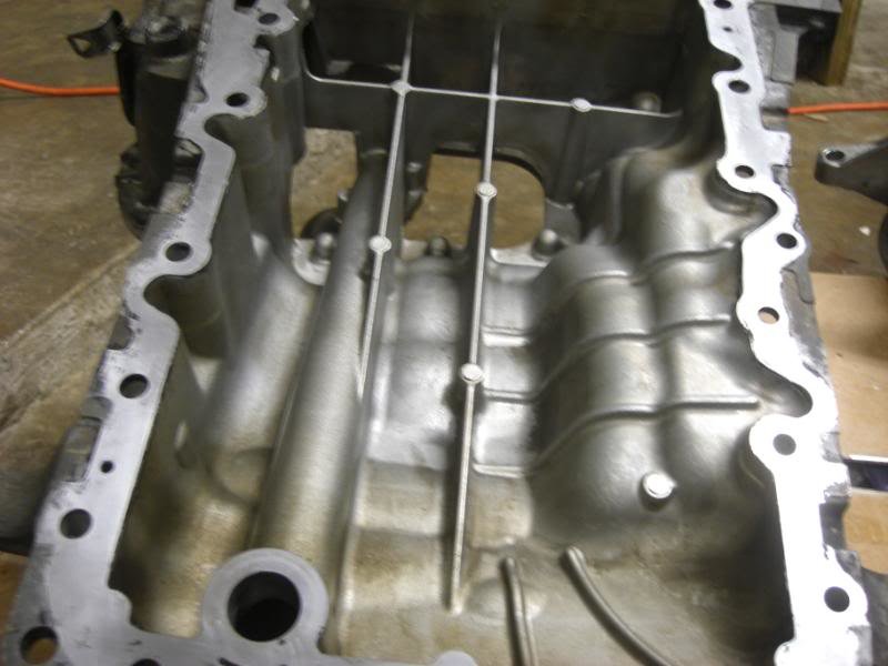

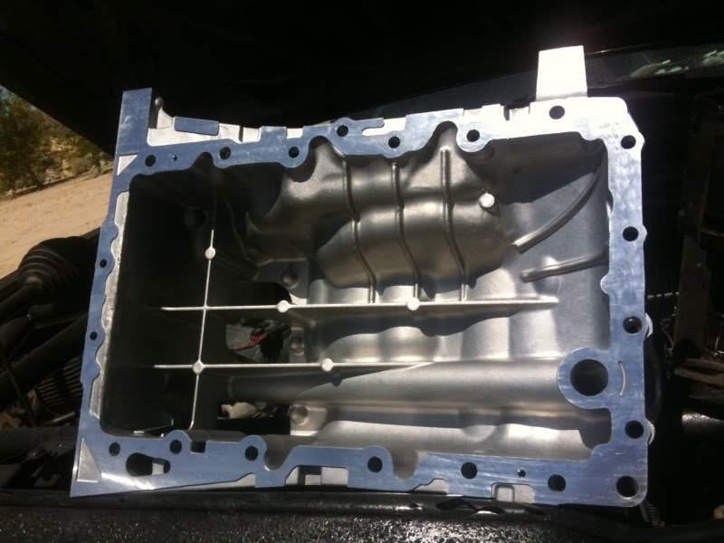

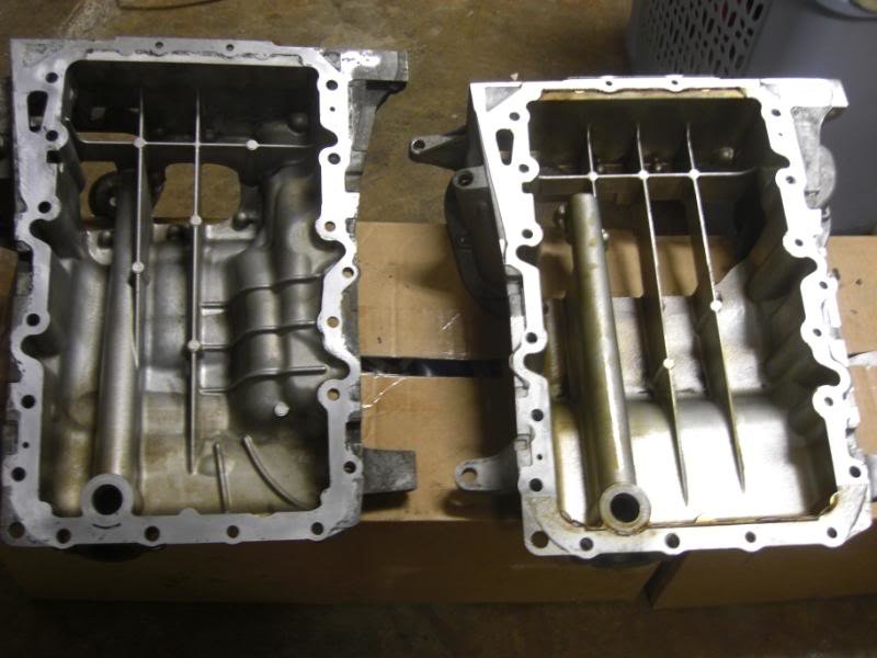

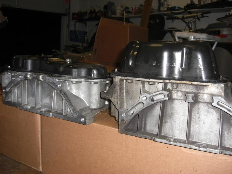

    Well I'm trying to put together a group buy for a GR family compliant dry sump system. I'm going through each of the communities that run the GR block family to see if anyone is interested.
    Anyway here is the 1GR oil pan.
    Here is the 2GR oil pan
    They are fairly close and if we have it tapped for both the 1grfe and the 2grfe. We can cut costs and its marketable to multiple communities. The 2grfe is not only vary popular swap for the older 90s MR2s, but is also used in the Lotus Evora. From my research the 1GR does vary from tacoma, FJ, and 4runner. So Id need some information from you guys to make this work, as I'm not an expert on the truck side of Toyota.

    Who are you looking at to implement this system, A.R.E? The pan you posted looks like its from the newer dual vvti 1gr. Have you also thought about using thicker oil for your turbo system?

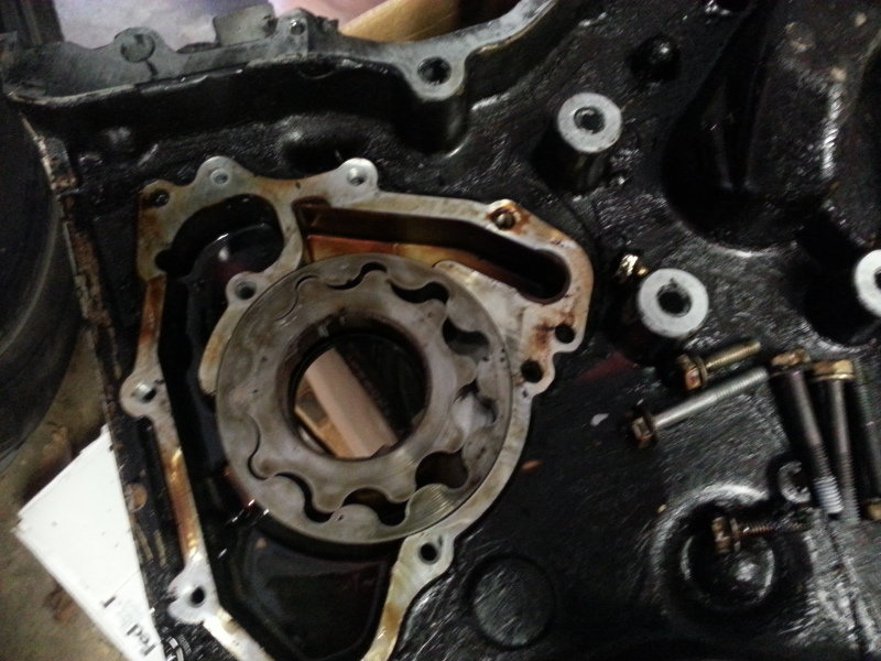

    What is the RPM limit that you/you guys have found for the oil pump, before it starts cavitating? Do you have any pictures of your style oil pump? I might have one of ours, just for comparison.

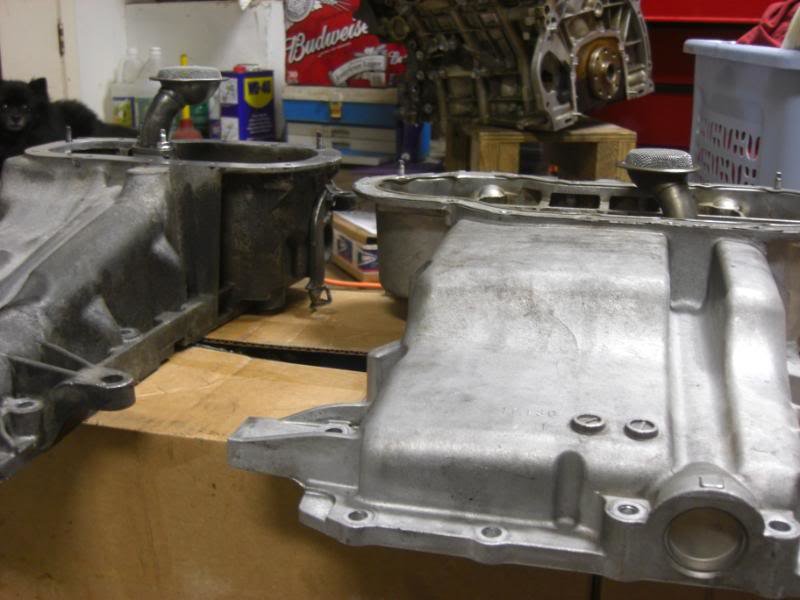

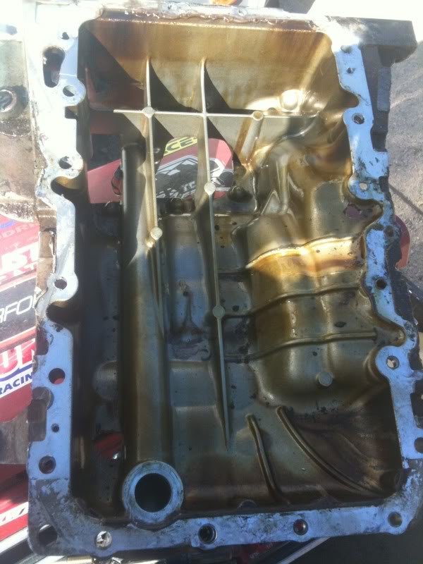

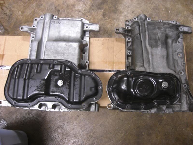

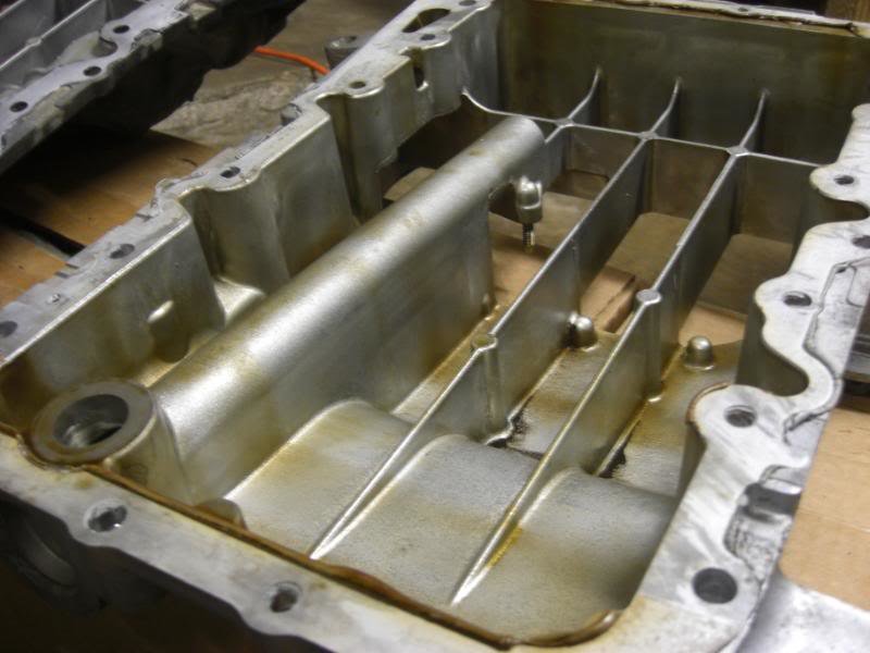

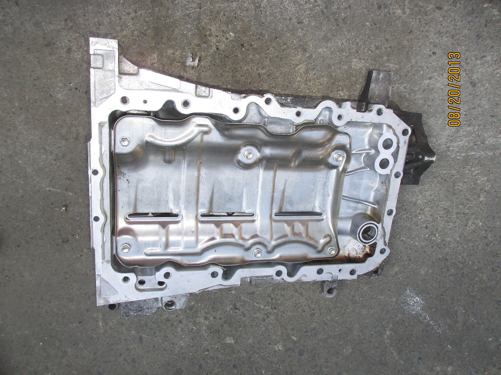

    Here are the two upper oil pans from the single VVT-I 1GR. The 4x4 and the shallow. Where as the one you posted, Siman, is as Lucario Runner stated. From the Dual VVT-I 1GR, found in the '10+ FJ and 4Runner.
    4x4
    Shallow

    username
    username Fluffer
    Oct 15, 2010
    #44704
    6,064
    Pendleton, Or
    05 Taco with some crap welded to it
    mostly stock
    Just an FYI there are a couple different pans for the 1GR. This is one off of my 4wd. The oil pickup is a little less prone to cavitation than the x-runner style pan IMO.
    (EDIT: Torspd beat me to it. lol)

    You'll have to excuse the burnt oil. Previous owner shunned oil changes.
    Our oil pump.
