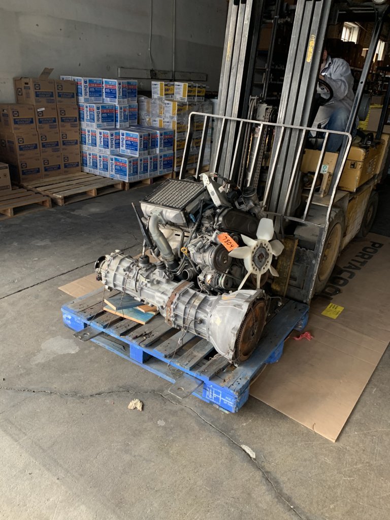

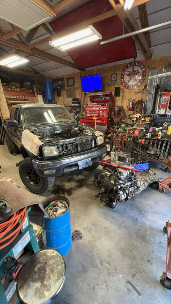

    My truck originally was a 3.4 automatic which was fine for a daily and the occasional trip to the mountains but it just wasn’t nearly as cool as being the only guy around with a diesel yota. The idea rattled around my head for a few months until I found a build thread from @anothernord and decided to do it myself instead of forking out $20,000 to have a shop do it. I started looking into the oil burners our overseas friends get to enjoy and found one for a decent price ($3,700 shipped back in 2020.)
    Here’s how it arrived:

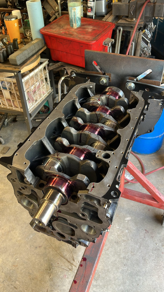

    First thing I did was pull the glow plugs to make sure none dropped which I was told is a common issue with the kz motors. Number one had dropped the tip and left a small dimple in the top of the piston. Probably would have been fine to slap it back together, throw a new set of plugs in and call it good but I also noticed that all four pre-combustion chambers were cracked. So seeing how I had no history or mileage on it I decided to go ahead and rebuild the whole thing. I had the bores cleaned up and new valves, guides, precups, balance shaft bearings, and pistons installed by a local machine shop. I also had the injectors and injection pump rebuilt by Denso.
    Between college and work my project was put on the back burner for a couple years until this summer when I got crackin’.

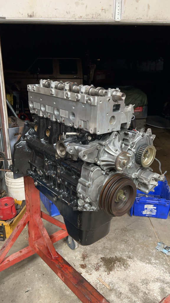

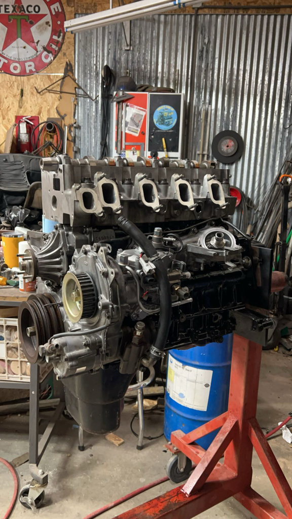

    A few assembly pics after a fresh coat of paint:

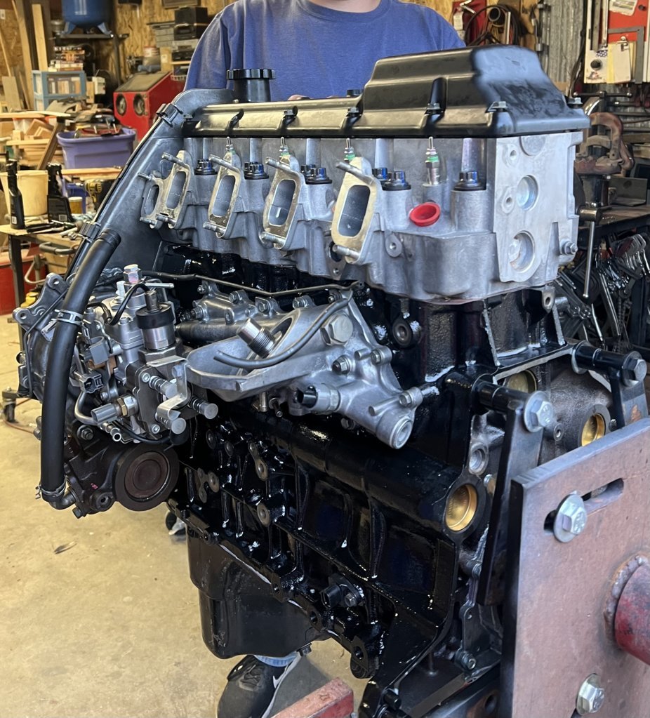

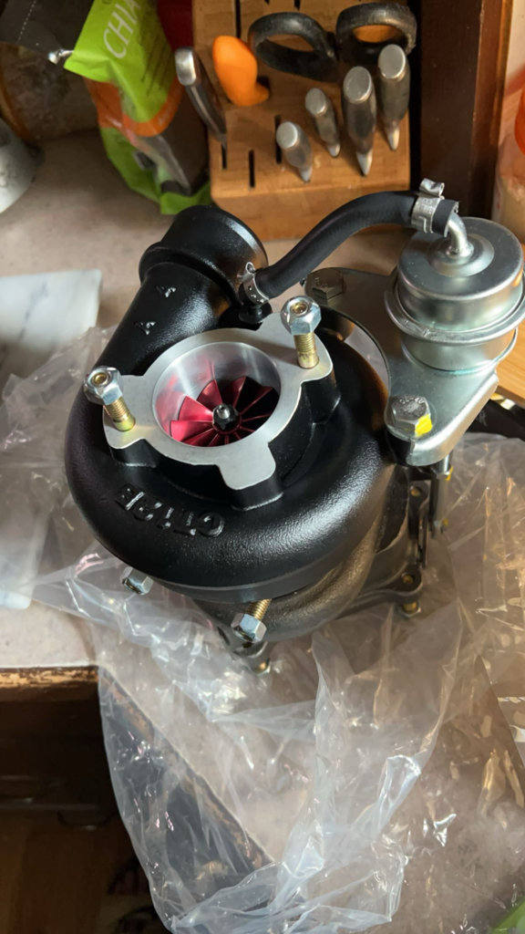

    Turned out that the factory turbo had a crack around the wastegate port and had also been spitting oil into both the housings then up into the intercooler so I opted for a new TDX series CT12B from GCG Turbos, figured getting a high flow couldn’t hurt as I’d like to push around 18-20psi eventually. $1,500 and a month later my little Aussie war whistle was ready.

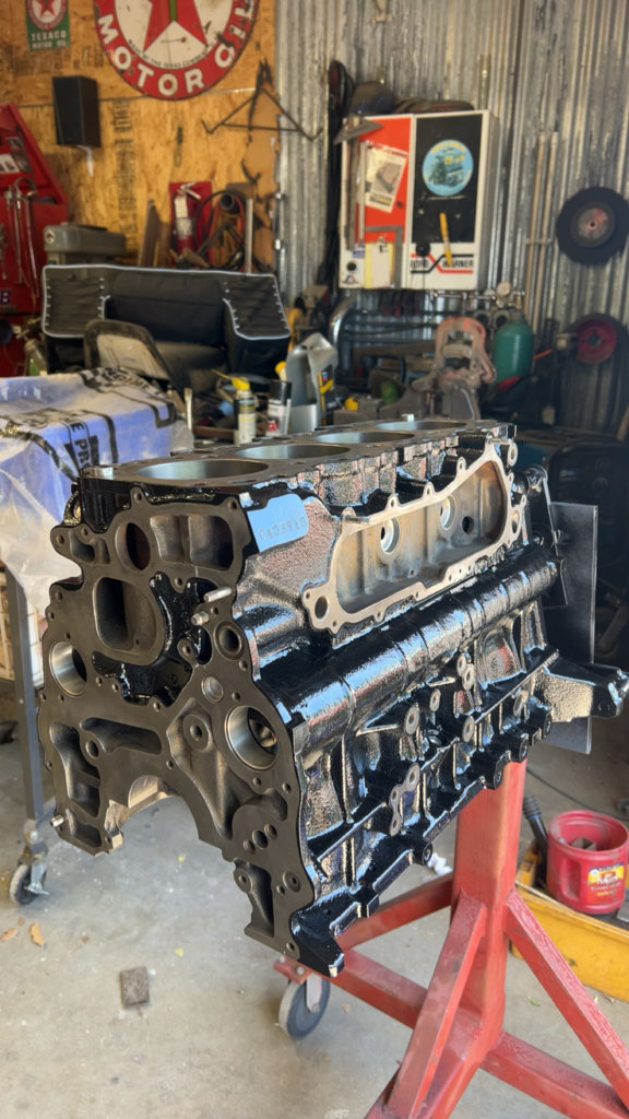

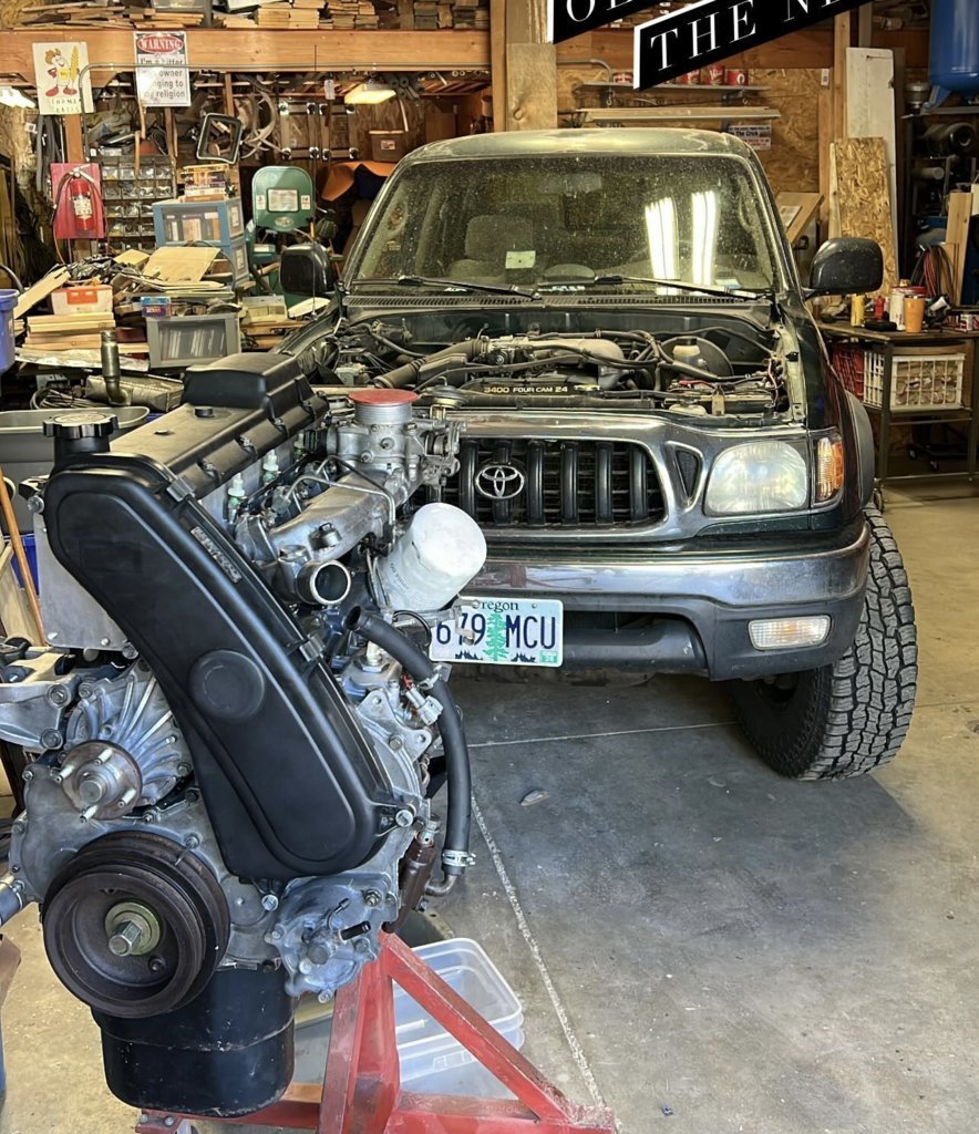

    In the meantime I pulled the V6 and transmission out and got the four banger set in:
    I didn’t get a lot of pics of the rest of this so sorry about that.
    Nice thing is the 1KZ uses the same motor mounts as the 5VZ on the frame side but needed different rubber insulators to fit the diesel mounts. The transmission crossmember had to be moved back about an inch and a half, simple job but a pain to get a grinder in there to cut the factory welds.

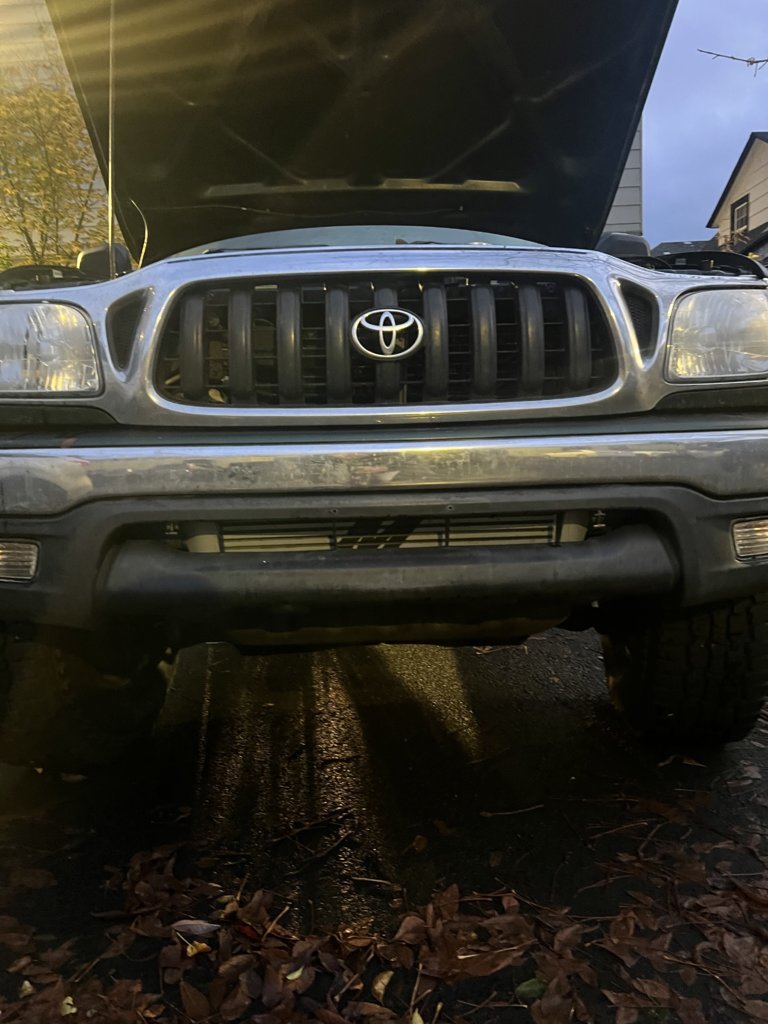

    The factory top mount intercooler was pretty beat up and would have required a hood scoop to work properly so I used a Mishimoto J-Line which fit quite nicely behind the factory bumper. I tipped it downward slightly to get as much airflow as possible without cutting the bumper.
    To plumb the intercooler in I bought a cheap universal kit from Amazon then cut and welded it to fit. I also had to weld in a couple bungs for the air temp sensor and the MAP sensor.

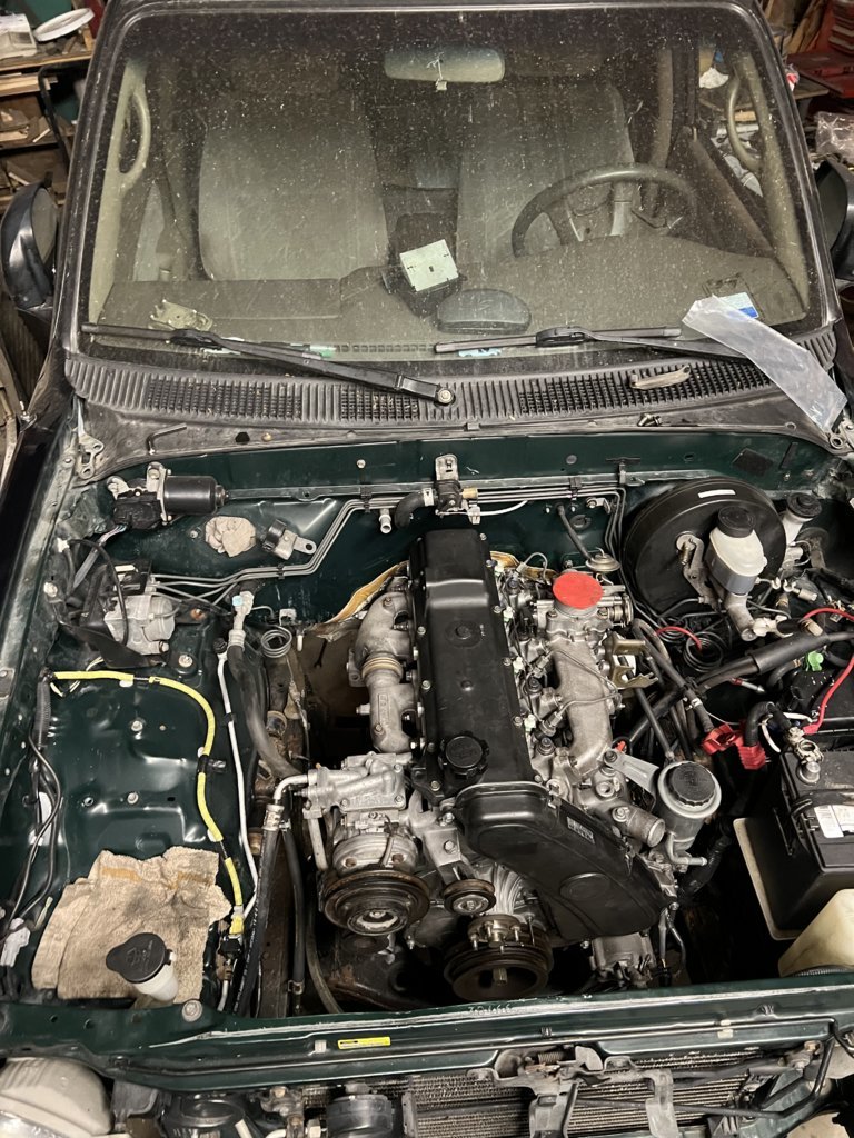

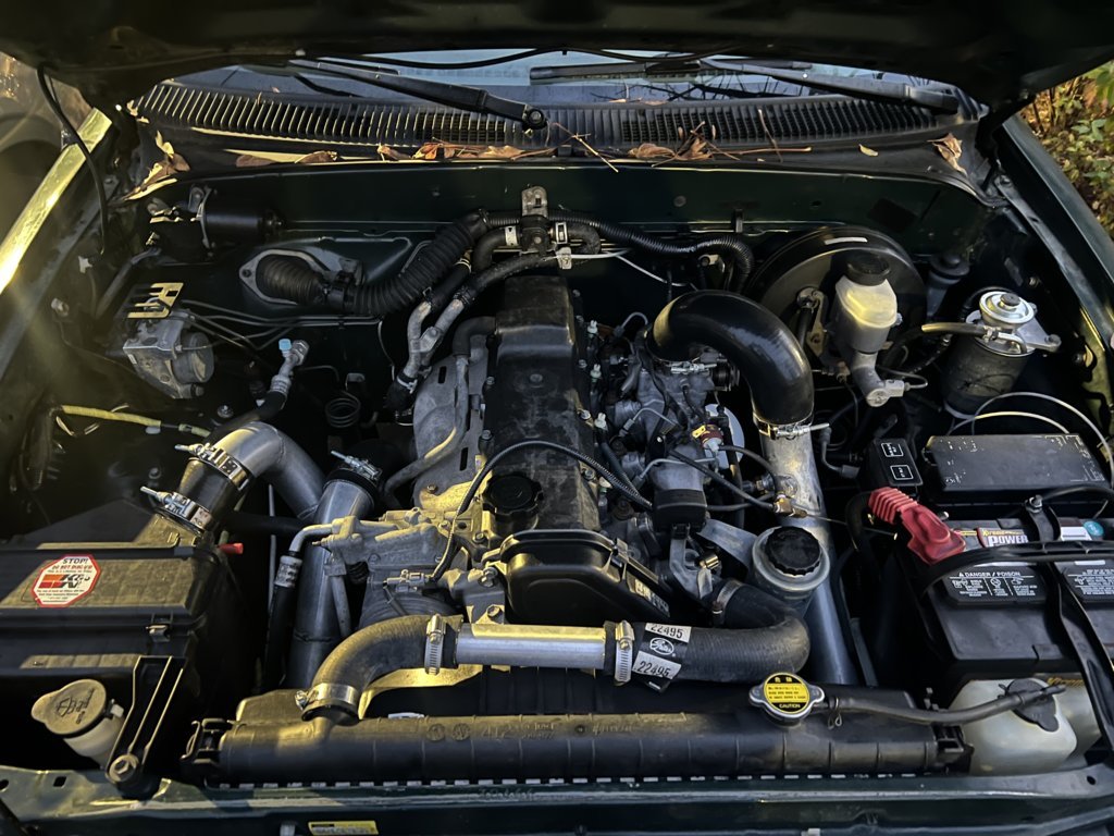

    Here’s the very nearly finished engine bay:
    So far I’ve put around 1,000 miles on it since the swap and can honestly say I will never forgive Toyota for not selling diesels here in the States. So far the only issues I’ve had have been a small leak from the crank seal on the timing gear cover and the tank filling slowly but I think the latter is a result of the filler neck diameter.

    Uses the same mounts as the v6 with different isolators
    JDM engine, got it from an importer in Florida I think
    not sure about the year I think it’s a 96-00

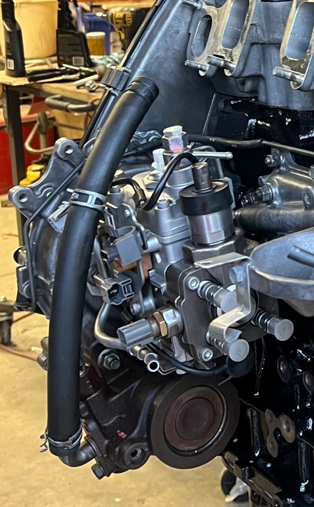

    no high pressure pump just a line from the injection pump to the tank
    The injection pump is kinda funky by USDM standards, it’s basically a mechanical fuel pump with an ECU controlling it

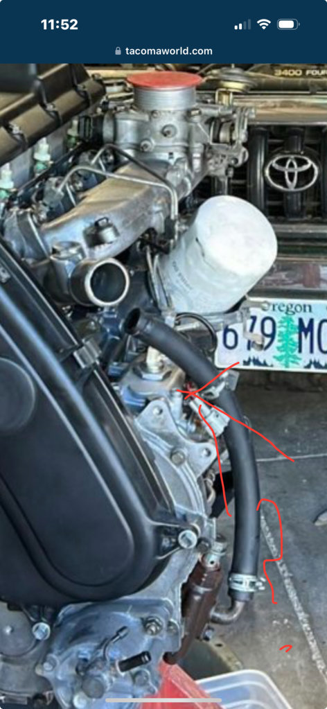

    im guessing here….

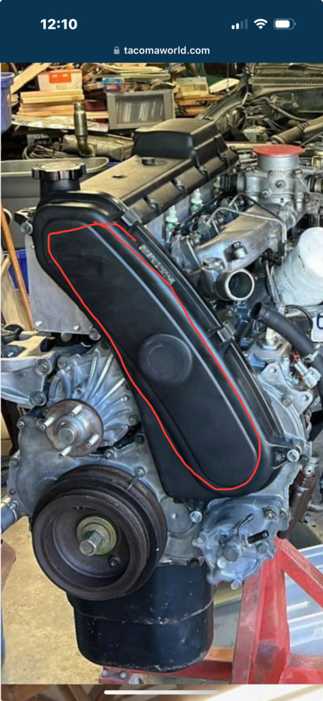

    That MFP is on the driver side of engine I think. Is it here:

    Yep that’s it right there. Heres the backside of it

    Oh wow
    Trying to figure out
    I’m correct saying that MFP is cam driven by a belt???
    Thanks btw
    Love new stuff like this
    In NO WAY am I contesting u!
    Cheers

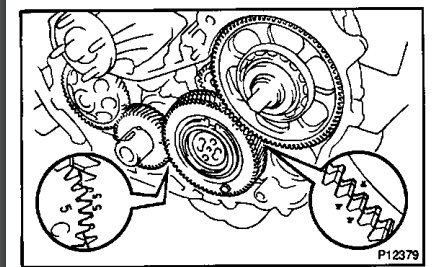

    Actually the pump is driven by the timing gears and then the pump drives the camshaft through the timing belt.
    here’s the repair manual if you’re interested
