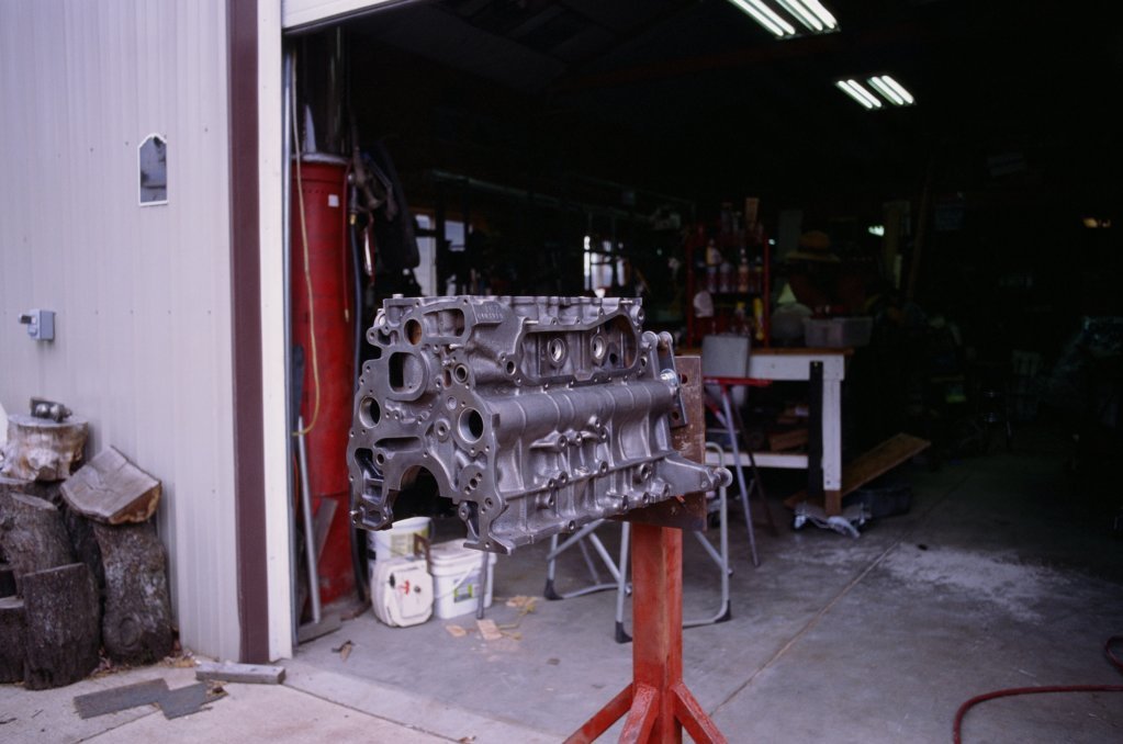

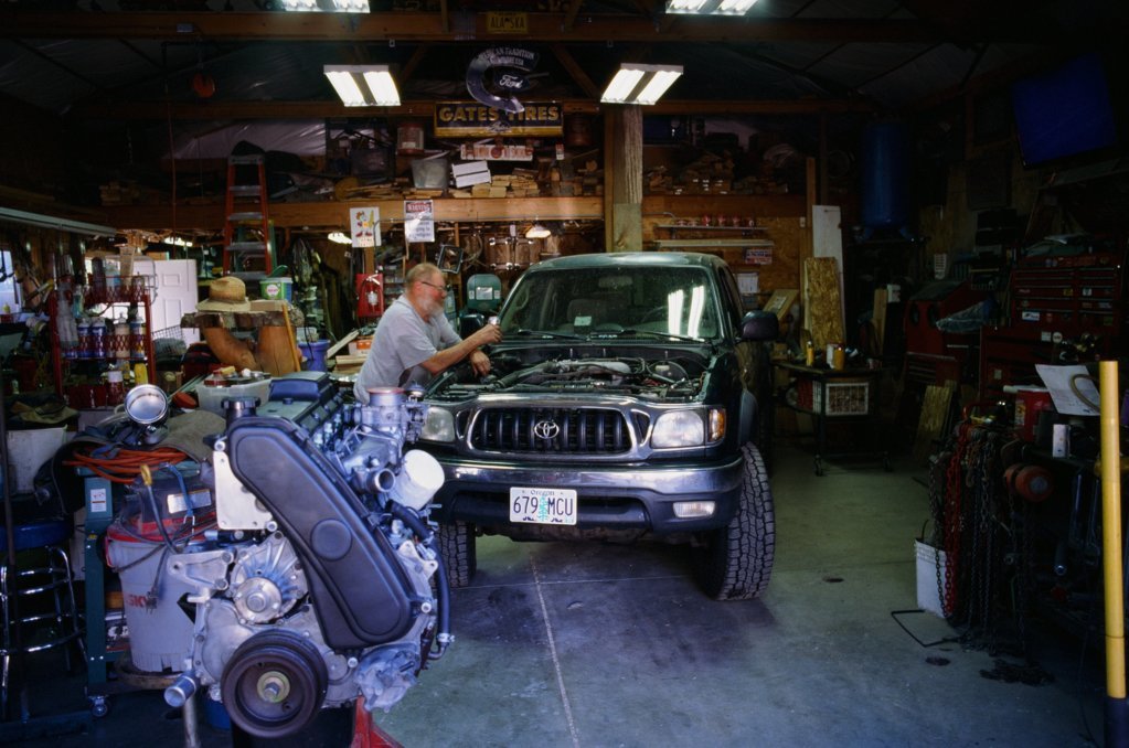

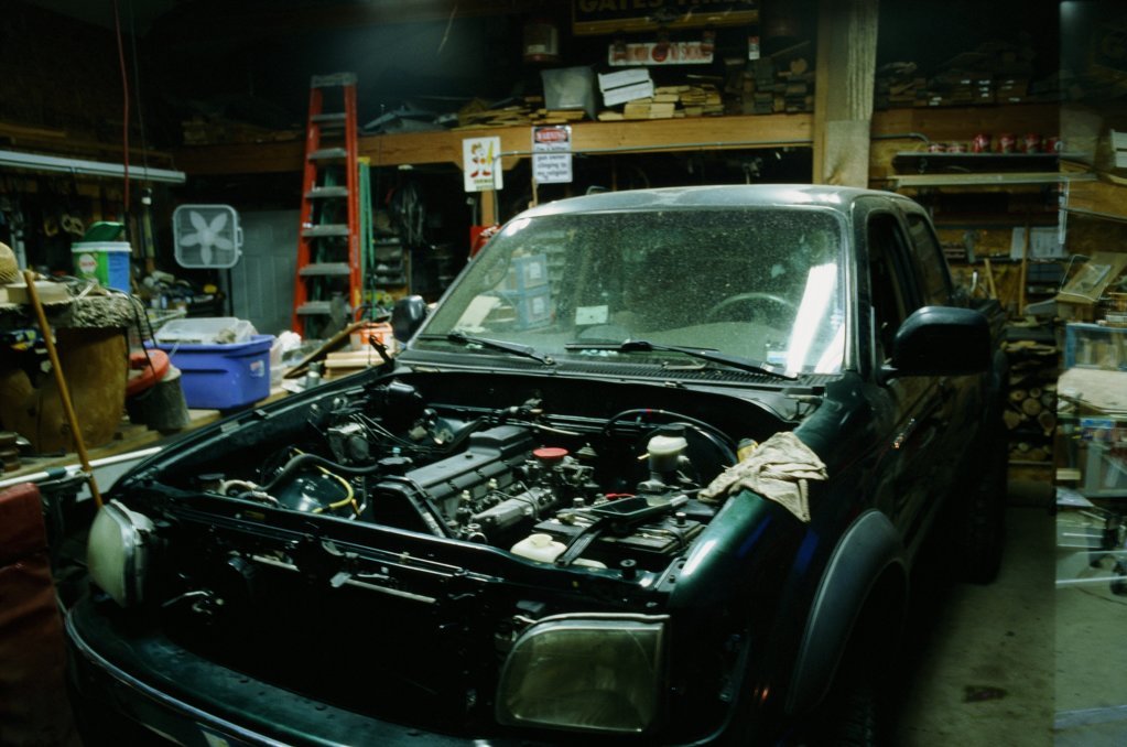

    Finally got some old film developed that had a few build pics on it. Nothing exciting but probably worth an addition to the thread.

    :eek: When did you do the swap 1985?

    Haha I do a little film photography as a hobby. Of course when I was doing the swap I only had one camera with good batteries and it already had 20 something frames used up on a 36 exposure roll. Trying to shoot 100 ISO in a dim shop didn’t yield the finest of results but I didn’t want to risk ruining an $18 roll of Ektachrome by swapping it for a roll of Lomo 800. Had a few shots of the tranny going in and the harness getting dissected but they came out all shakey and underexposed.
