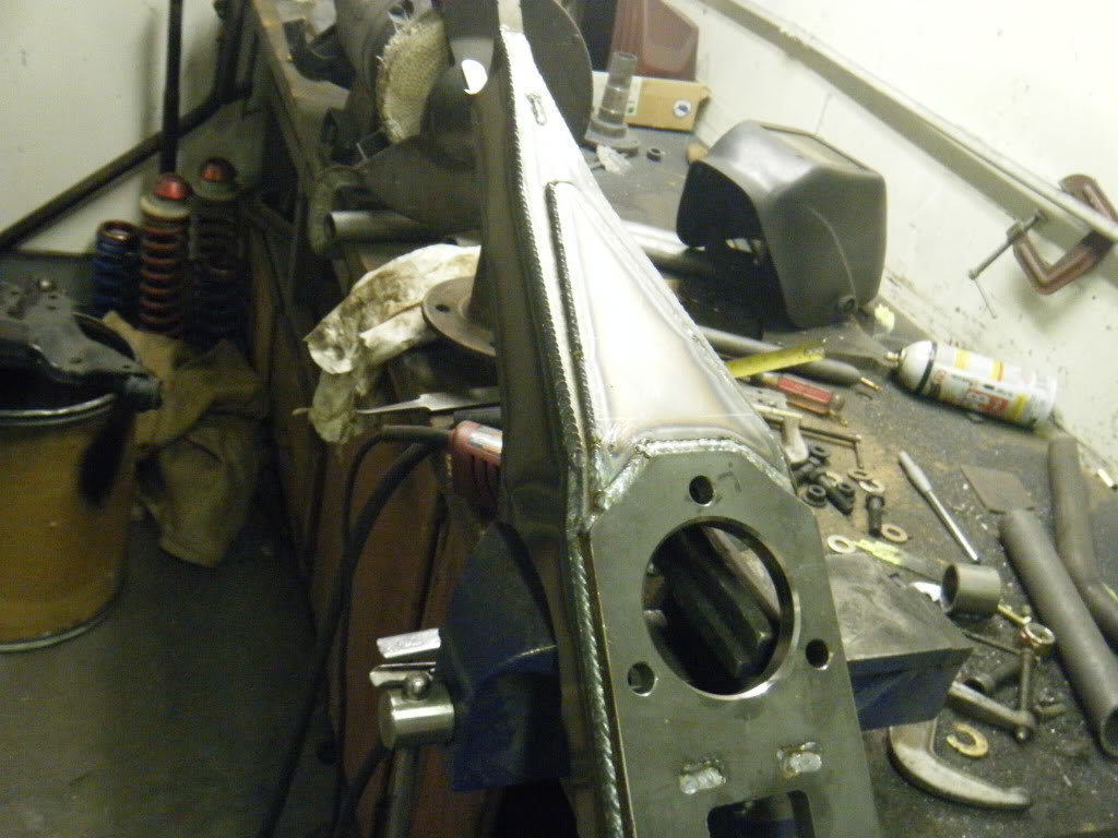

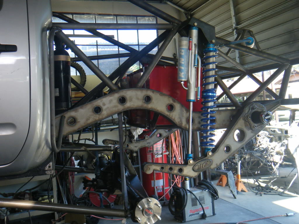

    like so?:D these are from the frontier we're doing right now. just cycled the frontend, it does 16.5" wheel travel until the cv's start binding, so I'm thinking an honest 15" on this particular truck.
    The only "problem" with going this far w/ the frontends is it ramps up the cost significantly. the "arm only" kits are simply easier and faster to make and design, the big boy kits with fabbed spindles and monster uniballs and stuff are around $3500 w/o axles.
