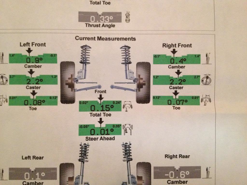

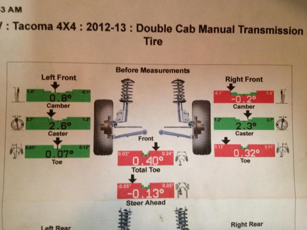

    There's 6200 miles on the truck and tires, this is the 2nd time they were rotated and 1st time an alignment was done.
    Here's the before alignment numbers:
    Here's the after:
    The pull doesn't seem as bad, but the steering wheel cocked to the left when going straight is driving me crazy.
  17. Apr 17, 2014 at 7:41 PM
    #17
    Brodie
    Brodie [OP] Gear Jammer
    Sep 5, 2013
    #111893
    544
    Colorado
    2013 TRD Magnetic Gray Double Cab
    So looks like my caster is emphasizing road crown, which could have me turning the wheel more to the left to keep the car going straight...
    Am I on the right path?
  18. Apr 17, 2014 at 7:42 PM
    #18
    bjmoose
    bjmoose Bullwinkle J. Moose
    Aug 31, 2010
    #42529
    6,009
    Steve
    San Jose CA
    '11 Std Cab 4x4 5sp
    OME suspension, ARB Air Lockers, CBI/Relentless/Pelfrey armor, HAM radio
    If the steering wheel isn't straight when the vehicle's going straight on a flat road - take it back - they need to correct that - it'll lead to unintended and potentially dangerous activation of the VSC (stability control) system.
    Note that cocked steering wheel is a different problem from a 'pull' in which the vehicle refuses to track straight when you're not exerting continuous pressure on the wheel.
  19. Apr 17, 2014 at 8:00 PM
    #19
    Brodie
    Sep 5, 2013
    #111893
    544
    Colorado
    Yes I plan on taking it back just want to attempt to tell them what the settings should be.
    Thanks I do know the difference between the cocked wheel and the perceived pull.
  20. Apr 17, 2014 at 8:23 PM
    #20
    JRFugitt
    JRFugitt Well-Known Member
    Oct 11, 2012
    #88749
    556
    Justin
    Texas
    '13 PreRunner V6
    You are correct Sir!
