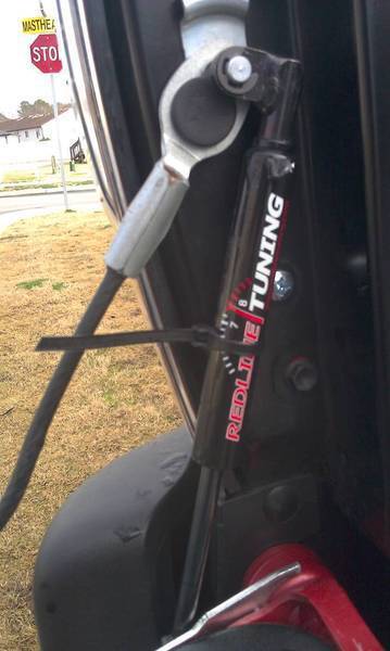

    wow yours lets it down a lot slower than mine does..... and i have to place the cable out of the way each time i shut the tailgate. but i am still very pleased dont really think you can screw up the install it either goes on or it doesnt so i really dont think i did anything wrong.

    my08yoyo,
    If you put a zip tie or lock tie around the main body of the cylinder with the extra length of the tie out, it can direct the tailgate cable to stay to the outside when you try and close it. I have one of these ez downs too, and went through the same thng you did.

    I'm having the same problem. Can you post a pic?
    Also it was about 30 degrees outside when I took that video. I assume with warmer weather it will be faster and also once it's been used a few times it should loosen up.

    yeah if you could post a pic that would be really nice, im kind of confused about what you mean.

    Any pics for the dealing with the cable getting pinched when you close it. I think I have an idea on what you mean by placing it on there to guide it, but don't wanna waste zip ties, lol

    I think they mean this.
