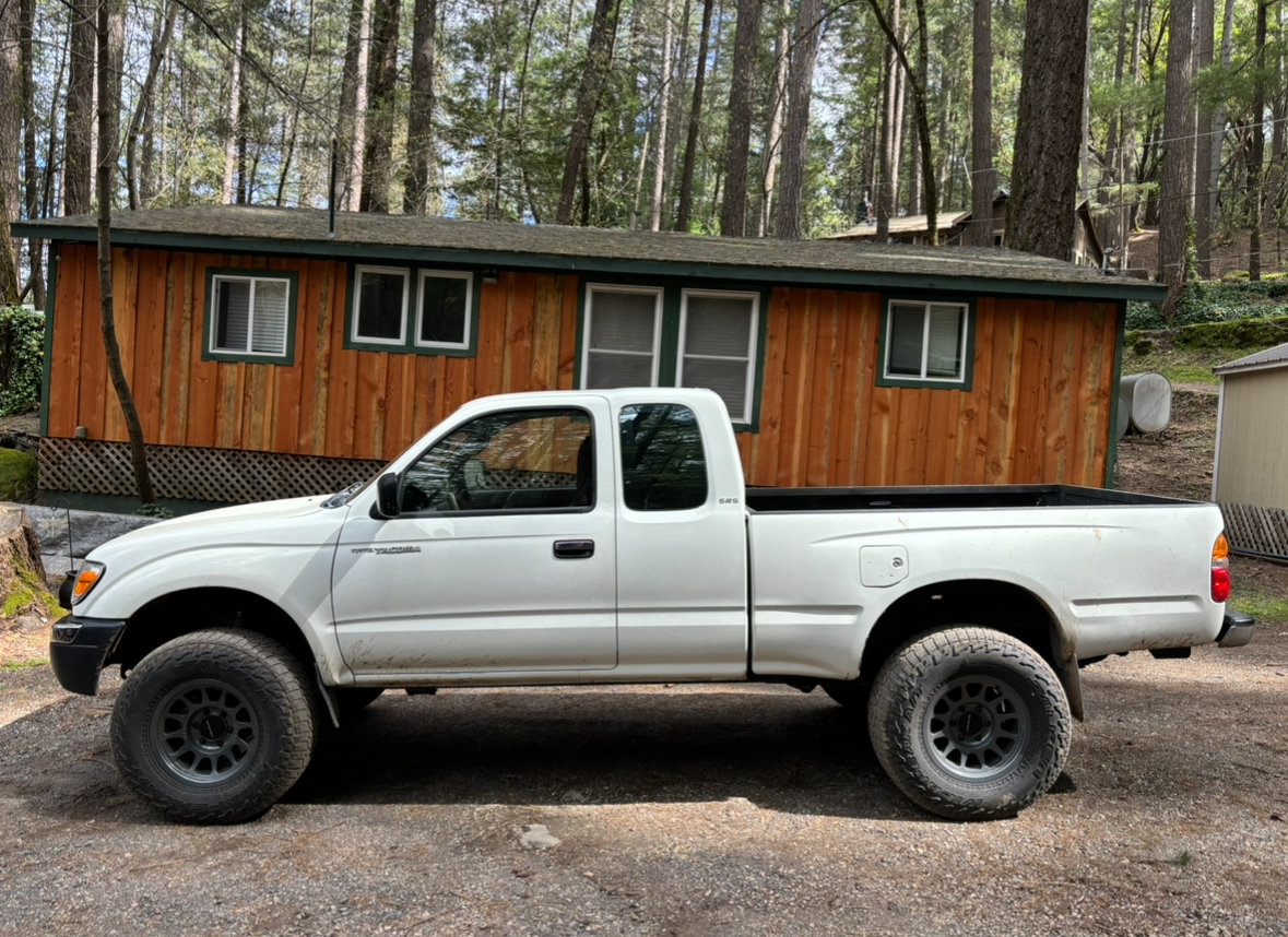

    Hey y’all, I’ve been having some trouble shifting into first gear in my 1998 Tacoma 3.4 4x4.
    So, when I come to a complete stop like at a red light and then go to shift into first it is quite difficult to put it in gear, really have to force it. Other times in the same scenario, it shifts into first like butter. I have adjusted the clutch pedal, replaced oil with Redline MT90(seemed to help a little), replaced slave cylinder, had new OEM clutch installed & the transmission rebuilt roughly a year and a half ago. Replaced the shifter seat and bushing. And this problem still occurs. It’s really frustrating. The only thing that seems to be left is the synchros. Maybe the master cylinder but I’ve tried double clutching and that doesn’t seem to help. Have you had any experience with this problem? What was your solution?
    Thanks
    -Kyle
