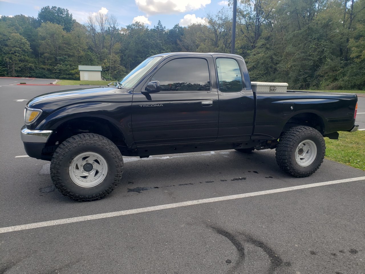

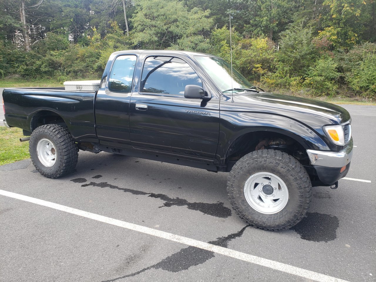

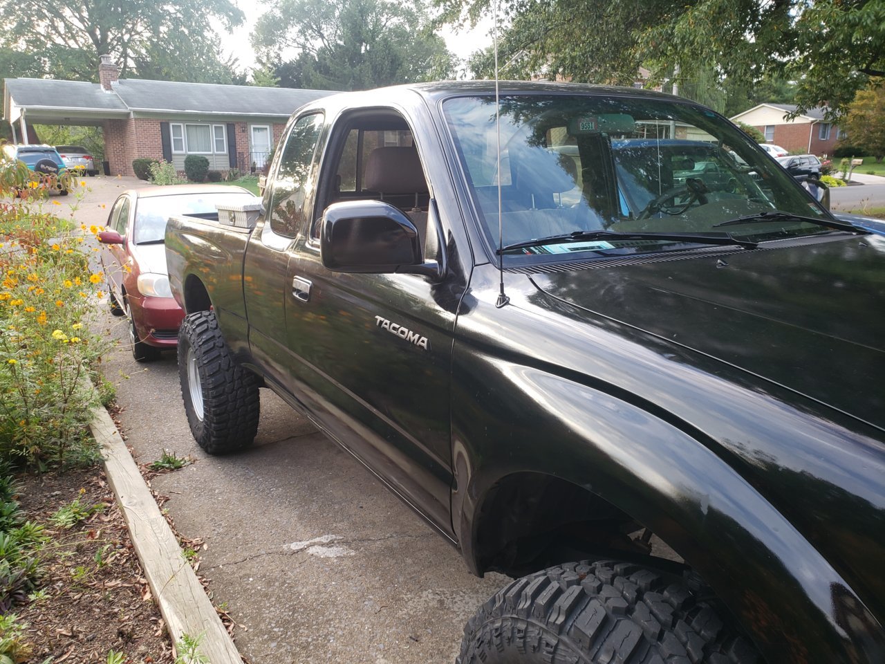

    My truck came with 15s and 33s. I bought 32x11.50r15 for it and haven't really lost power. The wheels on it are 15x10s. To clear the front calipers the previous owner had ghetto rigged it by putting some washers on the studs before mounting the tires. I didn't think it was a bad idea so I got thicker washers and put them on there. Haven't had a problem with them yet lol

    You wouldn't lose "power" (acceleration actually) by going to a smaller tire diameter.
    Did you get longer wheel studs at least? Regardless, using washers is a dangerous way to space out wheels. The fact that you know it was "ghetto rigged" and then made it worse by adding thicker washers scares me.
    Invest in some proper wheel spacers please!

    Well No shit...I was merely answering the guys question about losing power with 32s...
    The Previous owner already installed longer studs so I saw no reason not to add thicker washers. Plus I keep em torqued every 2 to 3 weeks. I'm not much of a fan of spacers, plus I'm already on 15x10s, I don't want anymore offset.
