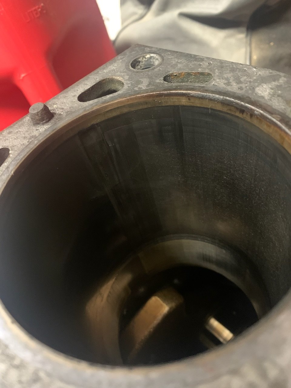

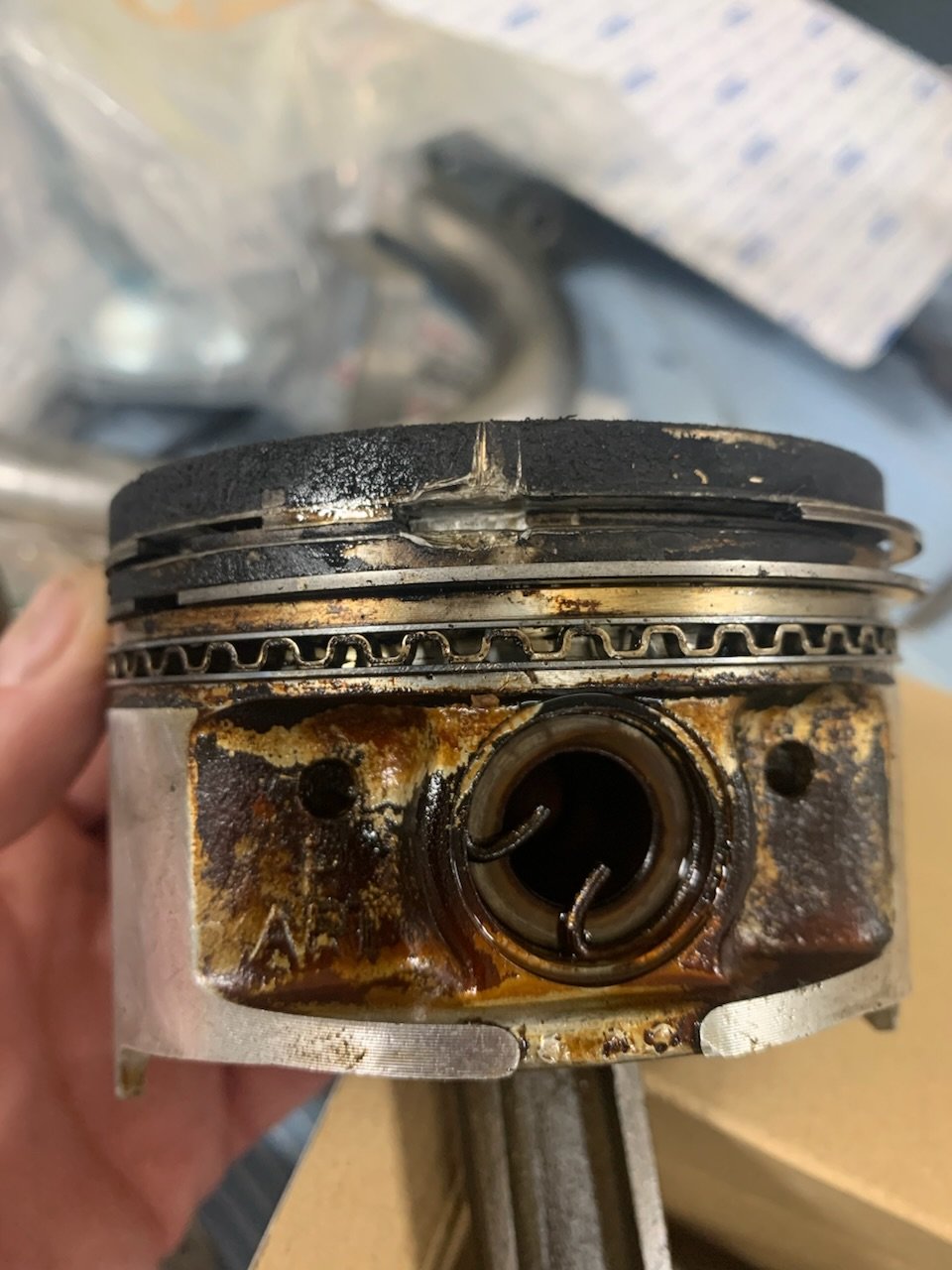

    I change my 1st Gen Tundra oil at 10k, but I drive it about 40k a year.
    I’ve been reading about buildup on the rings from lack of oil changes. I’m running Mobil 1 from Costco cause it’s cheap. Maybe I’ll try oil analysis to see where I’m at. Tundra is at 315k right now.
    A buddy I know just snapped a ring in his 88’ 22RE at 450k. He bought it new and over maintained it, ran like a champ, so he’s pretty bummed.

    That seems like a lot of carbon for being 'over maintained'.
