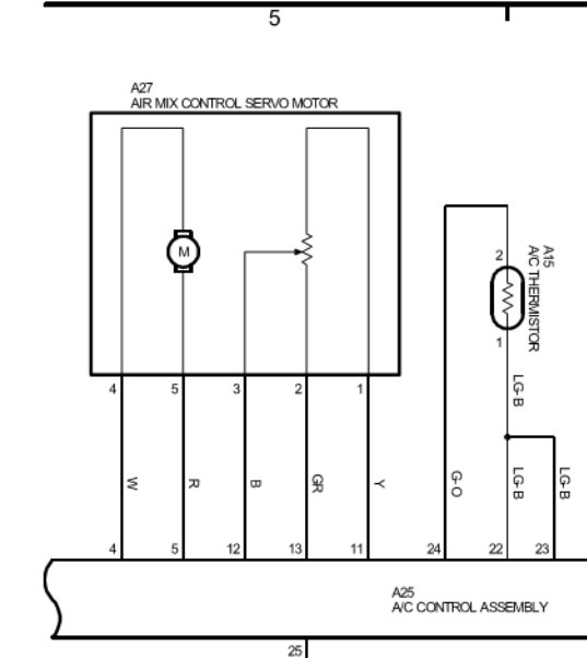

    As far as I can tell, the Air Mix control is operated off of resistance at the dial.
    A pure guess here, but I'm betting the dial is loosing connection and defaults to heat.
    Heat is usually the default setting. You have to have heat. You don't have to have AC.
    There Air Mix servo could also be going bad. My manual doesn't have diagnostics on it. (testing) Maybe @Dm93 knows the procedure.

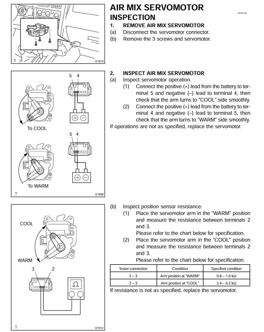

    Took me a bit of digging. But I found the test procedures.
    As expected, the dial is resistance based. Toyota has you check it by voltage.
    Next, See where the Air Mix arm is when this happens

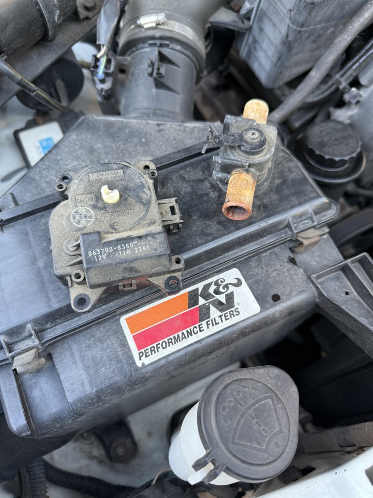

    Just changed my broken air mix servo and heater control valve. Valve wasn’t closing all the way so hoping that ‘may’ have been why my ac wasn’t blowing super cold. Anyway, here’s a great YouTube video for the servo removal and testing. A lot of detail.

    I think don’t know that the servo just controls the heater control valve. My compressor works fine and was topped off w Freon. But if hot water is flowing through the heater core via the bad valve it’s my guess/hope that was why my ac wasn’t blowing super cold. But it’s only in the 60’s so won’t know til summer.
