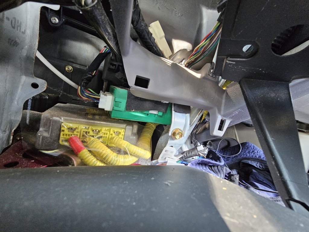

    I installed a new(ish) HU years ago in my 2004 Tacoma Double Cab. Everything worked great. A few weeks ago I installed 4 new Infinity speakers and they were working perfectly up until a few days ago. I tried a CD, Radio, and BT... nothing worked. I removed the HU and doubled checked my connections and they were good. I checked the continuity using a multimeter on the speakers and they were fine. I reinstalled and still nothing. I removed the HU and cut the front passenger side speaker wires and ran them direct from the HU to a speaker I had laying around and I was able to get sound from it. I saw in the tundra forums that 1st gen Tundras had a factory amplifier installed, sometimes tucked away in the dash. Does the 2004 Tacoma have one too? Something is causing an issue between the speaker and the HU and I am not sure what it is. Any advice?
    I attached a picture of two things tucked behind the dash. I have no idea what they are (computers maybe?), but I figured it wouldn't hurt to show them just in case one is an amp or something like that.

    No, these don't have factory amps.
