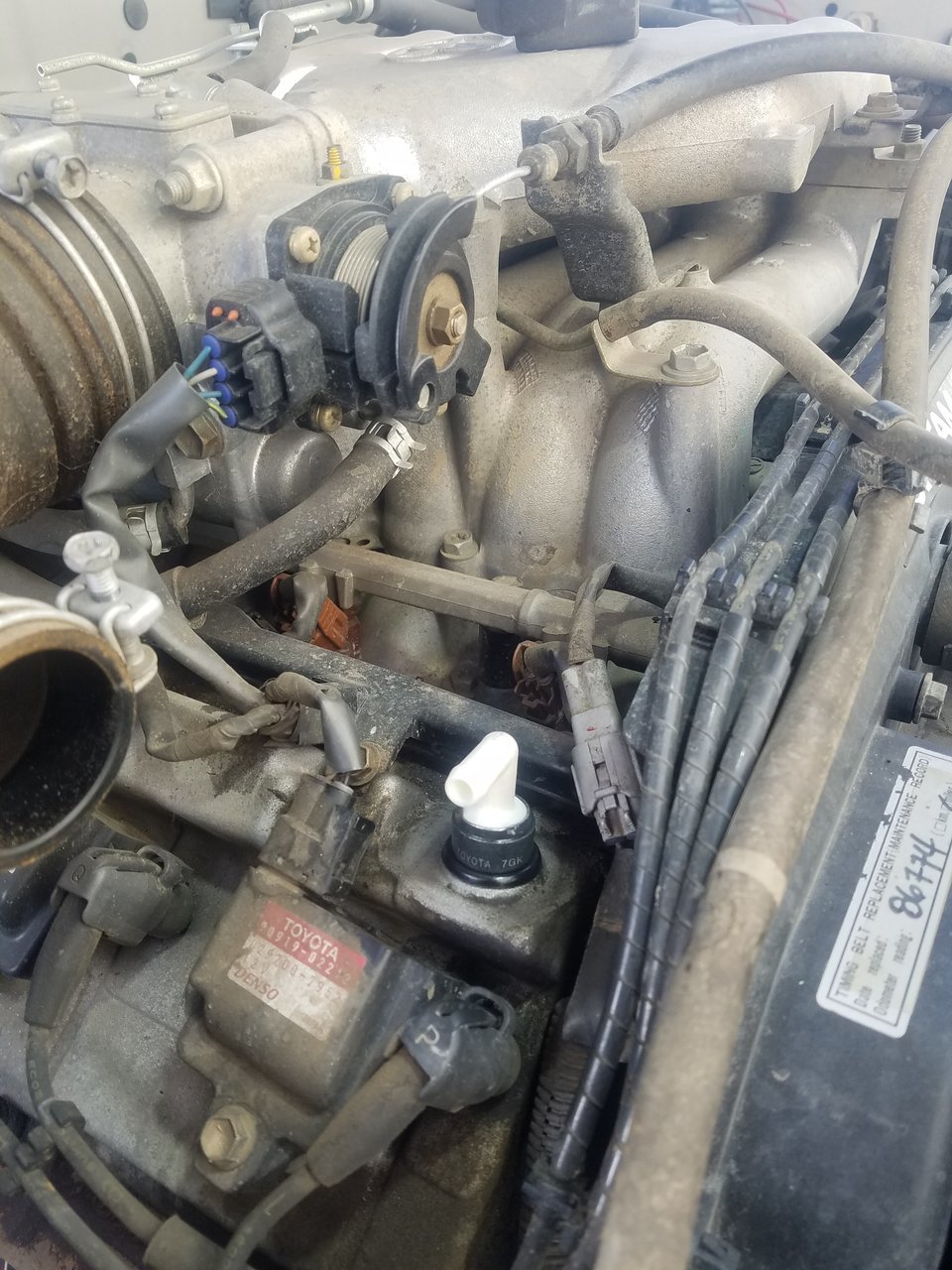

    The tube that comes from the block and goes into the intake plenum is the one you want to remove. (purple plug is the positive crankcase valve)

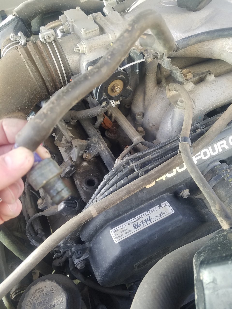

    removed

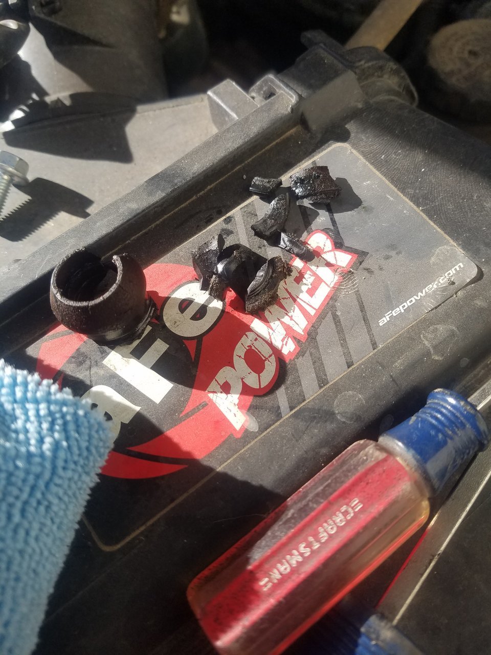

    I got another PCV and rubber bushing from Toyota for about $20. the old grommet was dry and cracked so be careful when removing.

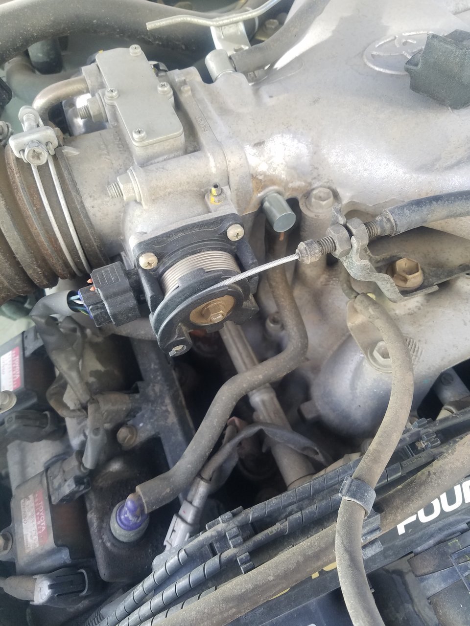

    next was simple, insert the new rubber grommet and PCV.
    Fine a place to mount the catch can, and route the lines. A tube should come from the PCV from the motor, to the inlet of the Catch Can, then the outlet from the can should go to the air intake port where the old tube was removed.
