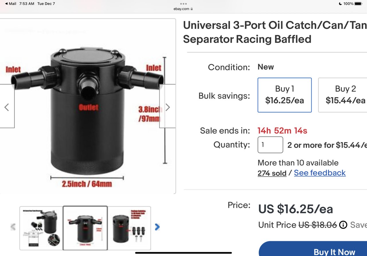

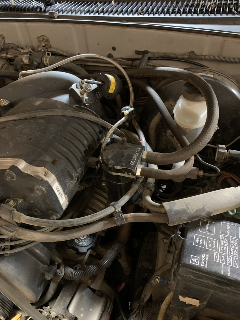

    That's what I ended up changing to not too long ago. 3 port catch can. I originally had it tee'd, but I was getting oil in the other tube that wasn't there before. And I just vent to atmosphere; it's clean enough, and a finger check to feel how much pressure there really is. Great to isolate out the crappy PCV valve too.
    https://www.ebay.com/itm/303877537745

    That actually makes the most sense, didn’t know they made a 3 port CC setup,
    Thanks
