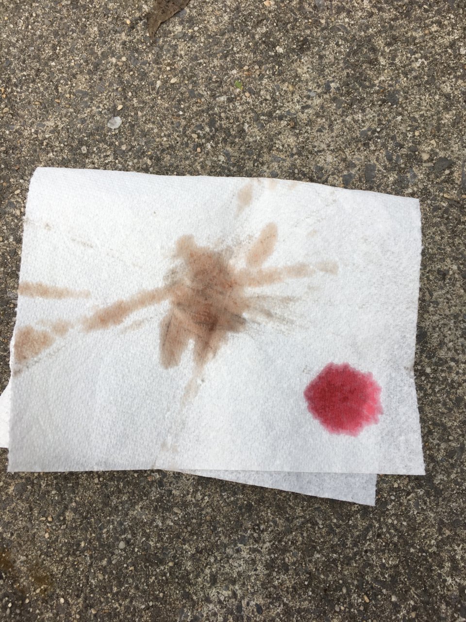

    Hi! Reviving this to get a little info about a simple drain and fill. I’m new here, and my truck is also new to me, so I’m not sure what type of service has been done on the tranny/fluid.
    It currently has TOO MUCH atf in it, so I thought I would just do a simple drain and refill to get some of the old fluid out as well as get the level adjusted correctly. The fluid is not bright pink but not dark either, just a pinkish/light brown.
    My question is this - what do I need for a simple drain/refill, other than ATF?? Do I need a new plug or washers or anything?
    Thanks!

    First off, just to make sure, are you checking the level with the engine running, trans fully warmed up? If you have a scangauge or torque app, trans temp should be at least 150-175F. Also shift it through all the gears right before you check, otherwise the level will read high on the dipstick.
    If the fluid is at all brown, it hasn’t been changed in a while (hydraulic oil absorbs water out of the air, which makes it eventually turn brown - not what you want running through your trans). I reuse the washer on the drain bolt, it’s never leaked. If yours weeps fluid, it might be worth replacing. Otherwise, all you need is 5 quarts of ATF - recommend Valvoline Maxlife.
    You might need to do a couple drain and fills to replace enough fluid to get that old stuff out, a couple weeks apart.

    Ok, so I initially check the ATF with the engine cold. That's when I saw that it seemed WAY to full - the dipstick with engine cold showed the level above both the cold AND the hot marks.
    I checked it again just now, after driving about 80 miles and also running through the gears just before checking the stick again. This time it read just below the HOT mark. For some reason, that is confusing to me. Then again, I don't know a thing about transmissions. Would love help understanding that...
    In any case, I'll do the drain and fill with 4+ quarts bc when I dabbed a little fresh ATF on the paper towel against the old fluid spot from when i checked the ATF, it seems like enough color difference for me to change it out, especially since I don't know the last time it was drained/filled. (Pic included)
    Also, thanks for the info on the bolt/washer. I will try to reuse. Is that washer and bolt best to get OEM from local dealer, in the event I do need to replace them, or is there any other place that might have it?

    The "cold" mark on a transmission dipstick is just used by the factory to make sure they have enough fluid in it so the torque converter isn't damaged when they pull it onto the car trailer - it's not to be used for checking the service level of the fluid. Only use the "hot" markings, when the trans is fully warmed up and shifted through all the gears. Sounds like yours might be a little low, although to be honest there are so many valves and solenoids in the transmission that might be full or not depending on temp, how long it's been running, etc, it's almost impossible to get the same reading one day after the other.
    Definitely looks like yours is in need of a couple drain and fills, that color isn't awful but it's obviously not fresh. I would just get the bolt and washer from a dealer, if there's one near you. Otherwise you can probably order it from Rock Auto or Amazon or similar.
