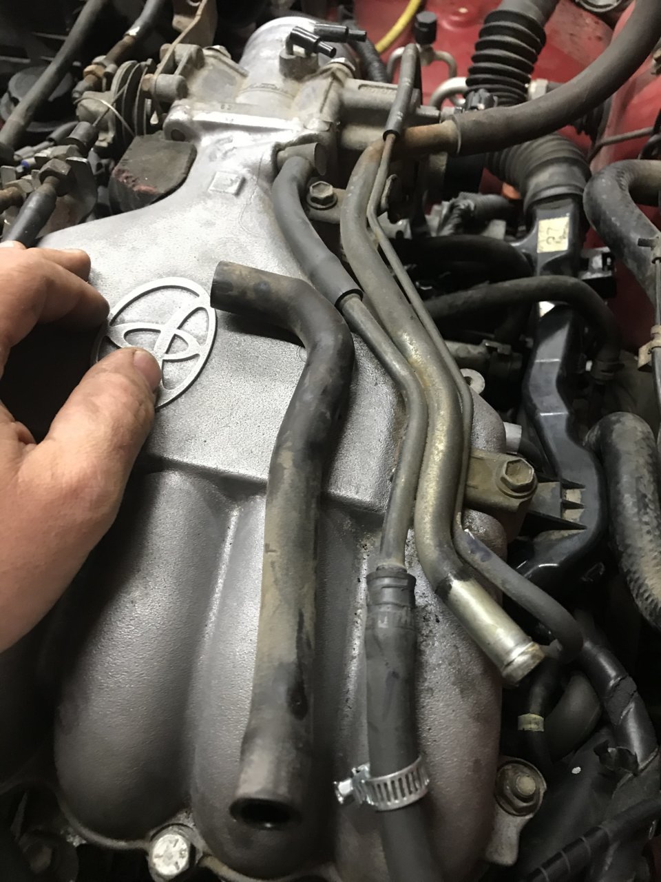

    We replaced gaskets and started reassembling... but we lost a hose on the hat of the intake... way she goes.
    I’m thinking the short elbow section comes off of the throttle body, connects to a second hose that runs into the air charge pipe from the filter.
    Enlighten us, we can’t find a schematic in repair Fms, or forums so far. On week 2, we have put in the work. Just in the wrong places I recon.
    thanks!

    well it says it’s a vent hose, but no diagram to show the lines to or from the connection on the hat. If there is link it please

    @Rusty_Taco
    Look at the end of the blue dashed line in this post.
    https://www.tacomaworld.com/threads/what-the-heck-is-this-thing.687610/#post-24276285
    That rubber hose in your 1st pic goes from the vacant tube to the driver side valve cover.
    90° end on the tube, let the other end hang straight down. Should end up near the valve cover fitting.
    The fitting in your second pic is the "air assist" system supply. A molded hose goes from the fitting to the rear of the engine to a plastic "Y" fitting. Two subsequent hoses then go to fittings on each side of the rear intake manifold.
    Yellow arrow.
  8. Sep 30, 2020 at 2:26 PM

    Fixed!!! Thank you everyone!
