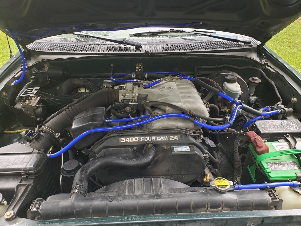

  3. Jul 25, 2023 at 1:33 PM
    #223
    FloridaAKM
    FloridaAKM Well-Known Member
    Aug 25, 2018
    #264015
    51
    Alan
    2004 Green 4WD Tacoma V6 TRD
    LED headlights
    I bought 4 rolls of 10' each of blue 3mm, 4mm, 6mm & 8mm silicone hose. Everything was changed out as recommended except the throttle body hoses as it was stated here not to, they were fine as is. Removing & replacing one line @ a time eliminating my ooops situations.
    The rats/mice had chewed up my windshield washer hoses & so they were replaced with 3mm hoses after all these years of electrical tape repairs. The real headbanger was the ELL connection @ the fender as it went from a clear hose to a larger hose in the fender that my big hands can't get to. After way to long compared to the rest of the installation, the darn new hose finally gave up & went onto ELL & that was the last piece.
    It cost less than $50.00 for all the silicone hose & I have a small amount left for other projects (military trucks) that need a bit of attention to their repairs. The military use blue silicone hoses to do all repairs on their trucks as we taxpayers foot the bill.
    That metal pipe on top of the engine is no longer unconnected. Since I had extra 4mm hose, I connected both ends to each other & ran it along the firewall. It always bothered me & the answer found here showed that it is on all engines of this period, but not used on most.
    Thanks for the info on the sizes & lengths of hoses need to do a 2004 V6 Toyota Tacoma truck. It was a huge help in getting me motivated enough to fix age deteriorated & rat/mice damaged hoses in my truck. On a cooler day, the next project is the sparkplugs & oil/oilfilter change along with the driveline lubrication.

    Looks clean and correct.
    That metal tube you added a loop for is pretty easy to cut off for a cleaner look if it bothers you like it did me.
