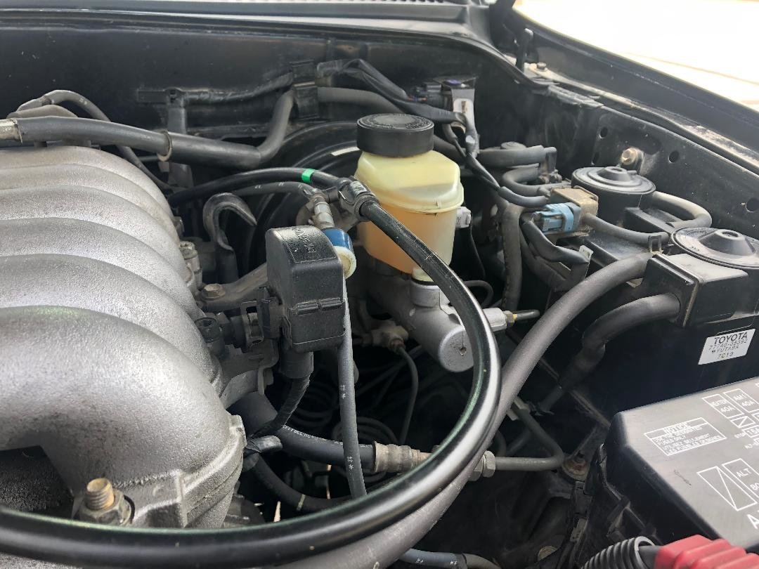

    Did this on mine with the siliconeintakes kit plus some extra hose. I still have a bunch of extra left over which has come in handy since there are some hoses that you can't access unless you pull the intake off. Since I am doing the valve cover gaskets, I've been able to replace those hoses as well.
    I use black hose so it doesn't really show well in the pic for what was changed.
    But this was the pile of old hoses that were swapped out. Gives you a little bit of a better idea.

    what's the story with the 'greenish' looking brake fluid?

    It's a new reservoir. The tint of the plastic makes it look like that.

    that is pretty cool! is it aftermarket part?

    Autozone replacement master cylinder with reservoir. Factory new would look the same.

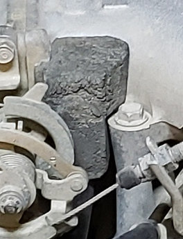

    @xtremewlr is it ok to crop your picture?
    does anybody know how to get this rubber piece (or what it is) is it replaceable (easily) from the pcv hosing?
    mine is getting weather worn and I suppose a new one looks better (nice and black)
    and maybe this has potential to get leaky :notsure:

    That's just a foam cover for the PCV port on the upper plenum of the intake. It wouldn't leak itself. You can order a replacement from Toyota if you want. It just slides into place. Pull straight up and it will slide off.
