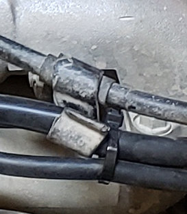

    incompetent me should not be messing with this simple of stuff :facepalm:
    the bags were not marked particular size, i just grabbed what I thought was the biggest hose

    alright, stupid hose ?? here
    I was curious if anyone knows if a new OEM rubber hose would come form fitted or straight and bendable like the silicone
    I replaced one yesterday that was curvy S shaped and had to bend the new one to fit
    was the original rubber hose straight to begin with and then just held and 'froze' its shape over 2 decades of not moving?

    this one was a very tight pinch after redoing with the proper sized hose :facepalm:
    i suppose spraying wd40 on the new hose would've made it slicker and easier to slide into there
    the other hose under there must be specific to what you got going on inside, because I don't think I have another hose tie-wrapped to mine here

    Hey Jay, they come form fitted. I've replaced a couple of them with OEM parts, and they came preformed.

    thanks,
    It seemed like the silicone one easily bent into shape but just was not sure if its gonna stay put!
