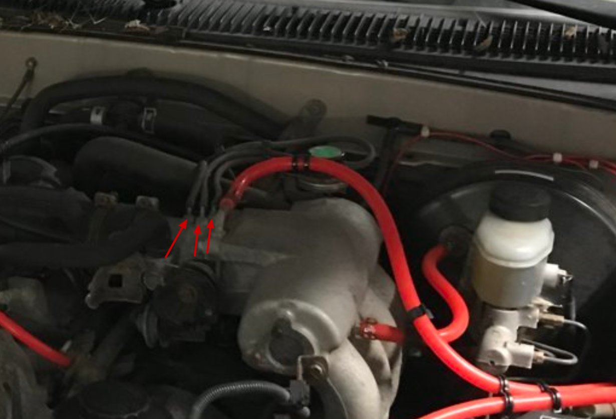

    This is fantastic, thank you. I'd admit I don't know a whole lot about the vacuum system, but there are lot of little hoses that I thought were part of it. I put 3 arrows on the main examples I'm thinking of. I have a bunch of hoses on the black box on the right that aren't on Liam's truck above.

    Yeah those three little ones you pointed too are vacuum lines that control stuff with the throttle body. I tried replacing them with the 4mm hose but it was too loose and slipped right off. Would’ve needed a 3mm hose or so for it to stay on without a hose clamp. So I just decided not to mess with it. As for the stuff on the right side behind the fuse box, those are all the vacuum switching valves and I cut the mount for my one and moved it so there’s a couple more short hoses that are hidden behind that fuse box and under my aux fuse panel. If that makes sense?
    there’s a sticker on the hood that outlines the major vacuum lines, those are the ones that you should replace. I think the only additional one I replaced was the one from the throttle body to the brake booster.

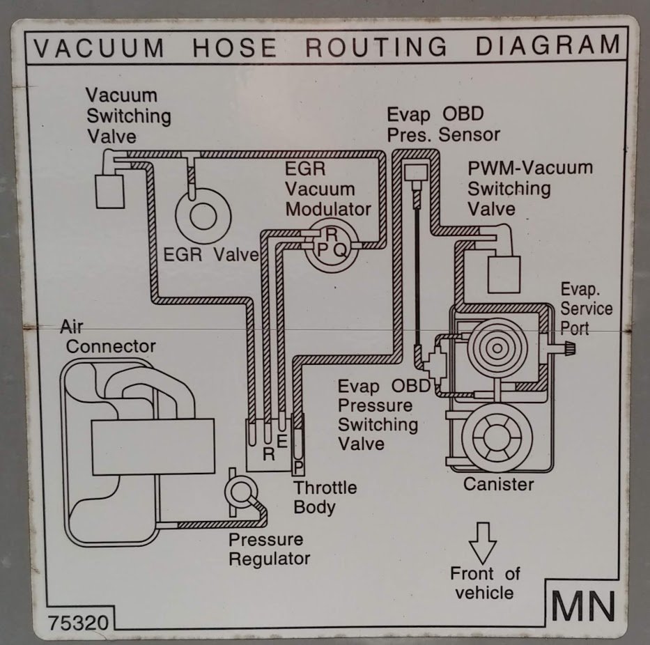

    Here's the sticker for my 2.7L, which shows those 3 little hoses. Thanks to your efforts, I'll know to look for 3mm hose!

    Oh I see yours is a 2000 so the evap stuff was different in the transition year. Just try to replace everything on that diagram, but yours might be a little different than mine. Try to measure the inner diameters of some of those hoses by the canister before you order stuff. Also measure the sizes of the fittings. You’re gonna want the hoses to be a bit smaller than the fittings so they fit well.
