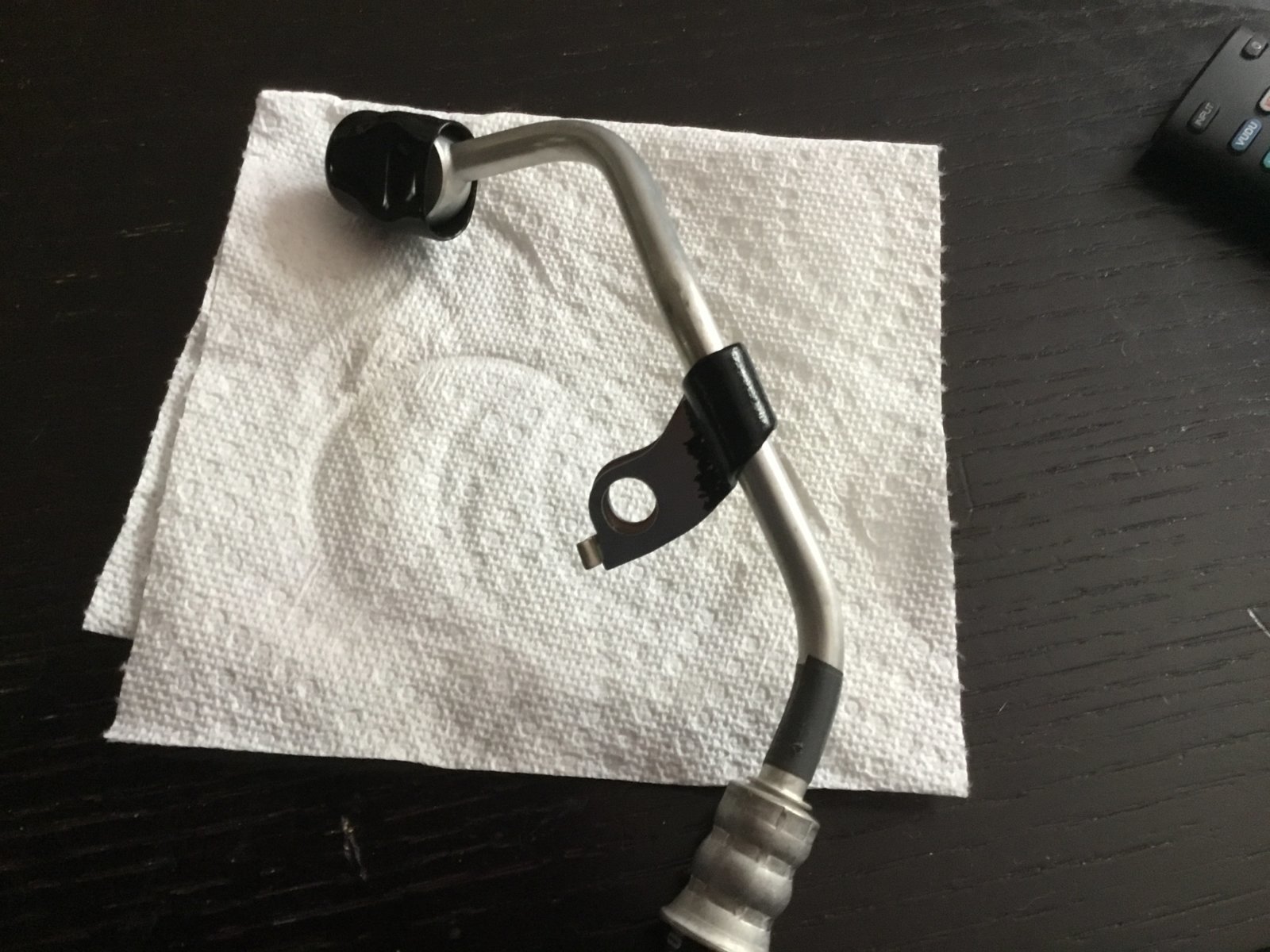

    Yes, that end…but on the line there is a small bracket that is somehow connected to the engine.
    I don’t know how or where it connects (can’t see it ) to the engine about 6” from the banjo bolt.
  4. Dec 23, 2023 at 12:23 PM
    Buster1941
    Buster1941 [OP] Member
    Dec 18, 2023
    #439809
    5
    2002 Toyota tacoma 3.4l
  5. Dec 23, 2023 at 1:45 PM
    02hilux
    02hilux What do you mean there’s no road, I’m here
    Sep 14, 2016
    #197244
    6,350
    Planet: EARTH
    10mm head
    Bolted to the intake manifold IIRC. Tight squeeze to access.

    Ok, I get it - the right fuel regulator mounting bolts. Thank you very much. It’s crazy
    because you can not see any of this!

    Clean your pinkies real good, place the tube as close to its connection as you can, and then feel around the back of the intake manifold for the hole. A flashlight and a small mirror might help you see the hole.
    (You might put a little hair around that area to help get the bolt started :devil:)
