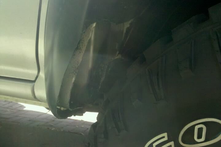

    Need measurements from the ground to the front fender (centered thru the axle)
    and from the center cap to the fender.
    3 inch lifts and 33" tires only please. 1st gens.
    I am having some rubbing issues when I hard left into my driveway. Tire is hitting the rear of the front fender.
    I am running OME 881's with a .5 spacer and stock tokico shocks.
    Measurements are:
    24" from the center of the center cap to the fender.
    39 1/4 from the ground to the fender strait lined thru the center cap.
    Thanks.

    Appreciate it. Mine are actually metric 285/75/16 so I'm not sure what the exact height is. If you measure from the center of the center cap it shouldn't matter whether you have 28's or 44's, as long as you just have a 3inch lift.
    I'm thinking i'm lacking an inch or so and thats why it's rubbing so bad. I just want to make sure there are others that have 24inches or better from the center of the axle up to the fender so I can decide on 5100's without any alignment problems. Preferably prerunners.

    Yeah i had the same problem your having. I was rubbing bad if i hit a bump wile turning and I have 3 1/4" in the front I was 38 1/4 from the ground with the stock tires i haven't checked with the 33's. i did however take of my rubbing issues :D
    I went wheelin two weeks ago and didn't rub once. I'm buying Bushwacker Cut Outs soon so i cut the fenders to spec to install the flares. You can't even tell there cut until you really look.

    Wow. You hacked that pretty good!! I dont have fender flares on mine anymore. I like the look with them off. So I take it your not rubbing at all anymore? Also are you rubbing the frame at full lock left forward and left reverse? It doesnt do it at all full right forward or reverse. Just full left in both directions.

    Thx Steve O.
    I think some spacers will alleviate the rub I have on the frame but I really dont want to have my tires stick out any further since I am not running fender flares anymore.
    As far as the rear of my front fender hitting the tire on curbs...I'm not sure what I can do about this. I dont want to cut my fender any. Wondering if some billies will give me an extra inch?

    Did you pound and grind the pinchweld a little? I had to do that.

    I need an extra 1-2 inches and just not quite sure how to get it. Really dont want to body lift it. If they made bushwackers for the DC, I would go that route.

    Yea. The guys at the tire shop were kind enough to do that when I had the tires put on. Removed my mudflaps, trimmed the plastic and mammered the pinch weld.
