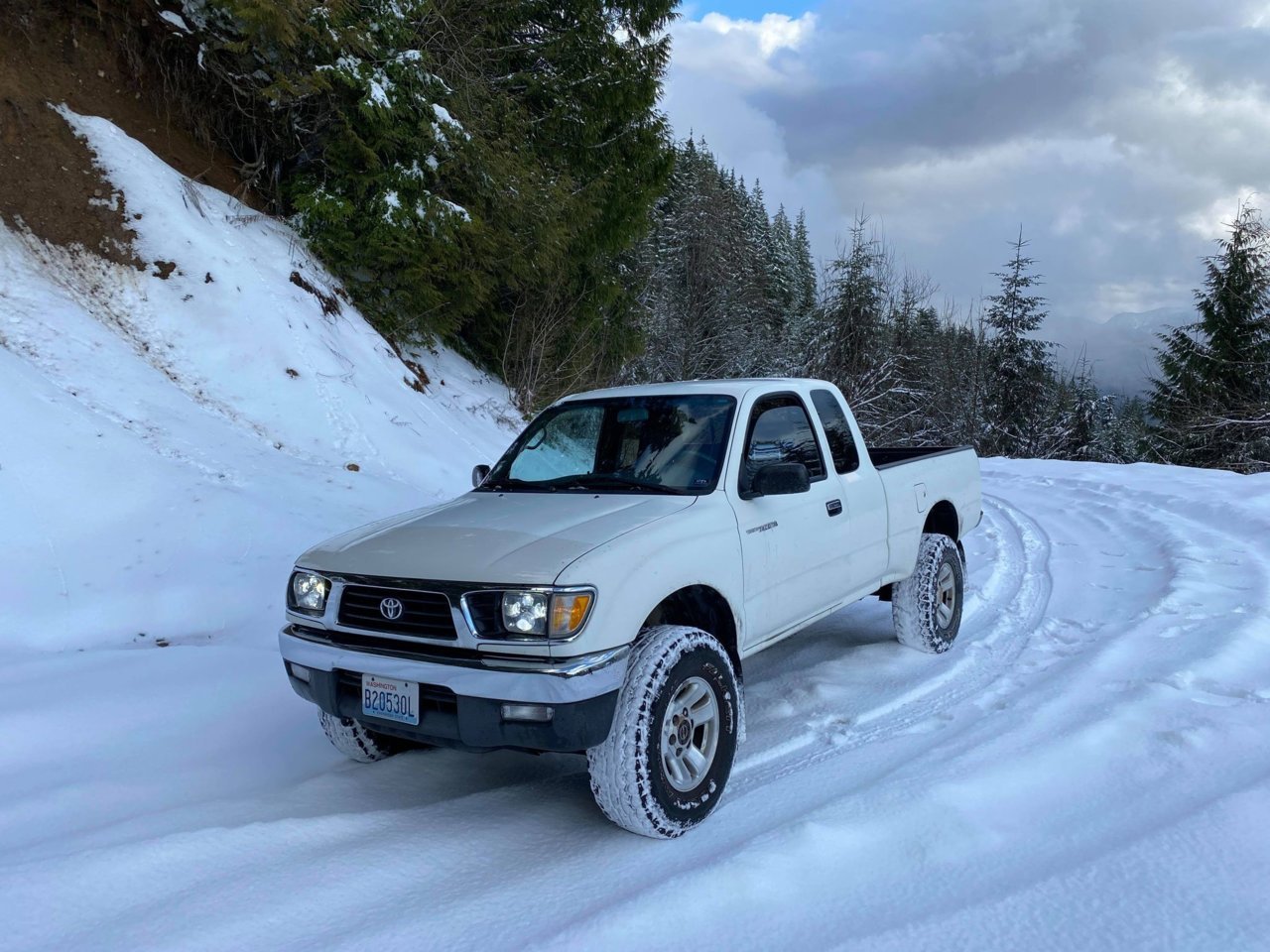

    Hey guys. New dude here. Picked up 96 Xcab 2.7 4x4 Auto my my dad after he had it for past 13 years. Looking to get some lift.
    Is there big ride difference between OME Struts vs 5100 if using them with 880 and Icon 1.5 AAL? ..... and I assume to go with 880 vs 881 even with Xcab 2.7l ?
    Currently on 31 inch Falkens but they will need to be upgraded soon due to age/cracking.
