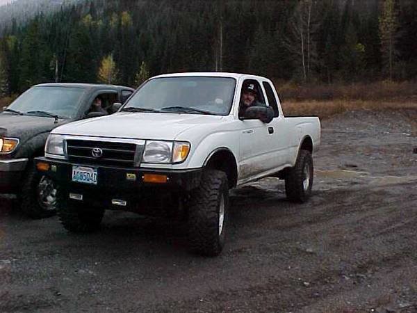

    I ran those wheels on my '98. They will fit fine on your '97 and look good.

    Awesome guys! Thanks for the replies!
    Digiratus what tires were you running in the pic?

    Those were the original BFG Mud Terrains. What folks nowadays refer to as KM1s. The size was 32x11.5r15s
