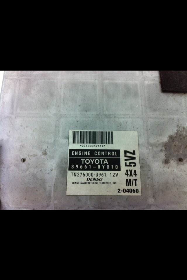

    I have the same exact Tacoma as yours and I did my swap 2 years ago and still running perfecy with no issues.. All the components bolt right up just like stock (Transmision, Clutch, etc) You can use your stock Harness and Auto Ecu but you'll end up throwing codes for the missing solenoids that the stock auto Ecu will be checking for once you turn the key, it will drive just fine with those codes.. You'll have to drill into the firewall to mount the clutch master cylinder and clutch pedal... There's not alot of wiring involved with the swap just a few to wire up the reverse lights and a few to depin when you do find a manual Ecu just to make sure you won't fry the Ecu from any type of feedback.. You'll also have to make sure the intermidiate rear driveshaft is 31" from flange to flange as for mines my tacoma was a prerunner when I bought it brandnew and now it's 4x4 5speed after the swap.. You'll throw no CEL once you get the manual Ecu which I'm currently been running for over a year and my tacoma is my daily so I racked up quite a few miles and have had no problems.. Any questions feel free to PM me or post on here and I'll be glad to assist you if you have anymore question... But I'll upload some files that will help you.. So on the Ecu file all the N/a gets depinned but you can leave the pins in if your Going to use your auto Ecu but if u run the manual ecu I highly recommend depinning the wires just to make sure nothing gets fryed... And I've uploaded a pic of the Ecu withvthe part number , this will only work in the 2003 models only and nothing else..
