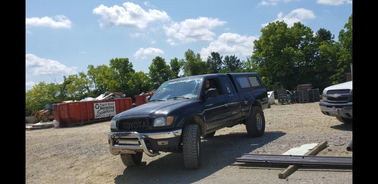

    I wanna do the 63 swap on my 01 and I got some questions.
    1. What is the most complete kit for doing this swap
    2. I saw on the 2nd gen write up to use 12" shocks...is it the same for 1st gen
    3. I was thinking of moving the shocks inward a bit to achieve more flex with less shock travel.. thought on this idea
    4. Is this something that can be done in a weekend I daily my tacoma and will need it ready to go Monday lol
    I'm sure I'll come up with more questions as this goes on thanks and have a good one

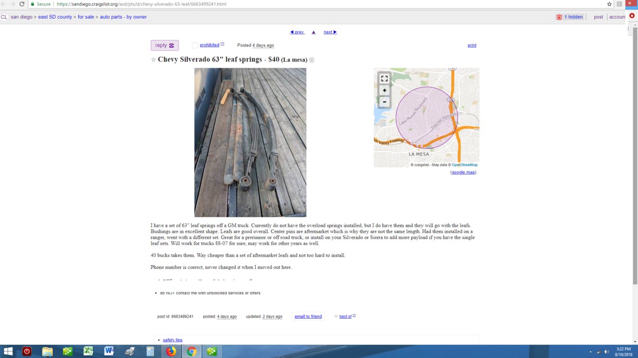

    The point of a chevy 63 swap is that you are building a suspension with cheap junkyard parts. Buying new springs defeats the purpose.

    Keep an eye out on parts. They come up cheap. Make take a couple months but you'll save hundreds.
