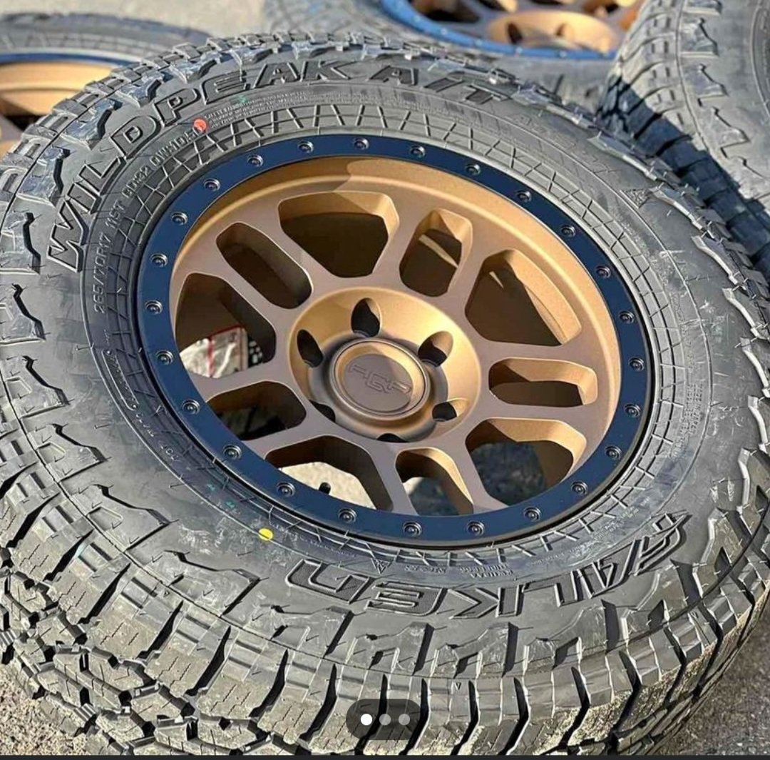

    Looking at going from my current set up (American racing AR172's 16x8 with 0 offset and 265/75/16 Falken Wildpeaks) to AGP Trux 17x9 wheels with 285/70/17 Falken Wildpeaks and for this particular wheel there is a +1 or -12 offset to choose from.
    Working the calculator it looks like the wheel/ tire would be more centered on the
    +1 offset (0.44" inner side wall closer to frame/ suspension and 0.36" more poke out)
    While with the -12 it looks like all the width added from the 285 (0.8") would poke out
    -12 offset (0.07 inner sidewall further from frame/ suspension and 0.87" poke out)
    More concerned with proper/best fit vs looks...
    Anyone run these wheels on a 1st gen? suggestions?
    Thanks!
