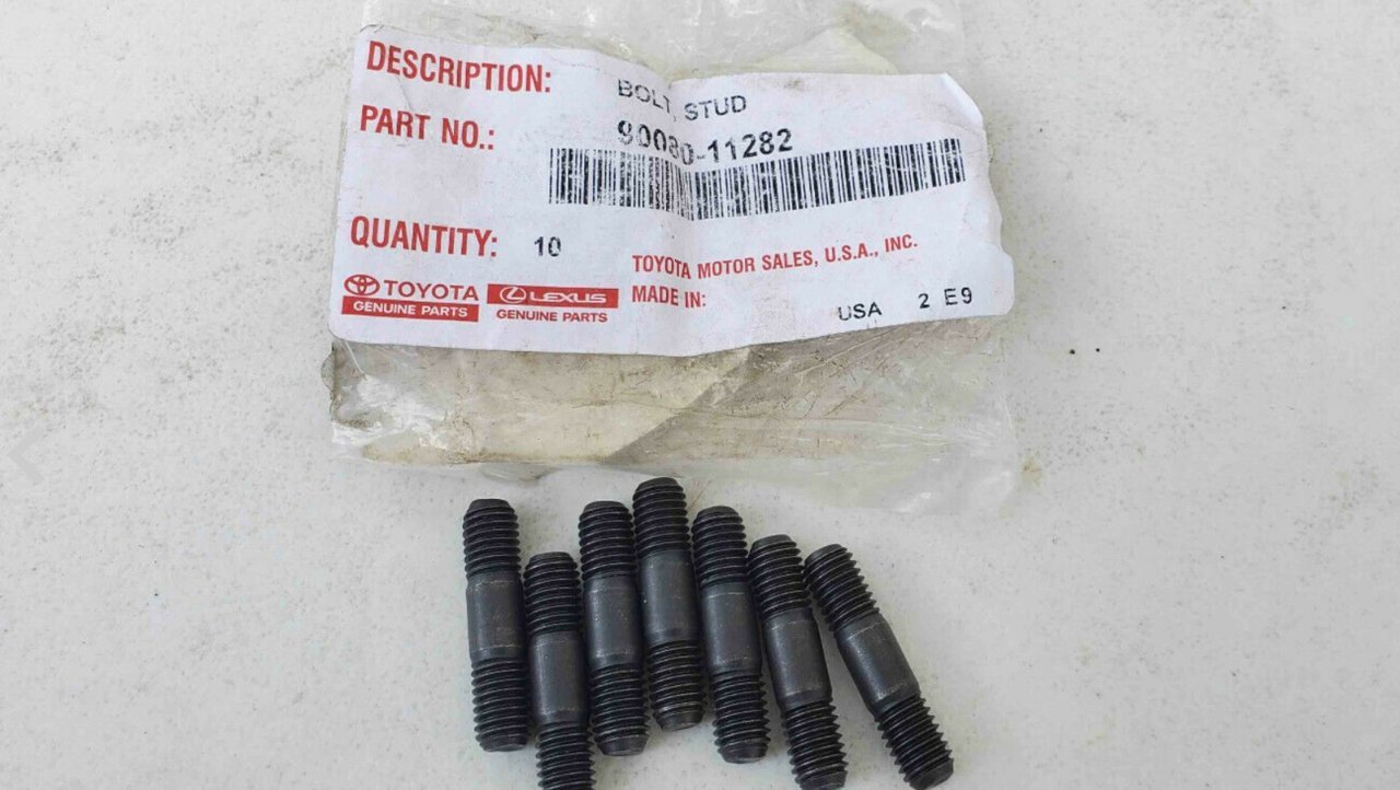

    IMG_1092.PNG.jpg Anybody know where to source some of these?
    I need all the hub mounting hardware.
    Studs, cone washers, lock washers, and nuts.
    Thanks.

    Studs, lock washers, and nuts can be had at most auto parts stores or an Ace Hardware. The cone washers are a smidge hard to come by and are relatively expensive.

    you might get the cone washers from someone parting out if you don`t want to go new from your dealer.

    Well, you can buy the stud, washer, cone washers, and nuts individually from marlin for an additional cost.
    In my case I did not need to replace all 12, just a handful that had messed up threads.

    Make sure they’re grade 10.9 = roughly to Grade 8 SAE fastener strength

    My suggestion would be the following, any Toyota dealer should be able to order them for you:
    90116-08171 - Stud (Qty: 12) (Alternate: 90116-08325, slightly longer)
    42323-60010 - Washer, Cone (Qty: 12)
    90201-08042 - Washer, Flat (Qty: 12)
    90170-08036 - Nut, Hex (Qty: 12)
