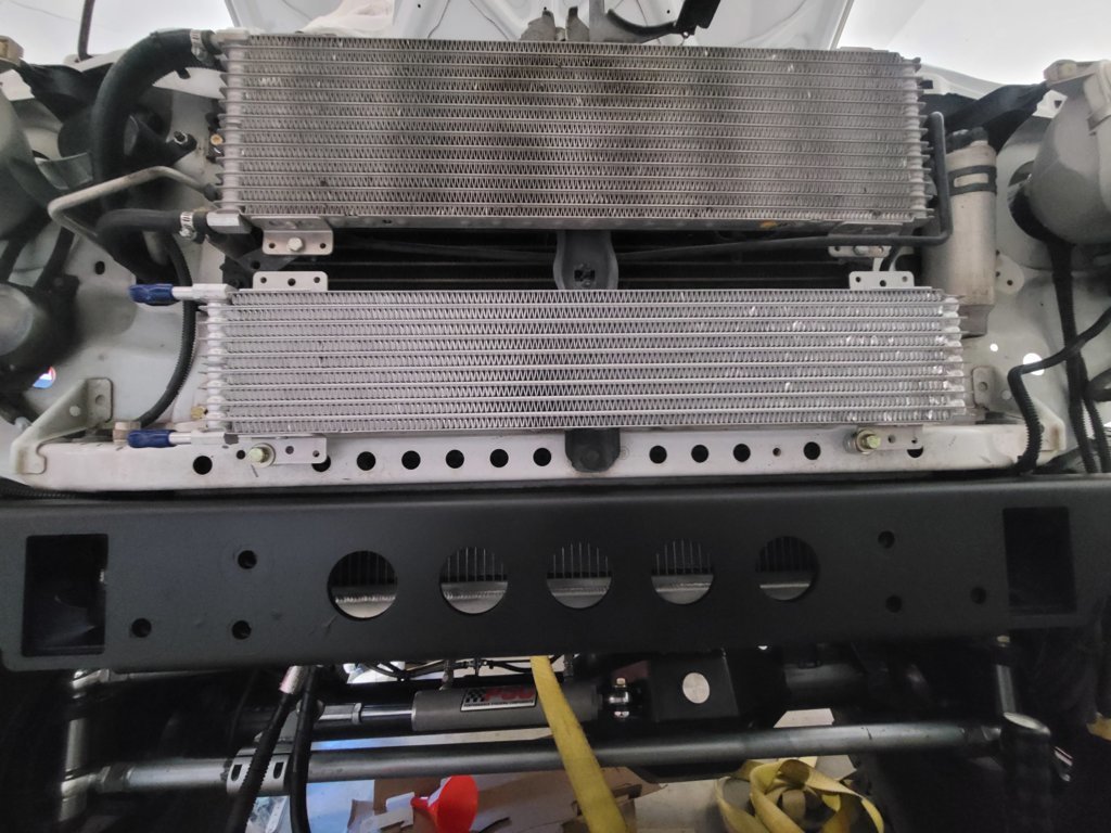

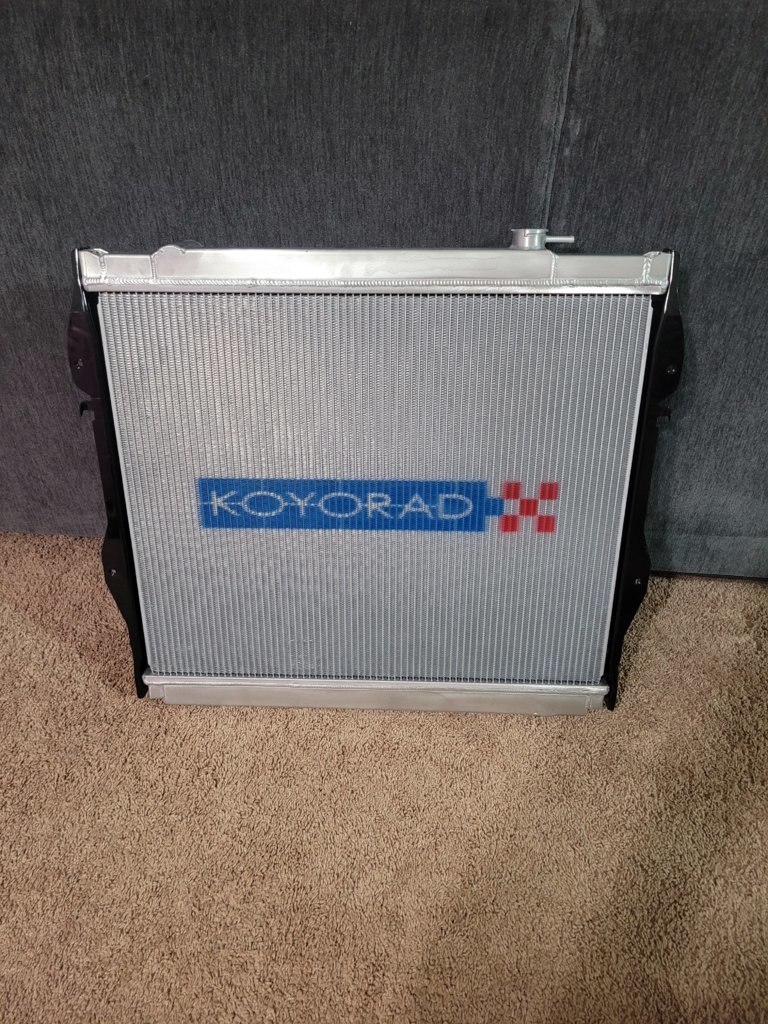

    I’m auto v6.
    I replaced the Denso 221-3136 with the Koyo and they both have near identical measurements, though I didn’t measure the koyo, here’s the measurement for the Denso. The Koyo hangs about 1.5” below the frame. The koyo core is 1.75” thick, 2 row.
    Denso
    Dimensions - Core Height: 20.6250 Dimensions - Core Thickness: 1.250 Dimensions - Core Width: 24.6250

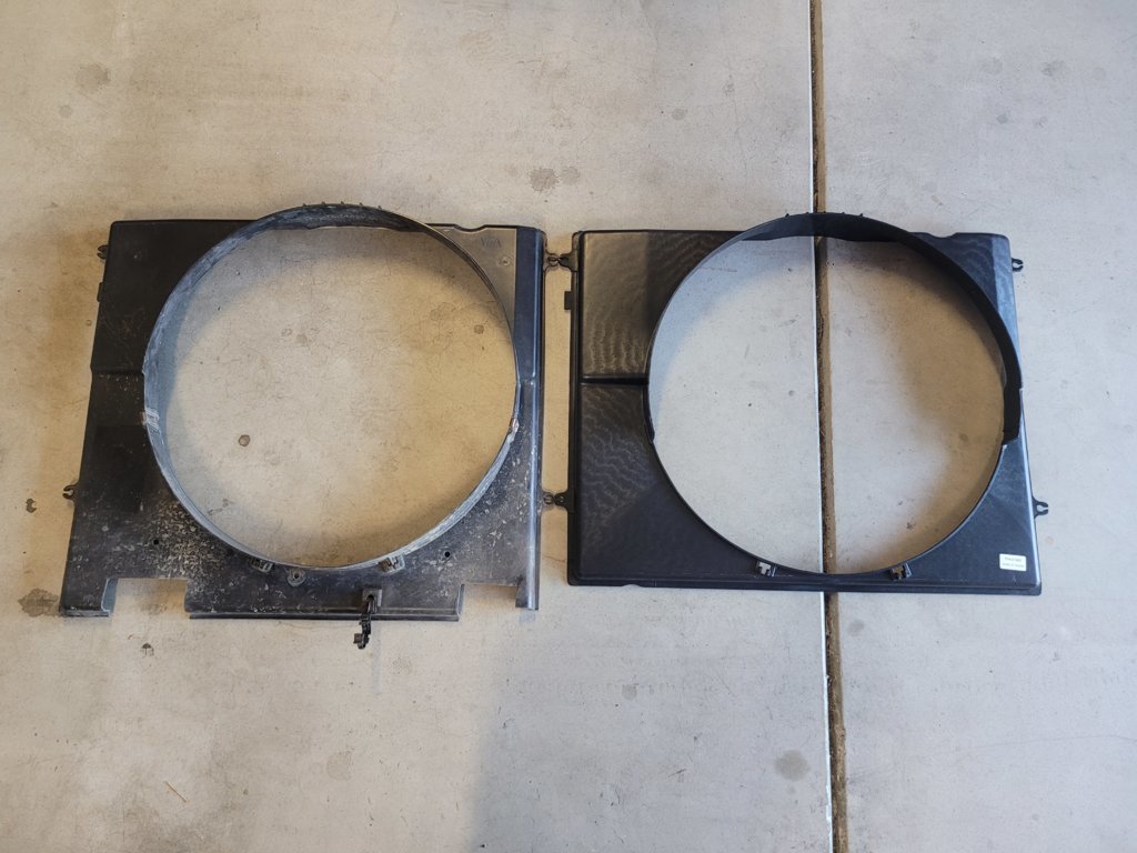

    auto shroud vs manual shroud
    Manual shroud #TO3110111

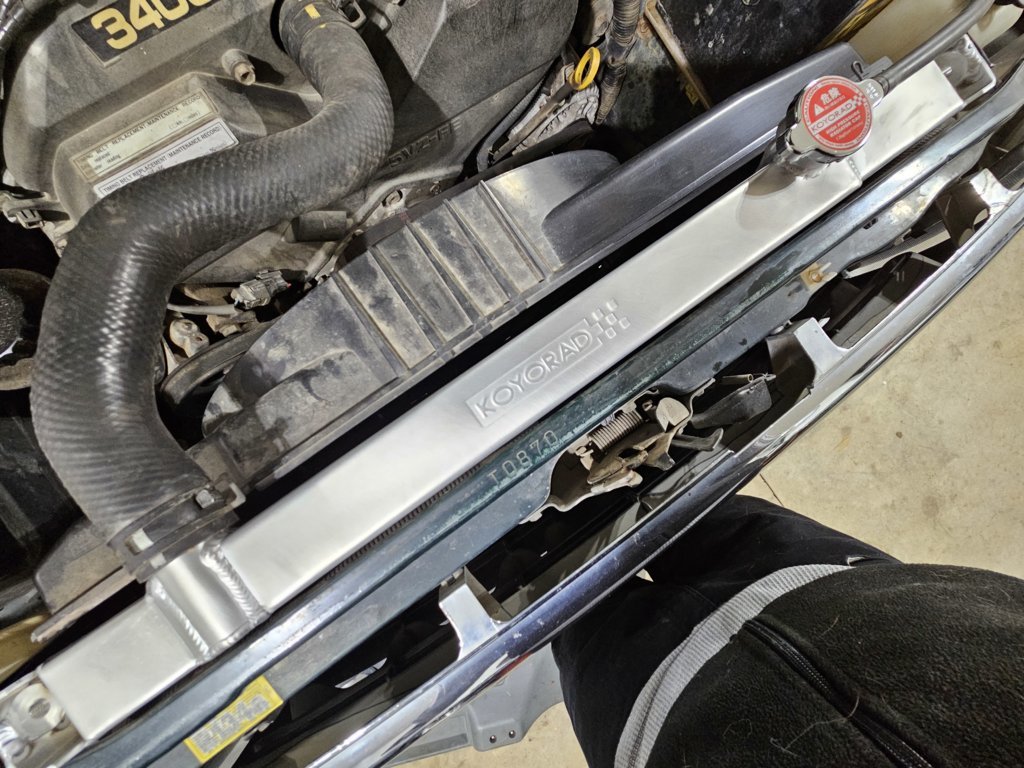

    I just dropped the all-Alumimim Koyo into my '99 MT truck. On first impressions they seem like good quality units. I did run into minor fitment issues though.
    The hangers needed to be bent in a little beyond 90 degrees, and the bolt hole span for the plastic shroud was spaced a little longer than factory. This meant I had to take a rat tail file to the plastic mounting ears to effectively lengthen the bolt hole span of the factory shroud. Again, not huge issues but for almost $400 I would expect a perfect fit. Here's to a long life filled with long life coolant!
