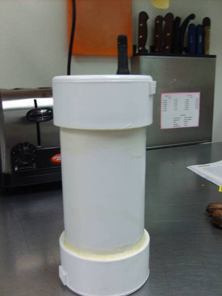

    Just finished up my TPMS "pipe bomb". I bought straps for the sensors but decided not to mess with them. The tire guy didn't think they would work. I will have that light off as soon as the glue dries good! Yes they do stick out a little bit more just enough to fill out the wheel well. My neighbor gave me the wheels off of his 2000 Tundra TRD off road.

    So Randy Im not really knowledgeable on wheel sizes. So does the different backspacing make the wheel stick out more or is it closer to the frame? And what would be the easiest way to disable the TPMS. I cant stand lights on the dash.

    To disable the light you can either put a piece of black tape over the light on the dash, or pull the gauge cluster out as if you're going to swap LEDs, and just pull the tpms light. It's really not that noticeable though.. I can't stand lights either but I can't even see it with the wheel tilted up slightly and my scangauge mounted in front of the dash.
    Or if you have tpms sensors and don't want to put them in the wheel you can make a PVC pipe "bomb" and put them in there and put a valve on it to pressurize them and fool the system.

    I was thinking of the "bomb" version. It shouldnt be that hard. First gen wheels are cheap as well. BTW can you still use a HiLift wheel strap with 1st gen wheels?

    Like Josh said the TPMS Bomb is the easiest way to trick/disable the system.

    Here is my creation. So far it's holding air. 3" PVC, flat caps primed and cemented, rubber valve stem. I wrapped the sensors in towels to keep them from banging around in my tool box. After I glued the caps on I let it dry for 24 hours, the light reset itself and has stayed off since.
