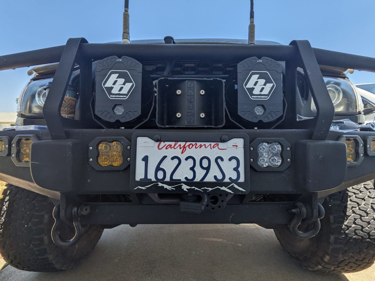

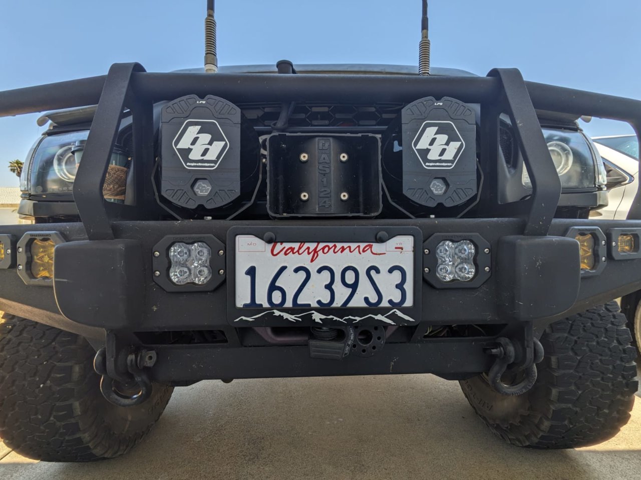

    Lens swapped the center pods from Yellow Combo to SAE Driving, should allow me to legally tap them into the high beam and use them on road when needed. Should help augment the headlights on wide open roads. The high beam on the HID projectors are kind of meh. Also the screws Diode Dynamics use strip way too easy, so there kind of like this forever now

    the torq head ones on the back? the blue locktite they use is a bitch sometimes lol. i ended up buying like a 30pack of the bits so i always have a fresh one just incase.

    Yup! They loctite them like they'll never be removed! Had to dremmel two of the screws into flatheads to get them off. Even the main mounting ones could be better. The screws on my previous pods were way stronger and never had an issue.

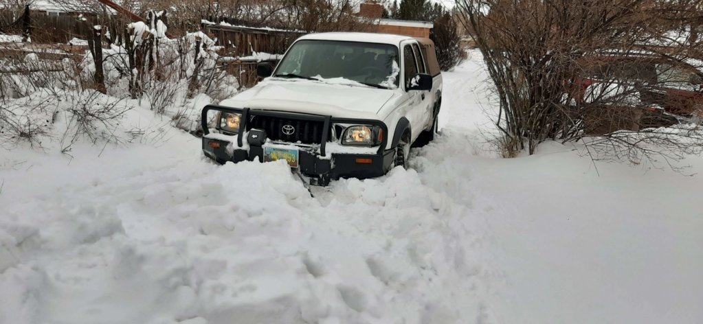

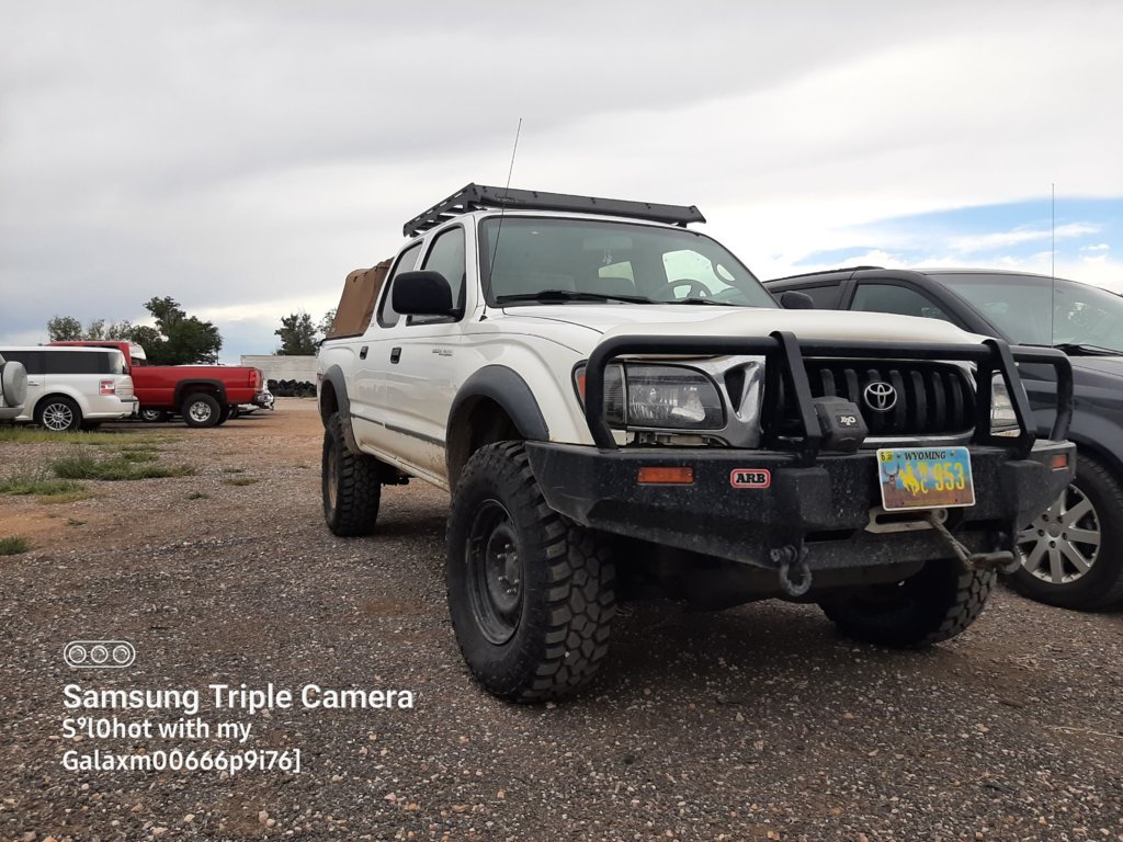

    Love my ARB. Thought I posted pics of it but I guess not.

    Suspension set up?

    2inch OME full kit. Went with the 881s in the front and new Dakars in the back, with nitro shocks front and back.

    Rig looks really nice.
