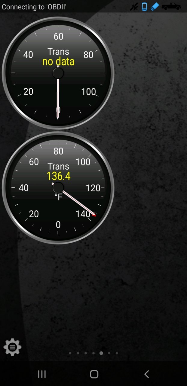

    Okay, so funny story.
    I was messing around with Torque Pro again, and I found two “stock” PIDs, one called “Trans temp (method 1)” and the other is “trans temp (method 2)”
    Method 2 works for my 2004!
    It seems to have a more reasonable value than either the C to F conversion equation, and is within about 5 or 10 degrees of the equation that is used for my 4Runner, and seems more reasonable based on nothing more than a "gut" feeling...
    I don't know what kind of black magic this is, or why I had never noticed it before (maybe due to an app update?) but for me it seems to be working!
    Method 1, btw, just gave “no data”.
    Here's a shot of the 2 "methods" top is method 1 (no data), method 2 is bottom

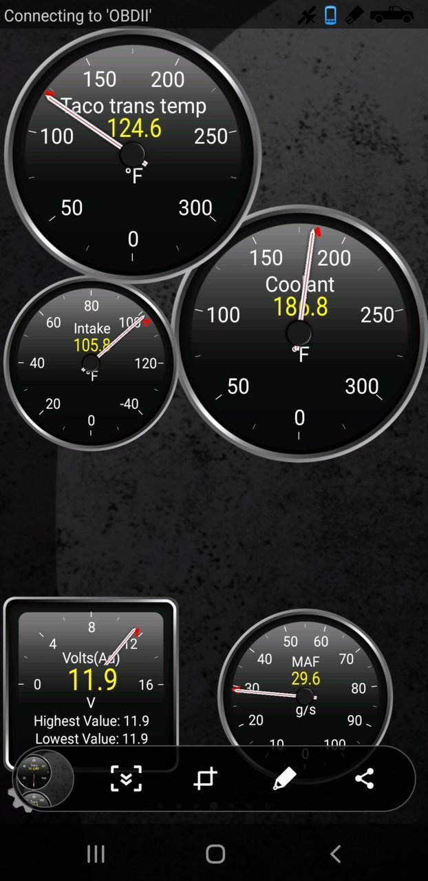

    This is he shot of my custom PID with my 4Runner equation that I posted earlier.
