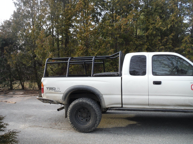

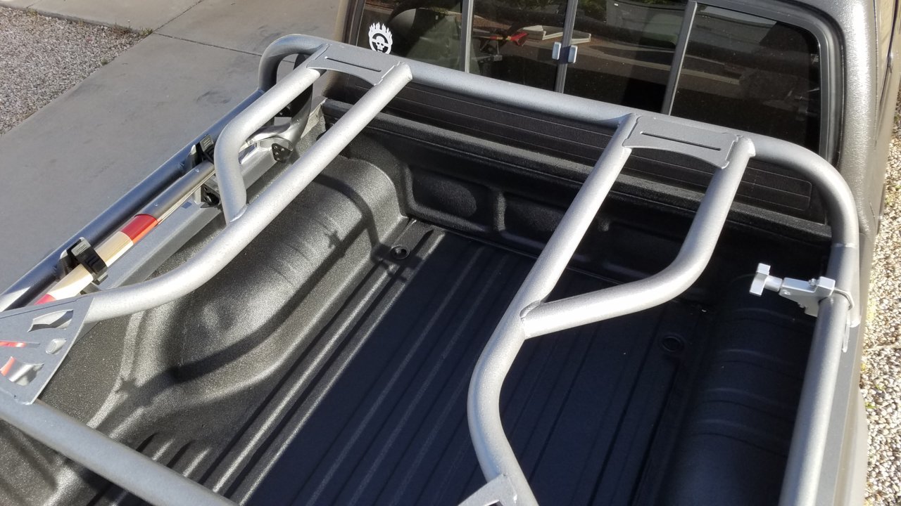

    I built mine, it's a little heavy, but it works for me.

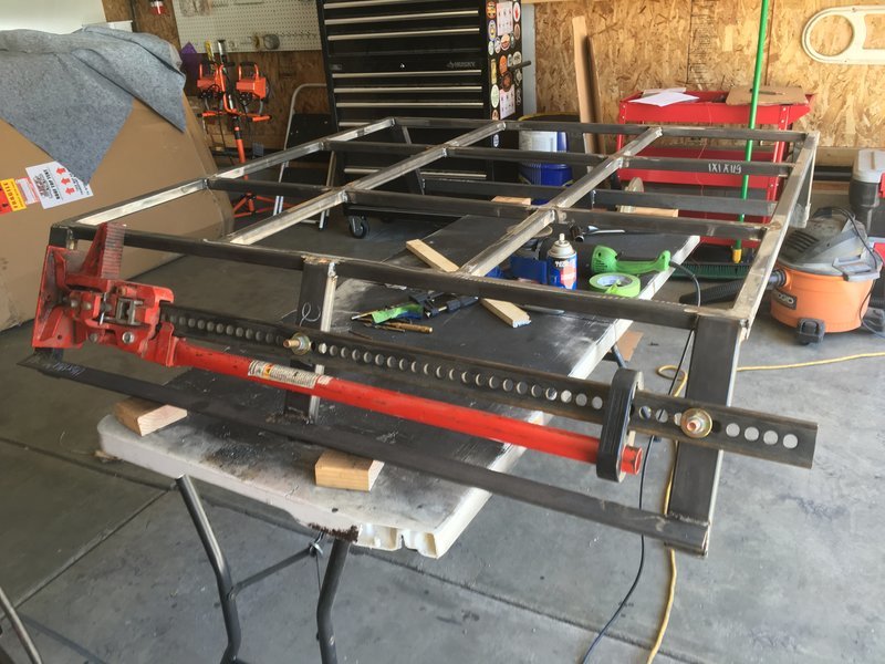

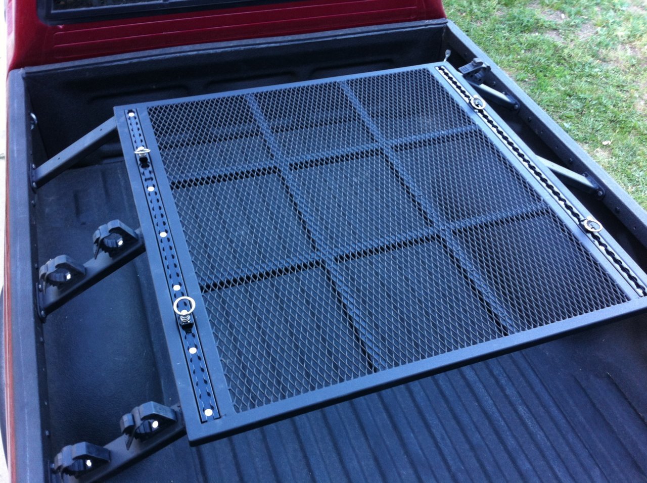

    Little bit different style, but I'm happy to make you one of mine...
    @turbodb Fabbed Bed Racks

    Seems as if everyone is making an angle bracket and then drilling thru the bed to secure it. Has anyone found a secure way to mount without drilling thru?

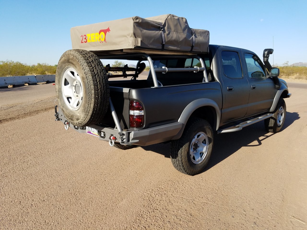

    That thing is sick! Does the carrier rack run the full length of the truck or is it two individual ones? Is it integrated into the bed rack or seperate?
  9. Jun 19, 2020 at 5:14 PM
    #69
    Phessor
    Phessor Well-Known Member
    Feb 15, 2014
    #123156
    3,580
    Thank you.
    The headache rack is bolted to the bed. The bed rack attaches to the headache rack and the 2nd Gen bed rails.
    The basket is a single unit attached only to the bead rack.
    The basket and bead rack takes about 10-15 minutes to pull off.

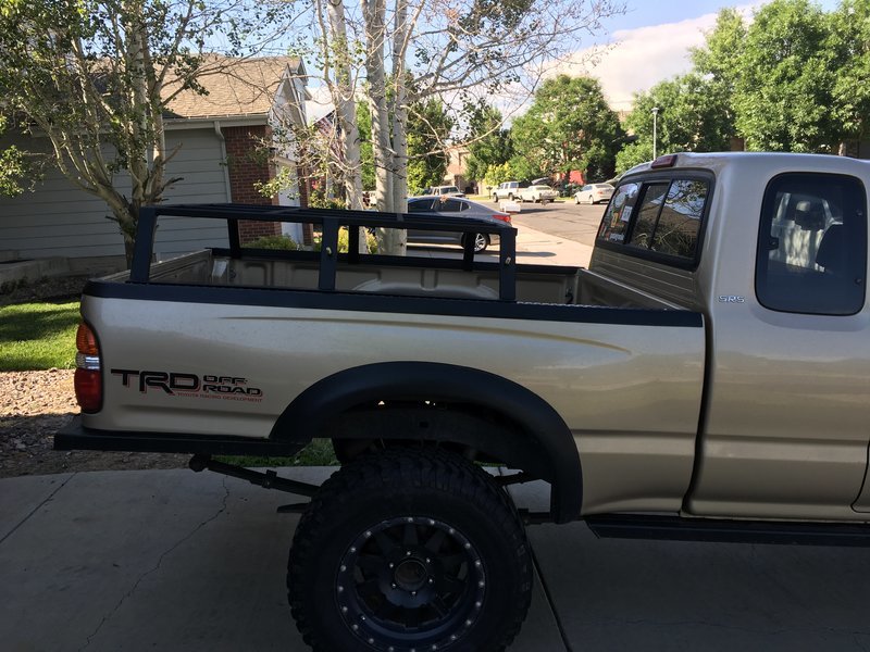

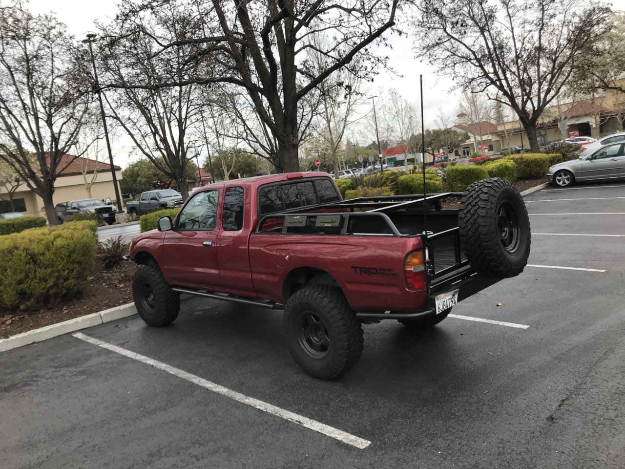

    One off Hurr Durr Fabrication bed rack:

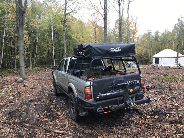

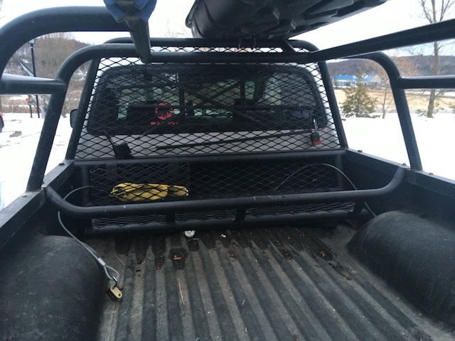

    Figured I should revive this thread because my rack is going to be for sale soon! I'll probably post it in its own thread in the 1st Gen Parts section. I love the thing and it's been super useful across 3 1st Gens, but I'm moving up to a GFC and it doesn't make sense to store it unused for a while.
    They are my own designs, executed by my friend locally: rack (aka the Dino Cage) & toolbox shelf (aka the Tool Hammock).

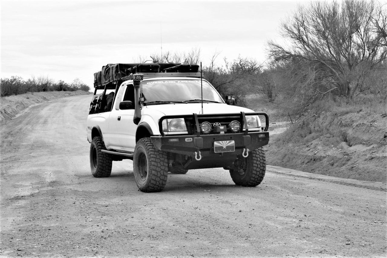

    Does anyone recognize this truck? Outside of the rack, just curious about the rest of the truck. Found it in a reddit post.
