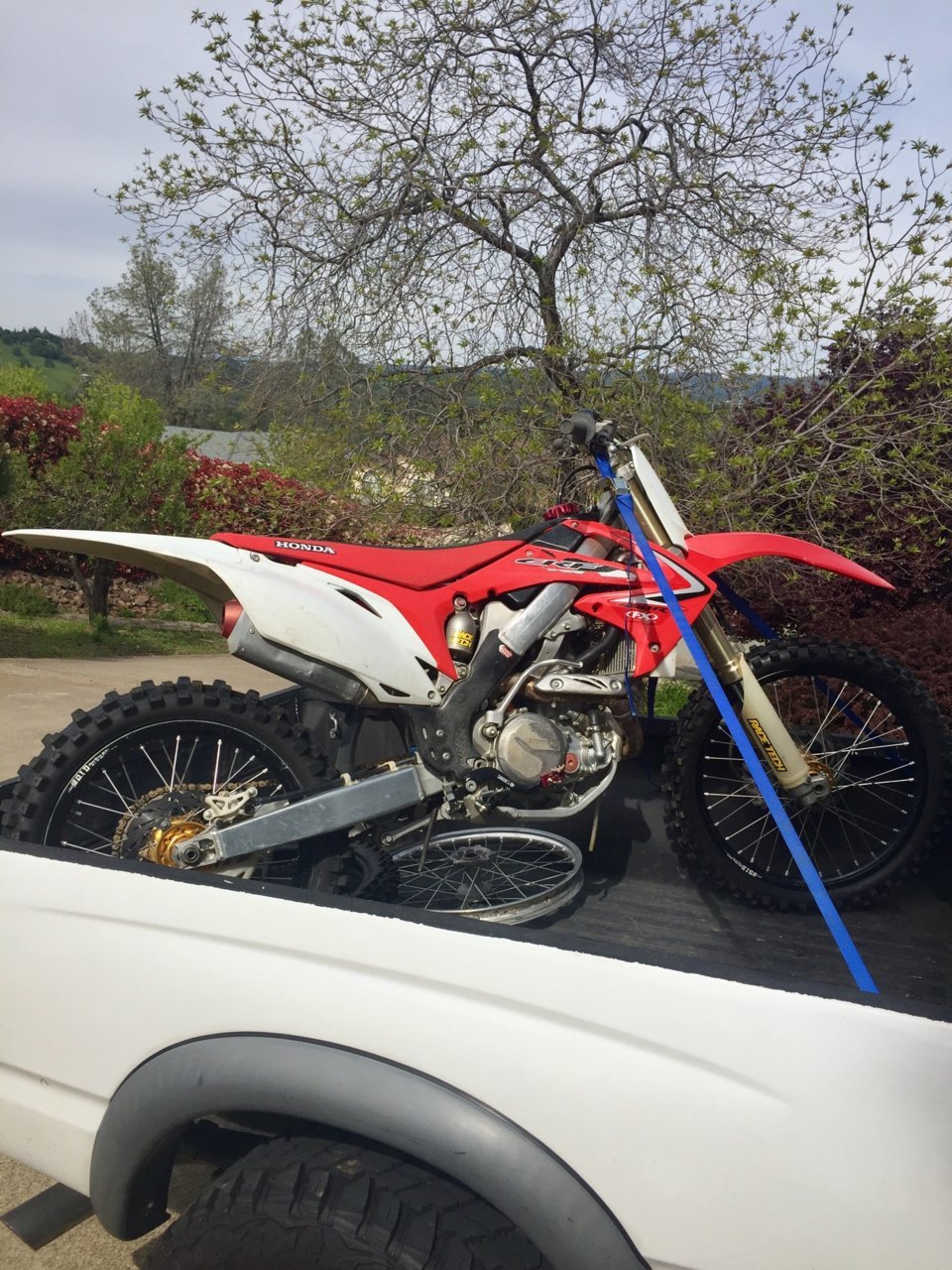

    How many tie down points do you think you need? If your bike is centered in the bed, 2 is plenty.
    I've routinely put 2 dirtbikes in the bed of my doublecab with the factory D rings (4 corners). All I do is attach the straps to each of the front rings/h-bars, then, on the outside of each bike, I add another ratchet strap from the outside of the h-bar to the rear D-ring. Since the outside straps are nearly vertical, I add that extra rear-facing strap for a little extra support.
    I've been doing that for more than a decade, no problems whatsoever.
    If you wanted to add more tie down points, you'd need to reinforce the sheet metal of the bed, and not just drill holes and bolt in more D rings. The factory corner D-rings are strong as hell.
    My buddy has a 2nd gen with those stupid rails with the adjustable loop things, and I see them flex every time we put bikes in his truck. They've never failed, but I don't trust them nearly as much as the factory ones on my 1st gen.

    I would however, suggest a fork block or something to keep the forks from compressing while you wrench down on the straps. When the bike is centered in the bed, it's not a big deal, but I found that with 2 bikes, and the outer straps are nearly vertical, even a little be of movement (when the forks compress slightly when cornering, etc...) makes the bike sway more than it would if the straps weren't so vertical.
    My buddy uses a 2x4. I have a fancy pants fork brace like this
