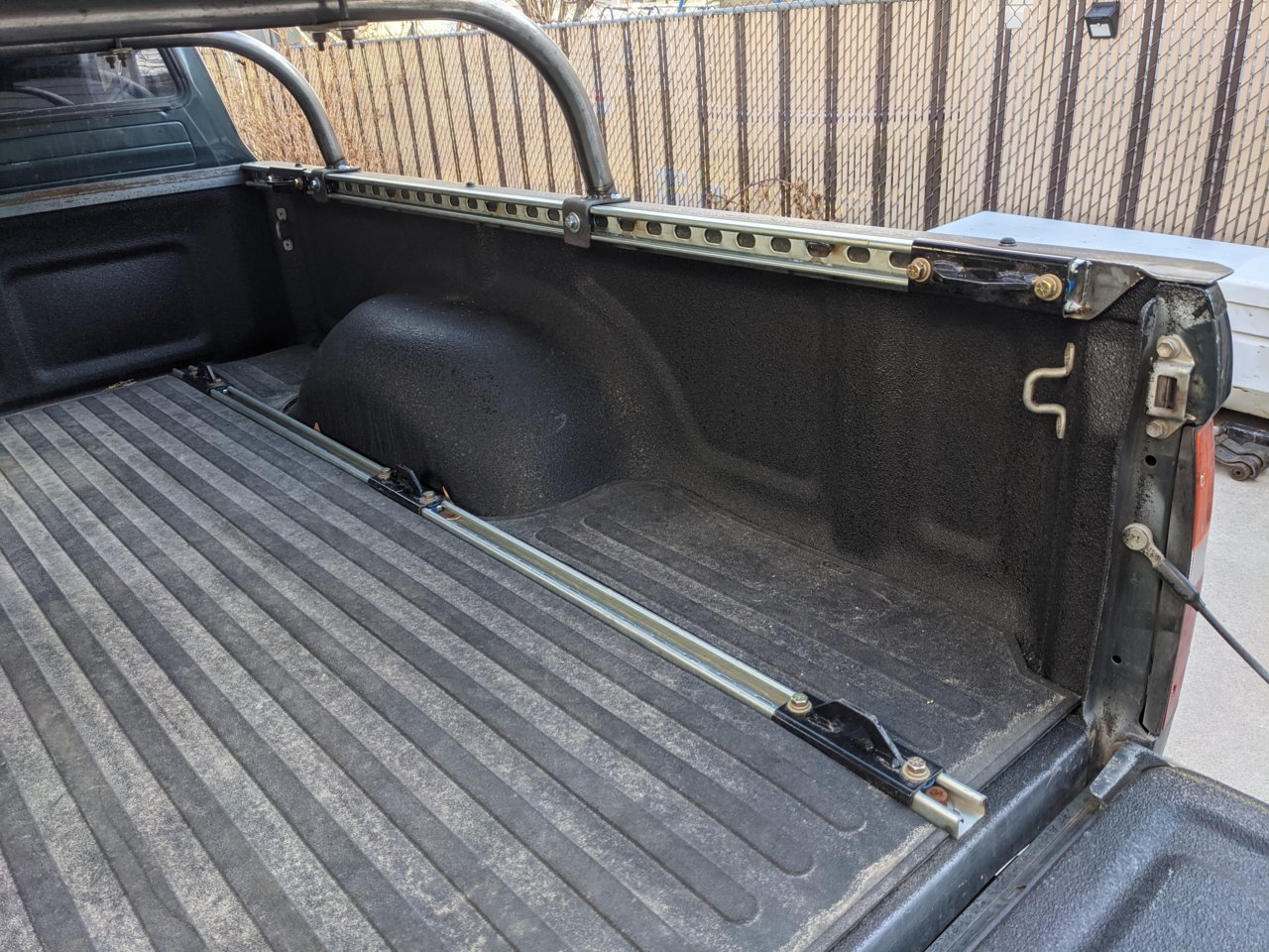

    I have a homemade tie-down system built for the truck at this point. Which works great for a lot of the things I do.
    It's made out of shallow electrical strut, which you can get at any hardware store. I made several adjustable tie downs that can be placed where needed. Its kind of funny because I thought I would like the adjustability, but I don't really use it very often, still nice to have I guess.

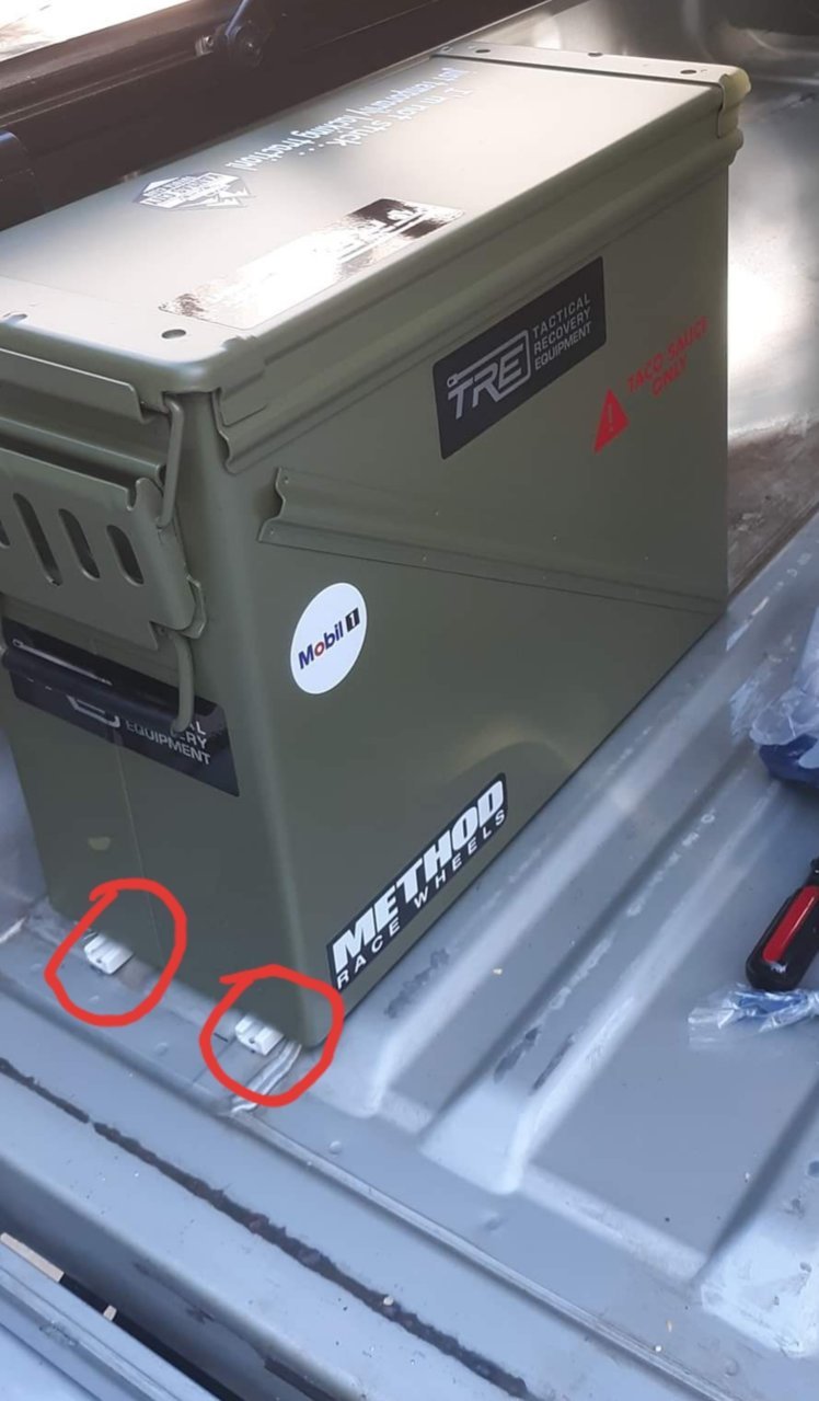

    20mm ammo can IIRC
    36" T-track from Amazon, cut it in half, powdercoated the tracks and ammo can (I paint and powdercoat for a living so why not), self tapped screws into bed. 1/4" bolts side right in track. Lined up the ammo can where I wanted it, marked and drilled holes in the bottom of can. I wanted to be able to remove the can IF for some reason I needed the whole bed for hauling stuff. It WOULD slide in/out, but the screws I used to hold the T-track down are slightly too big and prevent the can from moving. I'll fix it later

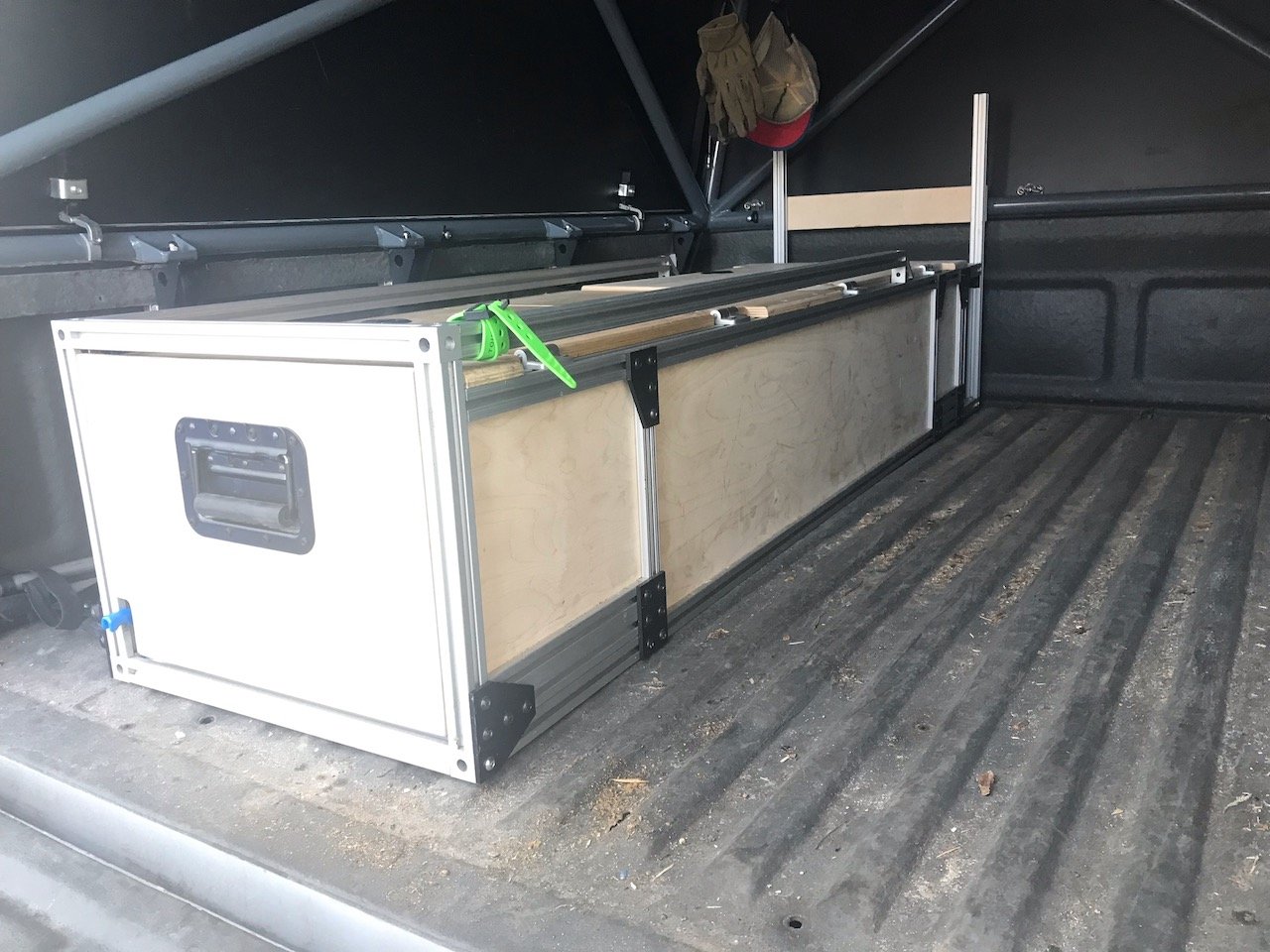

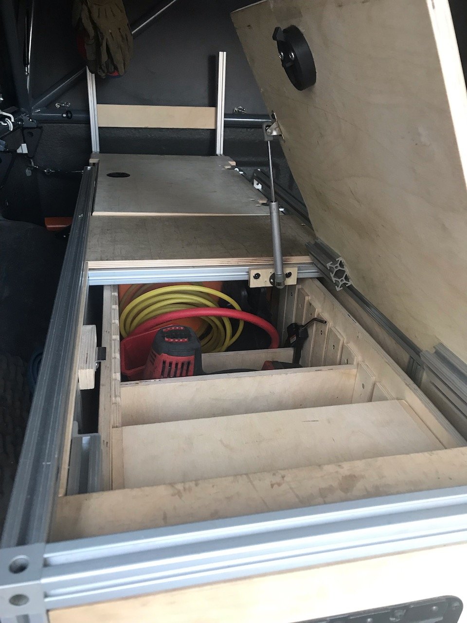

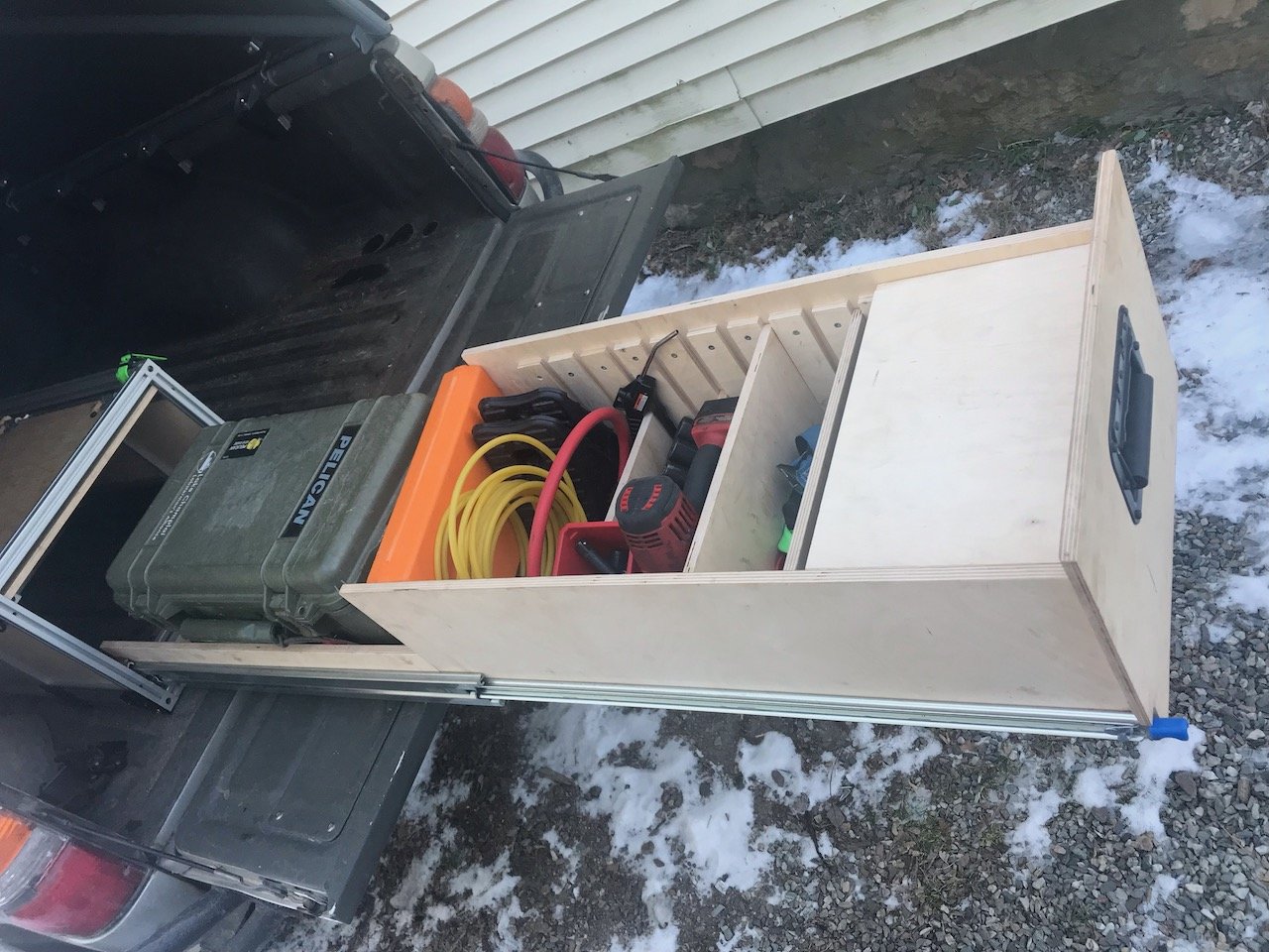

    I've had this exact question as well and haven't found exactly what I want to this point, but I have started having fun with extruded aluminum framing so I guess there's that.
    Always a work in progress, though. (Yes it's crooked in the first picture. I straightened it afterwards.) IMG_0591.jpg IMG_0590.jpg IMG_0592.jpg

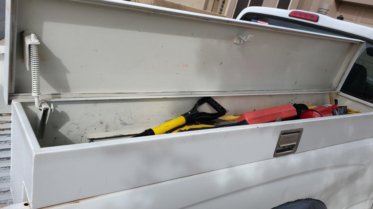

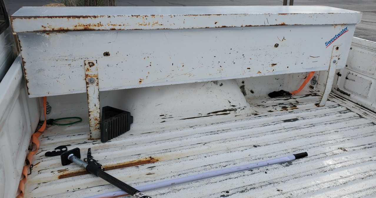

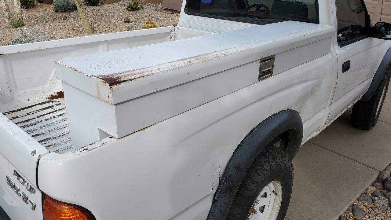

    This is a full size box. It's already full of stuff that I keep in there pretty much all the time. I also often have a plastic tub ratchet strapped in the bed with things that don't need to be secured in it. I need to put the other toolbox on the other side so I have some clean empty temporary storage. These boxes are more secure but they're so heavy I'm thinking about switching to aluminum.
