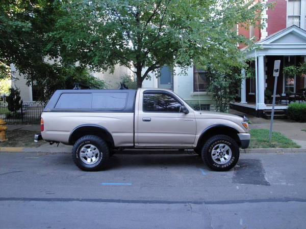

    here's my 1st gen, 5100@1.75 with stock coils...

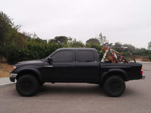

    anyone have any more pics

    here is my trucks journey through the suspension swap
    1st up, stock
    after install and front bilsteins at 2.5
    and after having the front dropped to 0
