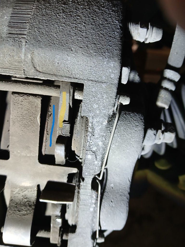

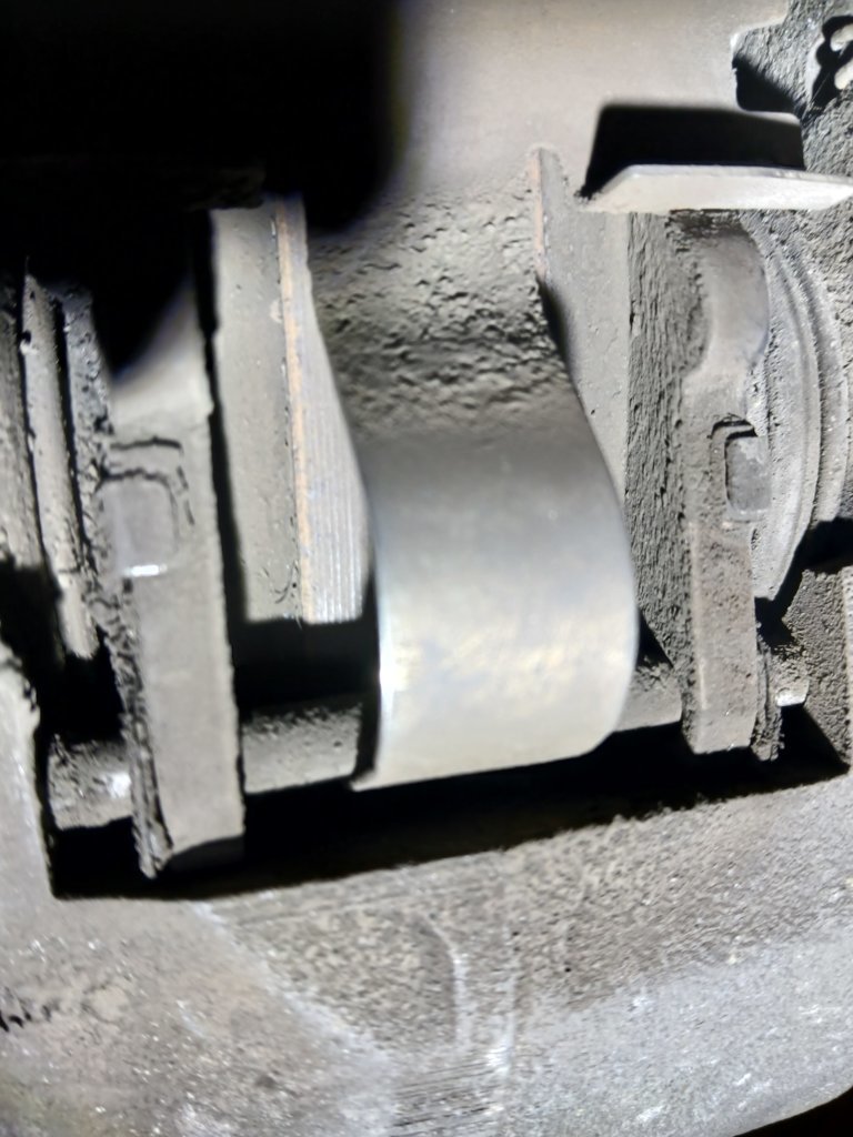

    I watched video and looked at my front brake to try to determine if my pads were worn since truck (2000 Tacoma 4wd) is not stopping well. I have pulled wheel off but have not removed clamps. I don't see any pad (if I am looking at correct place.) Can you tell from these pics or do I need to remove anti-rattle clip?
    Am I looking at it right? Are the pads gone?

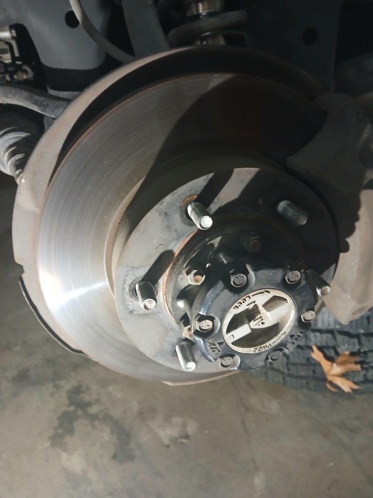

    Show us a picture of your rotor!
  7. Mar 31, 2025 at 1:48 PM

    Here is Rotor

    So I see some wear but I can't tell if there is gouging which would mean your pads are done. Also can't tell from your other pic. Pull the 2 bolts for caliper and look, its harder to take the tire off than the caliper. Just make sure you have a C clamp to reassemble if you need to squeeze the caliper pistons. Maybe someone else can chime in, I can't tell for sure.

    Looks there is pad material left, blue is actual pad material (which contacts rotor) and yellow is the backing plate (which supports material).
    You can see the shims, and just the edge of rotor under the spring clip.
    I just did a complete front/rear brake job on my 3rd gen 4Runner (similar brake system as 1st gen Tacoma 4wd) and it made a significant difference.
    The old brakes didn't look "bad" measurement-wise, but new OEM Toyota rotors/pads/hardware really improved braking performance.
    I also did the rears while I was in there, along with a full fluid flush.

    Looks to me like the pad in your photos is in there cock-eyed. This could be caused if one of the pistons in the caliper has bound up and is not working.
    Here's what I have done in the past and what I would do now if I had the problem:
    1. Replace the pads with Genuine Toyota parts
    2. Replace the caliper rubber O-rings with whatever I could find online
    3. Hone away any rust from the caliper bores
    4. Replace the calipers with decent online parts if they look iffy
    5. Replace the rotors if there were any heat spots on them or if they appeared warped in any way.
    Then and only then would I take a look at the back brakes.

    Toyota checked them out. Pads still good in front and near new in back. They cleaned them up and adjusted them and they seem to work better. Still considering the Tundra upgrade because they still don't seem to have much stopping force. Thanks for all the advice.
