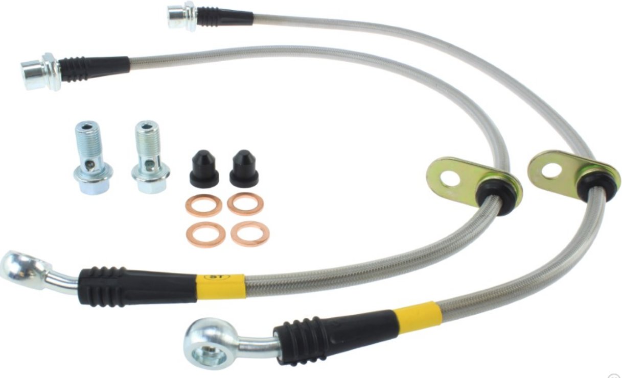

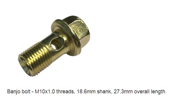

    Just to experiment, I ordered a set banjo bolts from Zeckhausen Racing https://www.zeckhausen.com/ just to see how they look in real life and it they are even close to the ones that I have on the Tacoma.
    I have big brakes running on one of my other cars that could benefit from new lines and I'm sure from improved flow from a larger banjo bolt.
    From the picture below, it looks like StopTech Stainless lines come with the big bore banjo bolts like the one in the picture above. I like what I see here.
    Though I already have two sets of stainless lines that I'm on the fence about installing. Knowing what I know today, I think these lines would be my choice.
