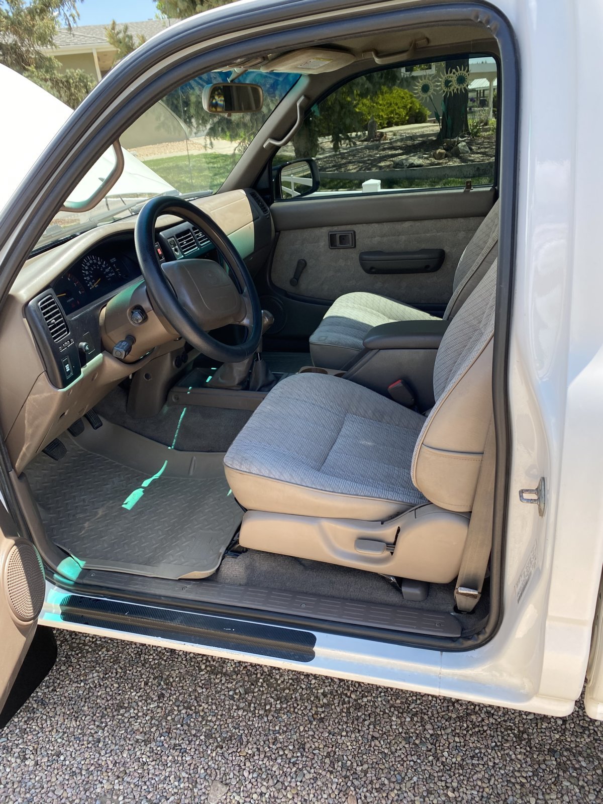

    2000 taco
    I found an excellent pair of bucket seats from a 04 4runner. The only thing I had to do was take the cushions and upholstery off the 4runner frames and put them on the tacoma frames (which fit PERFECTLY) so there was no reason to mess with them bolting back in because they were on the tacoma frame. It took me about 3 hours to do both seats.IMG_0995.jpg
