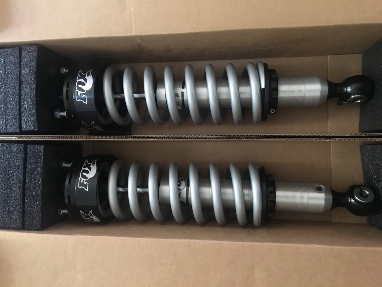

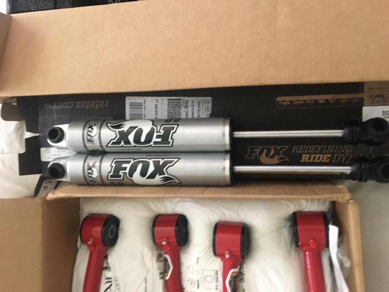

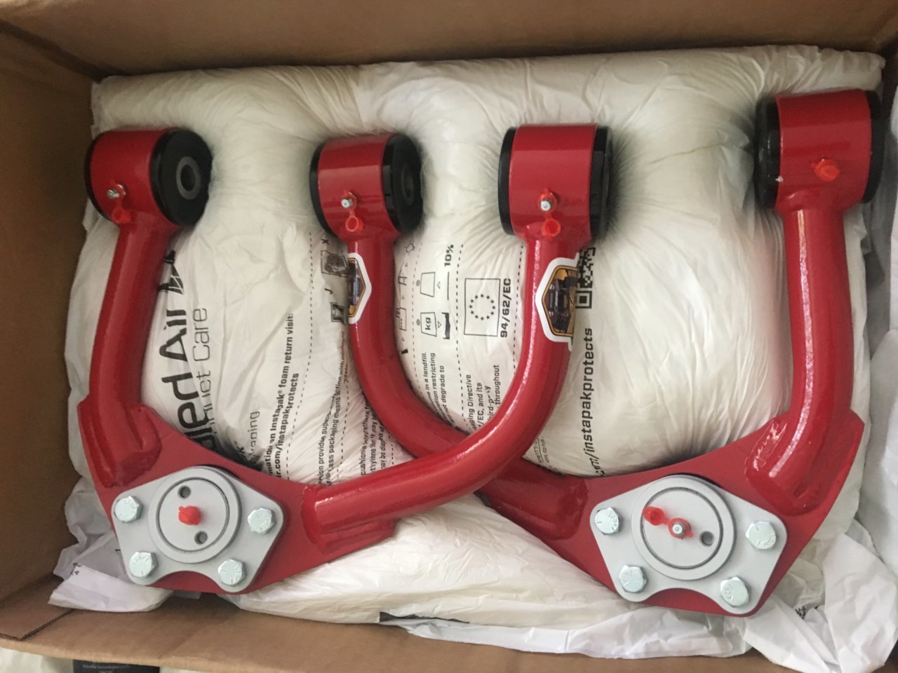

    So guys i went with the 2.0's couldent find any 2.5's for my year, sadly but i got 2.0's all around with JBA UCA's i'll post pics rightnow & give a review i also installed a top light bar & going to install the shocks soon, i actually was looking at LT set ups & haft to go LT next year or something

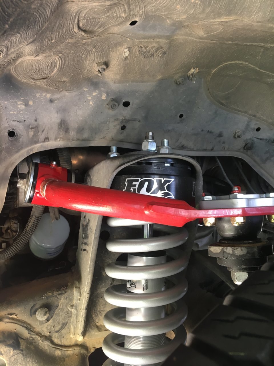

    Why yes i have actually weeks ago! & omg is the performace amazing trust me the difference between stock is insane also your gunna need new UCA's with these coilovers it gave me a 3inch lift & if i dident run the UCA's my arm would have been drooping way to far down for it to have any improvement in performace i only paid 1500 for 2.0coilovers & rear fox shocks with the JBA control arms i plan to go long travel in a couple months with 3.0 shocks & bypasses but thats gunna be for another time
