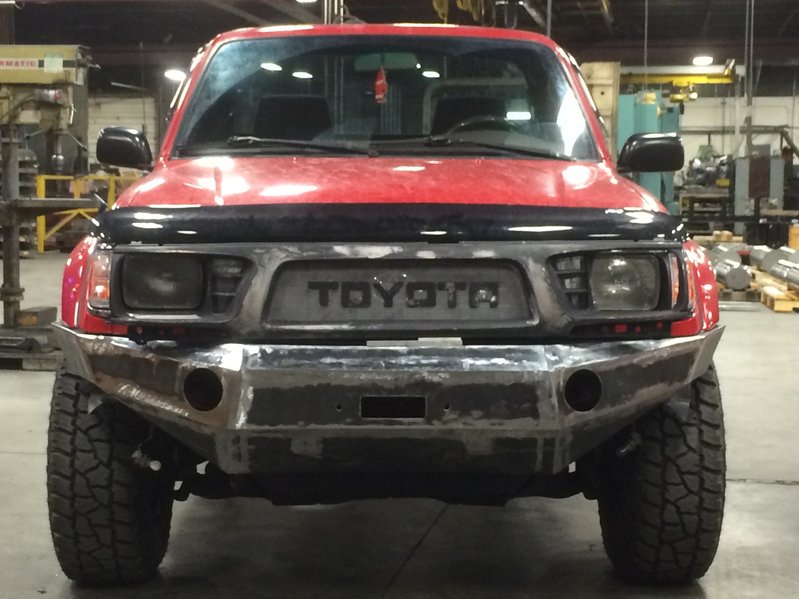

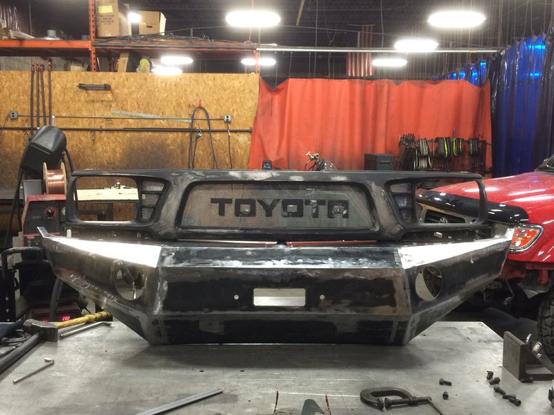

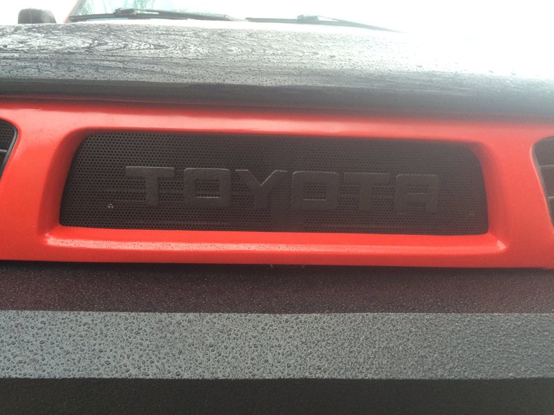

    So we have finally finished welding and grinding the bumper. As expected there was some warping with welding the sheet metal, so final fit might take some heat/bending. I also am nearly finished with the new grille. I had to bondo over the entire face due to the chrome flaking up, cause a little bit of frustration.... haha. The grill insert was a bit of work, but I think it will really set the front of the truck off!

    It's really not too bad. The only down side is that when I started to scuff the chrome it began to peal so I basically had to bondo the entire grille, that has added a lot of time. But I think it will be worth while, should really change the attitude of the truck.

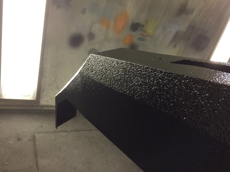

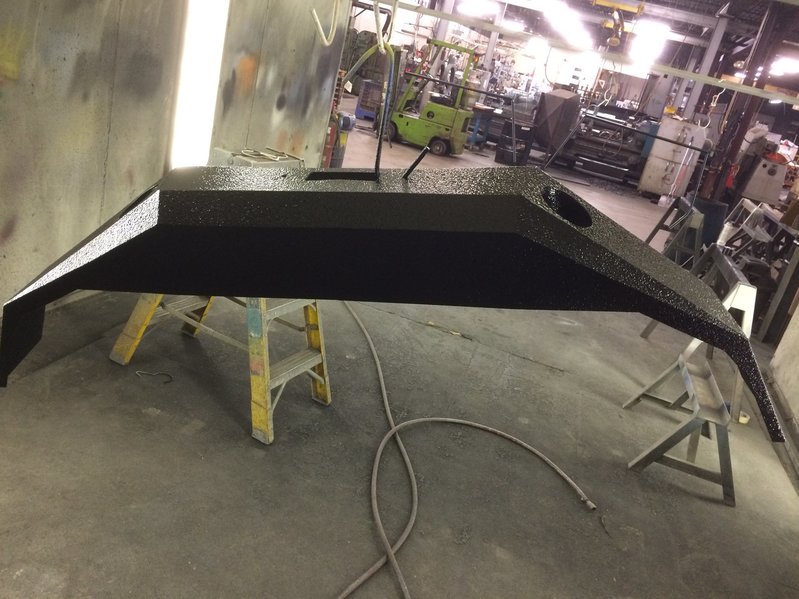

    Finally got to paint today. I am very pleased with the performance of the monstaliner. I decided to buy a shuts gun and thinned the monstaliner with Methyl Ethyl Ketone I purchased from Home Depot. I split my quart in half for the tow coats. By volume I used 7 parts liner, 1 part hardener and approx 1.5 parts MEK reducer. Using one quart allowed me to do two heavy coats on the exterior of the bumper and a bit on the inside. It was the perfect amount of product. The texture was great, monstaliner is something I plan to use again; very easy to use. Here are a few pictures of the bumper how it looks just after the final coat.

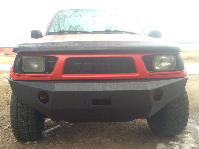

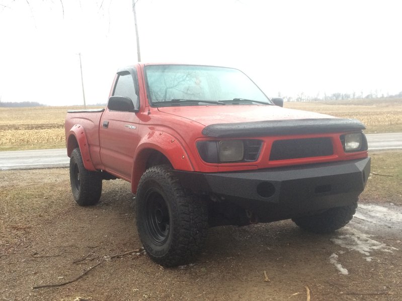

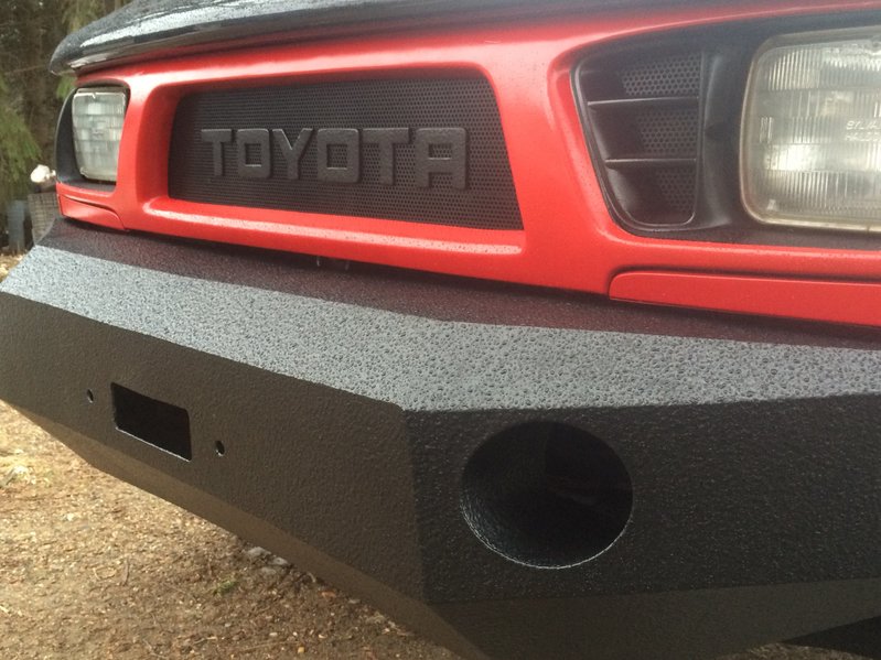

    Here are some final pictures of the front bumper and grille. From stock to this point my father and I did in 12 days. If anyone is interested in having a 'weld it yourself' kit let me know. If enough interest arises i'm sure I can make some happen. Shipping is the biggest concern right now. I'm also considering making a DIY grille kit, like the one on my truck. Let me know what everyone thinks! Thanks!
