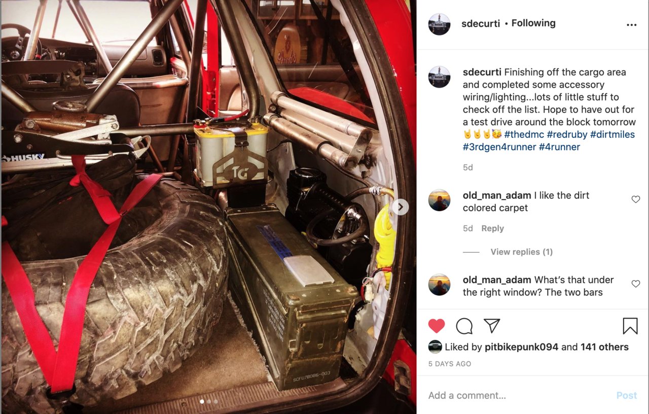

    @Anthony250 (Green truck) and @2002 tacoma s/c LT (last gray truck) both have third seats above.
    Not exactly a Taco but a 3rd gen 4runner - I believe he made it to have a bench in the back part time.
    This is similar to what you might look at doing?

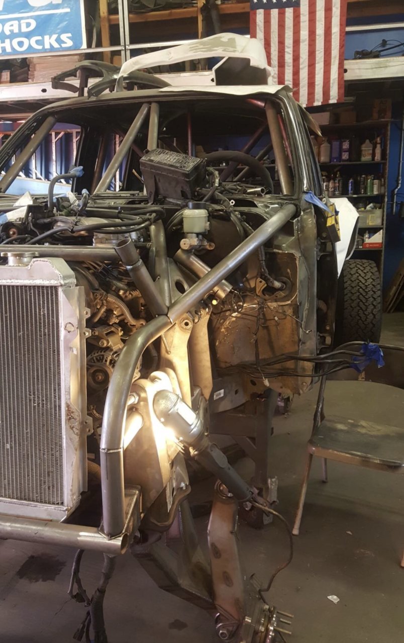

    Not IFS but that shouldn't matter :) I literally tore the whole interior apart, took the windshield out, rear window out, dash out, everything. Even took the doors off so I wasn't fighting to work around them. Cut out a bunch of sheet metal so I could tuck the cage up as high as I could too. Worked out nice! You'll have to be methodical in how you assemble things so as to not back yourself into a corner and not be able to 360 weld everything. Some of my tubes I wasn't able to get 360 but its stout enough that I'm not worried about it. If I tore everything out from behind the dash I could have got 360 welds around the windshield defrost vent but I'm confident in it. Everything works too, windshield defrost, both side vents (driver side needed mods), center vents, AC, wipers, everything. Really up to you how "right" you want it done. You don't HAVE to do all the stuff I did but if you take your time, you'll be happier with the end result.
    I did basically build the entire top section (with tubes coming out of the back of the cab), cut the sheet metal out above the rear window and dropped that section down to weld everything 360 then pushed it back up and finished building the bottom half. My engine cage isn't elaborate but its strong in all the right places, can still easily work on stuff if you make key tubes removable. The only tube I'll have to make removable to pull the engine is the middle back tube against the firewall. Also had to make one tube removable by the brake booster so I could change that if I needed to.

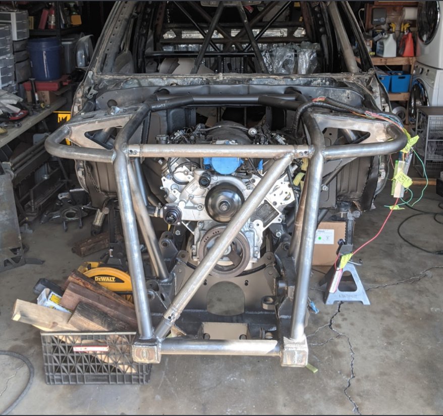

    Depends how extensive you want the cage to be. I wanted 4 tubes to connect the engine cage and cab cage which means welding directly to the middle of the dash tube and that can't be done when you drop the cab cage to fully weld. If you only want a sick cab cage but no engine cage then you can more easily access everything. My rear window was super easy to remove, took maybe 10min with a piece of rope. Some are glued in like the windshield, in which case it will be more difficult to remove. Think all 1st gens are removed the easy way though. They have kits to remove windshields with copper wire which is what I did and I was able to save the window but I could have saved myself that time and energy by hiring the pros remove and replace it, ended up with a new windshield anyway. Have a lot more build pics on my IG if you scroll down a ways haha @breynolds84
