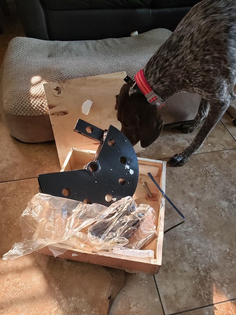

    So not sure how Eastwood wants to do this but it appears the first die actually got delivered and now a second one is already on it's way. Wonder if Eastwood won't want one back and I get a 2for?????? FUCKEX pulled their head out of their ass and I guess after my package sat there for a couple of days they decided to deliver it.
    GSP APPROVED! YEEEEWWWWWWWWWWWWW!

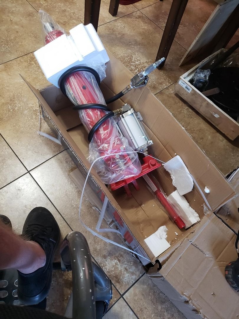

    BUMP FOR ALL THE WHEELCHAIR FAB BROS OUT THERE!!!!
    @CHAIRSLAYER
    My boss at the patio furniture won't let me do anything because I'm in a wheelchair.... The only limitations I have are the one's other people put on me. FUCK THAT BULLSHIT!!! TIME TO BOSS UP!!!
    I'm on super tilt today but just got home with this.

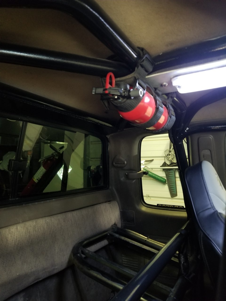

    2001 Toyota Tacoma TRD
    Where you went through the dash, the back. Dash bar if you did one. Frame tie ins

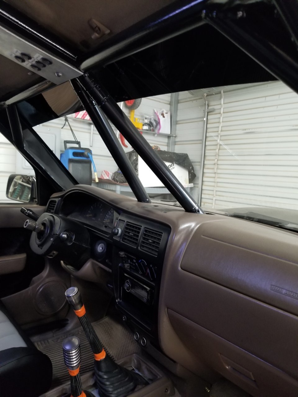

    california
    99 LT trd, 2002 2.4l
    Halfed 3 linked on 33s with 4wd , kings infront ,foas in rear and bumped and strapped 24 travel in rear and 16 infront all bumped on foxs. Fully caged and lights galore
    Has a dash bar. I will send photos when i get off work

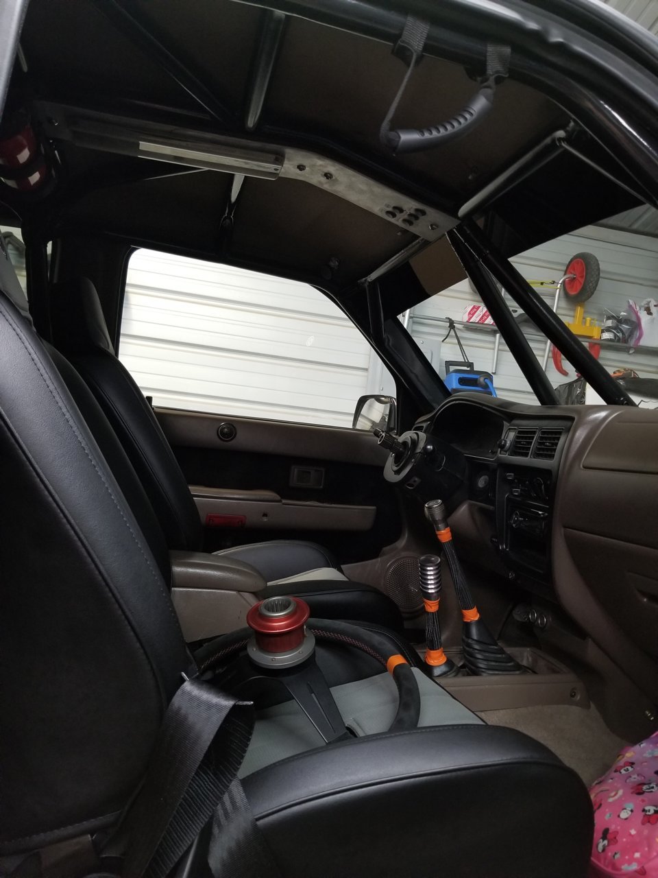

    Truck is back halfed so its a tad different

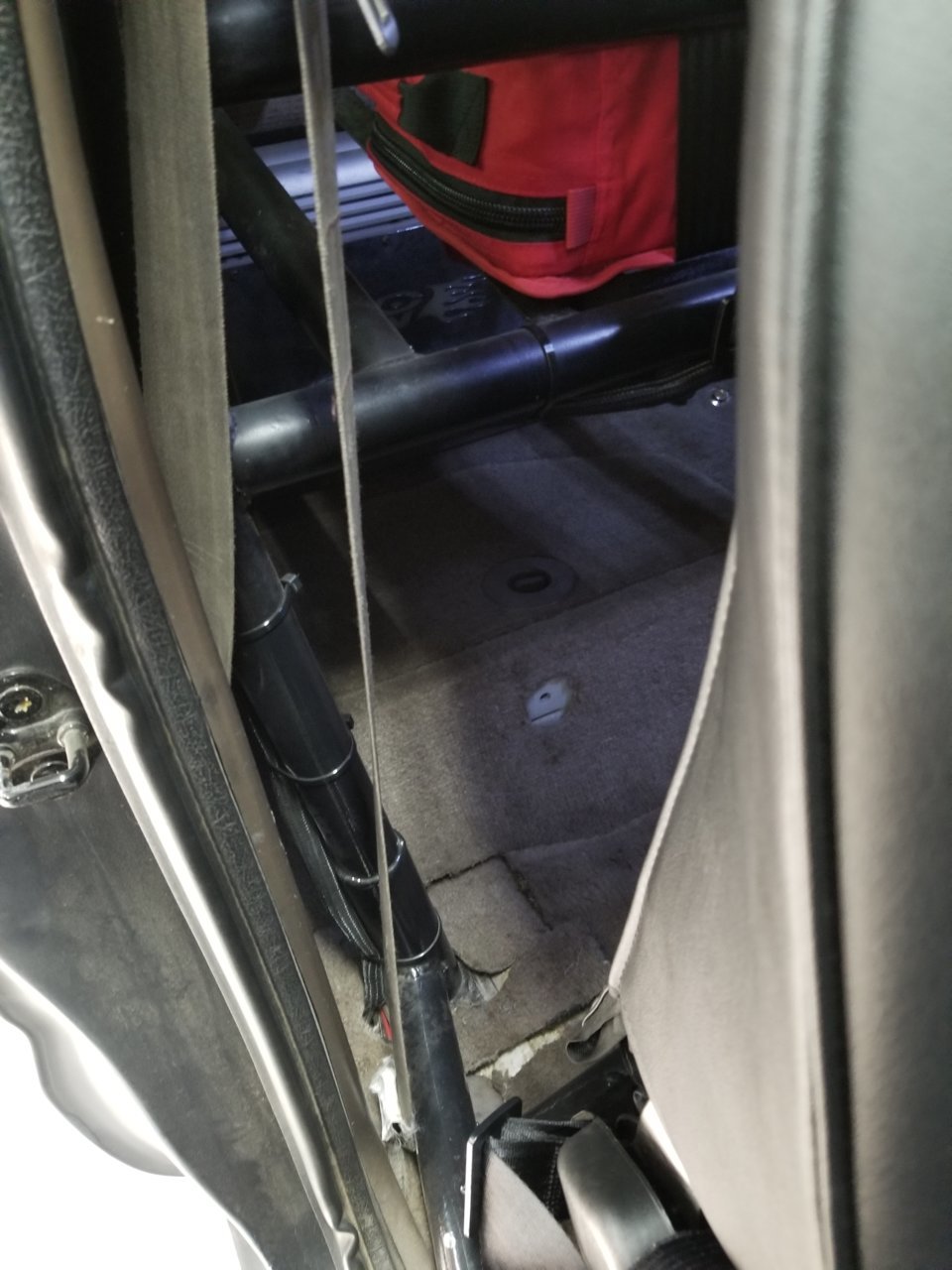

    How hard is it to get behind the Seats into the extra cab portion with just sliders on the bucket seats?
    They are reclining seats so that definitely helps..but withfixed back..it sucks
