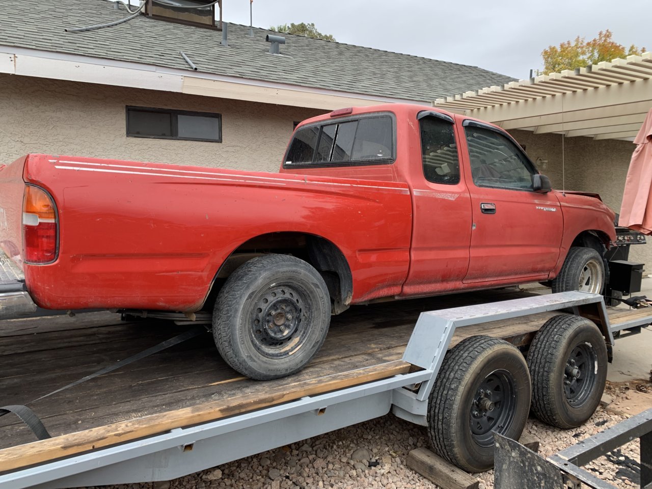

    Bump on this. Picked up a cab to cage and thinking of cutting the floor out and running tubes then building a new floor. 0BC476E3-7F74-4B5E-9E37-68A971D509FE.jpg

    Consider just cutting holes at each pillar and dropping it down the holes.

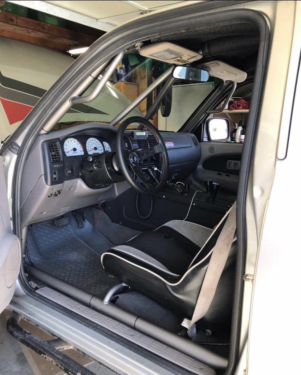

    I know its been a minute... but for all you guys still running the OE dash with a cage:
    did you run a dash bar in the cage?
    did you delete the OE dash bar?
    did you change the fusebox/bulkhead on the driver side to land the Front Side hoop straight down?

    1. Yes, I rolled a cage dash bar tube and it fit perfectly in there. The only vents I modified were the windshield defroster vent (when I added tubes to go over the wipers) and the driver side vent.
    2. OE dash bar was retained as pretty much everything OE mounts to it.
    3. Moved the fuse box towards the pass side to squeeze that tube in there.
    Fernando, your truck will be purdy too after you get those axles under yours!

    Do you have any in progress pictures of the area?
    and thanks for the response, looks like I'll get all the way into that headache.

    I'll check my phone later but it is possible. Would be a bit tougher without a roll bender though.

    I’m doing mine now and I’m using the oe dash bar. If I can’t get the dash out of the truck the cage is going in *(I have a second cab I’m doing the cage in and then transferring it over) then I’ll add a second dash bar above the steering wheel column to build a dash off of.
    I was able to squeeze the down bar next to the fuse box/bulkhead.
