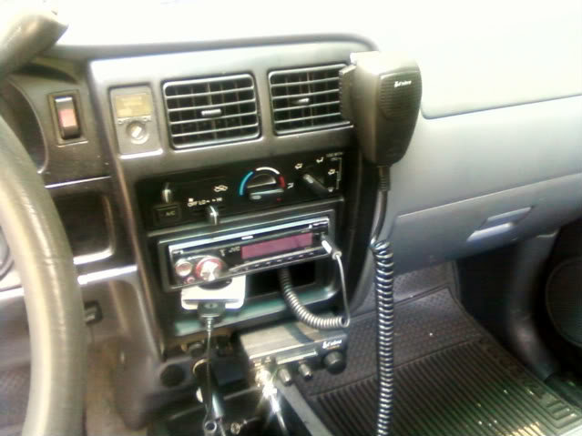

    Yeah, pull the tray and track all the way out. I used a dremmel tool to cut out the rear so I could shove the CB in farther and get more of that "JDM Hella Flush" look, haha. I have a UNIDEN 520XL, we use em in all of our dumptrucks and equipment, work great. I did use the mount to get kind of a double security, just so the CB doesn't try to fall out. But, as someone noted above the fit is TIGHT, and I'm pretty sure Toyota engineered that spot to work perfectly for a CB lol.
