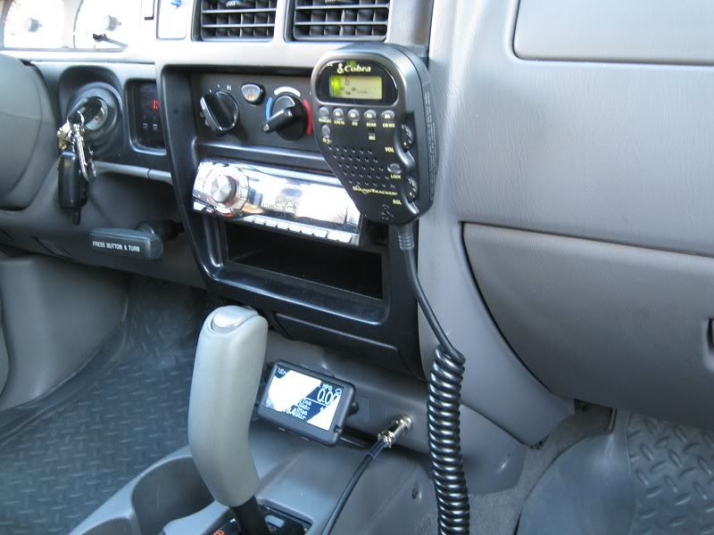

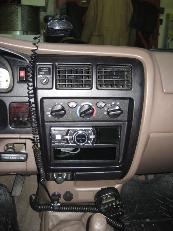

    how my first one was :
    new one temporary spot until i build a box to hold it :

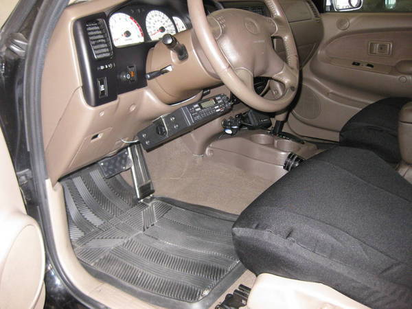

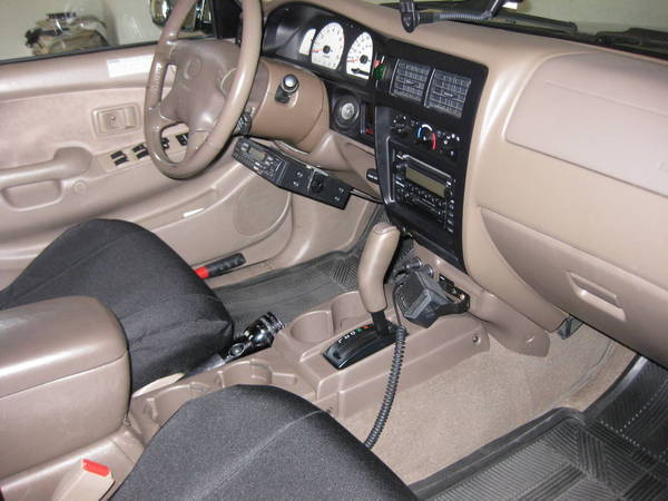

    If ya don't want to limit yourself to only the small units or tear up your dash-my mount location requires only two strong sheetmetal screws and you're done. I am 6'1" and this leaves plenty of legroom for me but if you are taller it may be an issue. My scanner is a pretty good size and I mounted it under the steering wheel where that thick plastic panel is so strong. Had it there for three years now:)
    ..and as you can see I have my external speaker mounted at the forward spot on the console and facing up to me for optimum copy.

    ^ too bad you probably cant see your unit. if it works for you thats good, but i would beat the shit out of it getting in and out, and would not want it hidden behind/under the wheel where you can't see it.

    You are right to a point-I have to tilt up the wheel and then I can see the face thru the bottom of the wheel. But my scanner is a different situation in that once I turn it on I don't need to do anything but listen and drive. You CB guys are always needing to switch channels and such so your handheld unit is a perfect and safer choice. I just offered another mount location which can give the OP more rig choices. My location ya wouldn't "beat the shit out of it"-I am a big guy and I don't have to be all careful around it when I get in/out.
