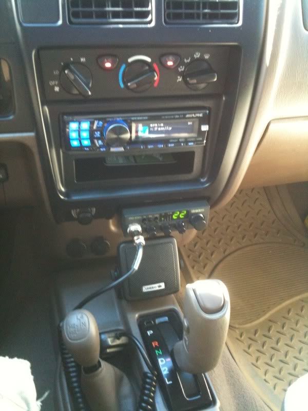

    I have the Uniden and mounted like most people in the ashtray location. you must cut away part of the dash behind the ashtray for the radio to fit. Some people will heat up the duct behind the ashtray and reform it with a screwdriver to allow the radio to fit more flush to the dash. If you use a straight coax connector on the back of the radio, even if you reform the duct, it might not fit flush. So get a 90* coax connector for the back of the radio and that will allow enough clearance for the radio to sit flush if that's what you're after. I didn't bother reforming the duct. I just used the 90* connector and it got me pretty close to flush mounting. It was close enough for me that I just left it as is. I used some high quality velcro to hold the radio in place.
    It's a good idea to use an external speaker. I picked up an inexpensive Uniden one to go with the radio. There are lots of different mounting locations for the speaker. I chose to mount mine right in front of the shifter. I think it's a pretty clean look, but not as cool as one mounted in the headliner. I just didn't want all the work involved in pulling the headliner.
    Here's mine.

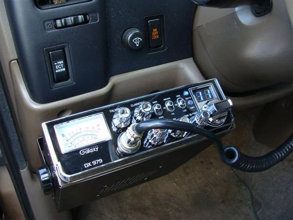

    Mounted my Galaxy DX979 on the bottom left of my dash since everywhere else was limited on space. No interference with fuse panel, hood latch and legroom. Mic is mounted in place of the dash clock. Plan to put a frequency counter on my dash somewhere soon.
