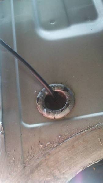

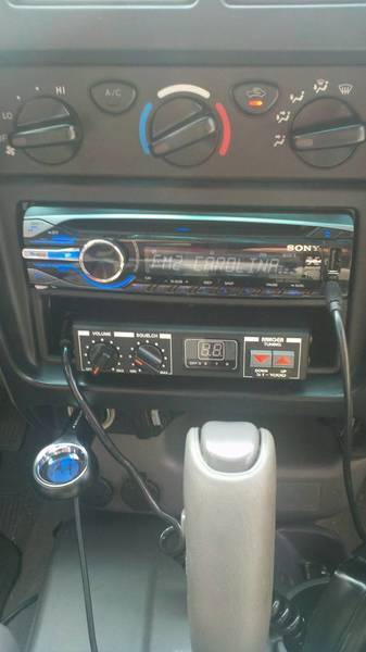

    Instead of wiring directly to the battery for power, i just went to the fuse box by the door.
    Decided to mount the antenna on the inside bed rail on the driver side, up against the cab and ran the coax down a narrow opening of the bed corner.
    I then ran the coax thru a rubber stopper on the outside of the cab that leads under the back seat, just cut an X in the rubber and the cable will slide right through.
    Cab set-up
