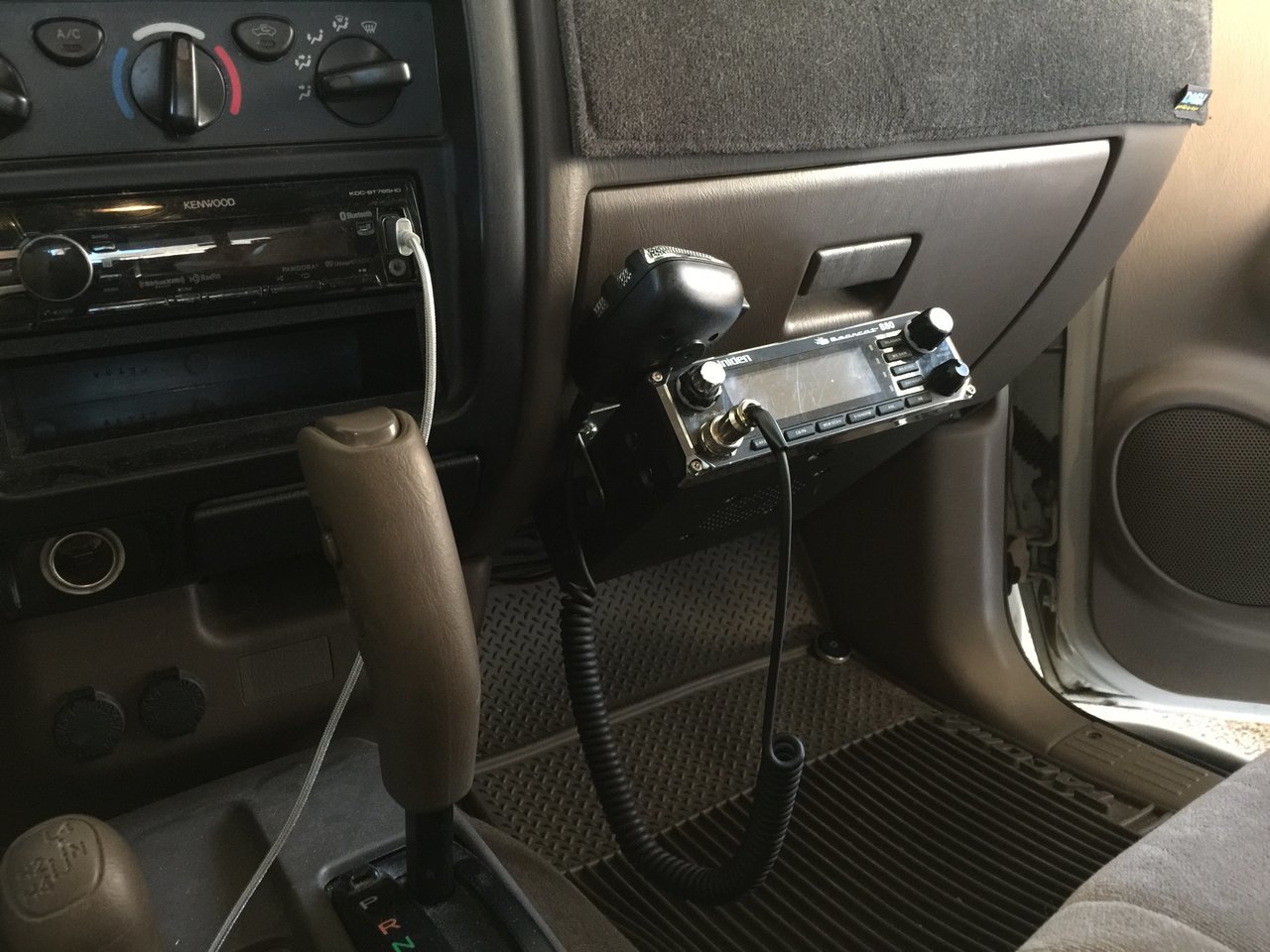

    Yaesu FT-1900R w/ 2m/70cm Comet SBB-224 antenna, Cobra 19 DX IV w/ 4ft Francis CB24 Hot Rod antenna, Uniden Bearcat BC355N 800Mhz mobile scanner (analog), an external BNC mount routed to inside the cab for a handheld fire/police scanner or HAM HT's, Rancho RS5000 front struts and rear shocks, 6in KC Daylighter (pencil beam), 15x7 Black Rock Wheels Series 942, 31x10.50R15 Firestone Destination AT, fog lights, COBRA antenna hood mount (this is used to mount the GoPro on to)
    Both posts is how I installed mine. I got the Cobra 19 DX IV where the ashtray used to be and the MIC where the factory clock would have been.

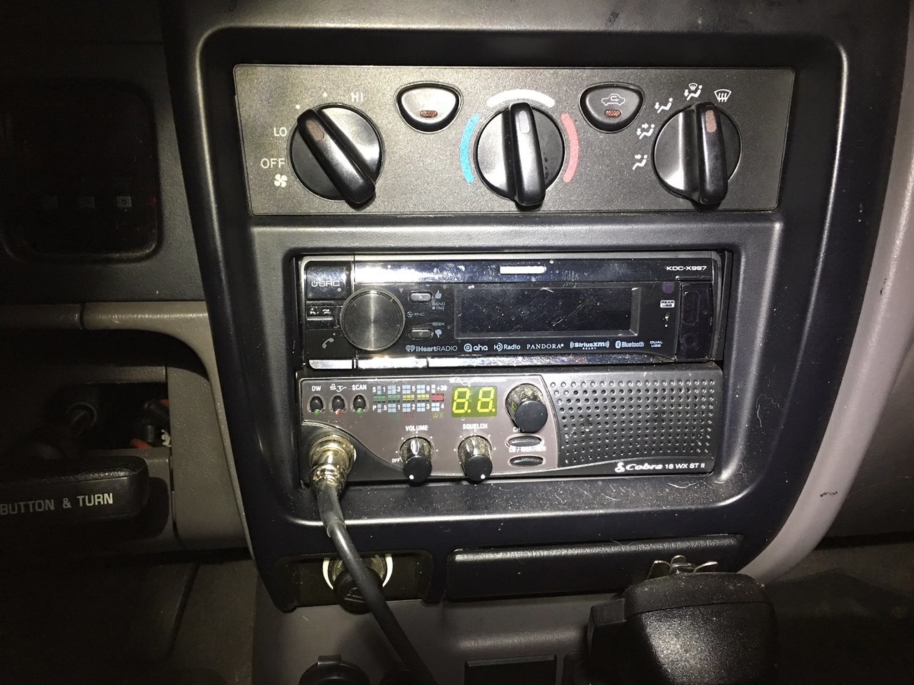

    my set up, CB stuffed into the ash tray spot.

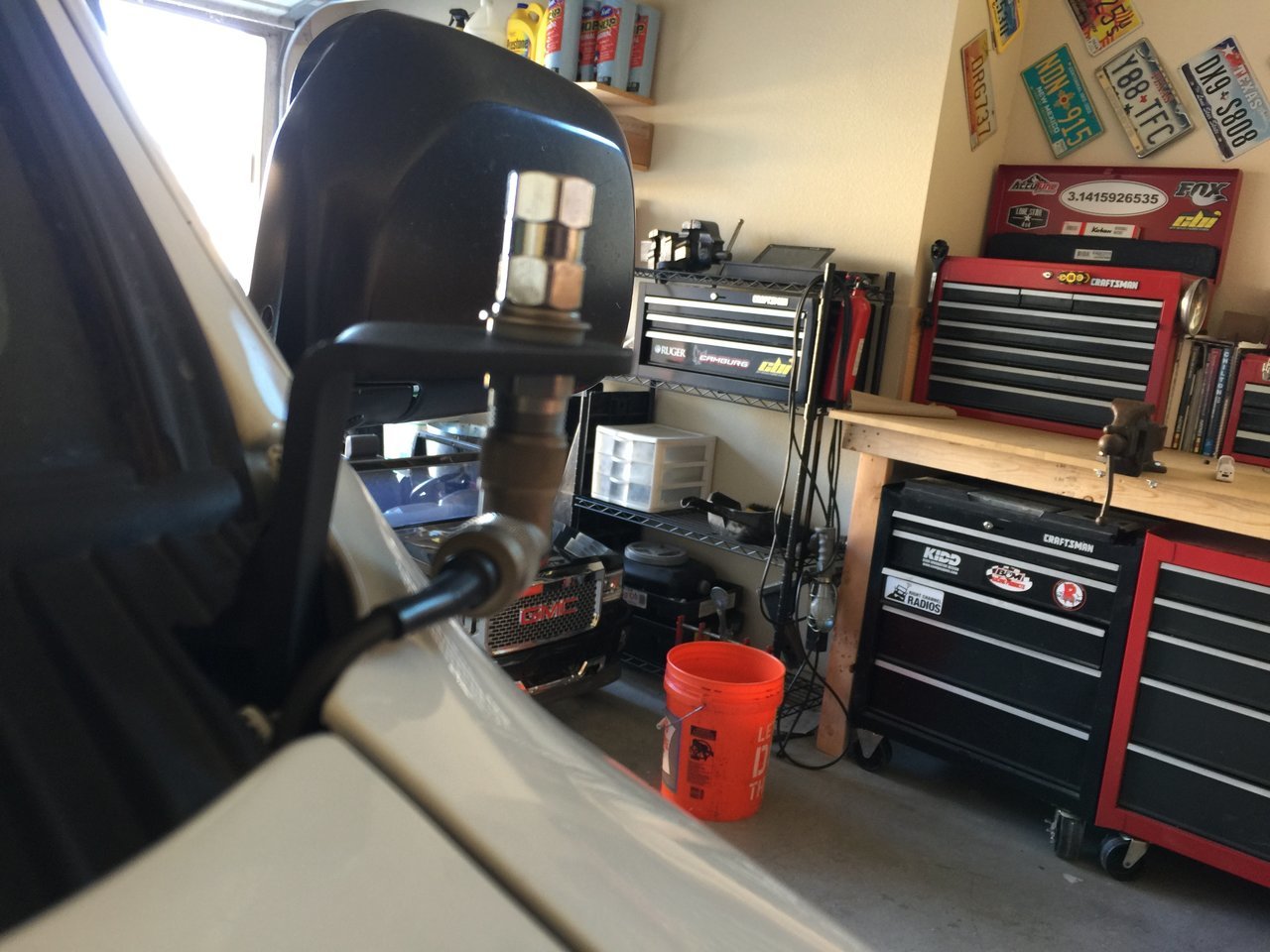

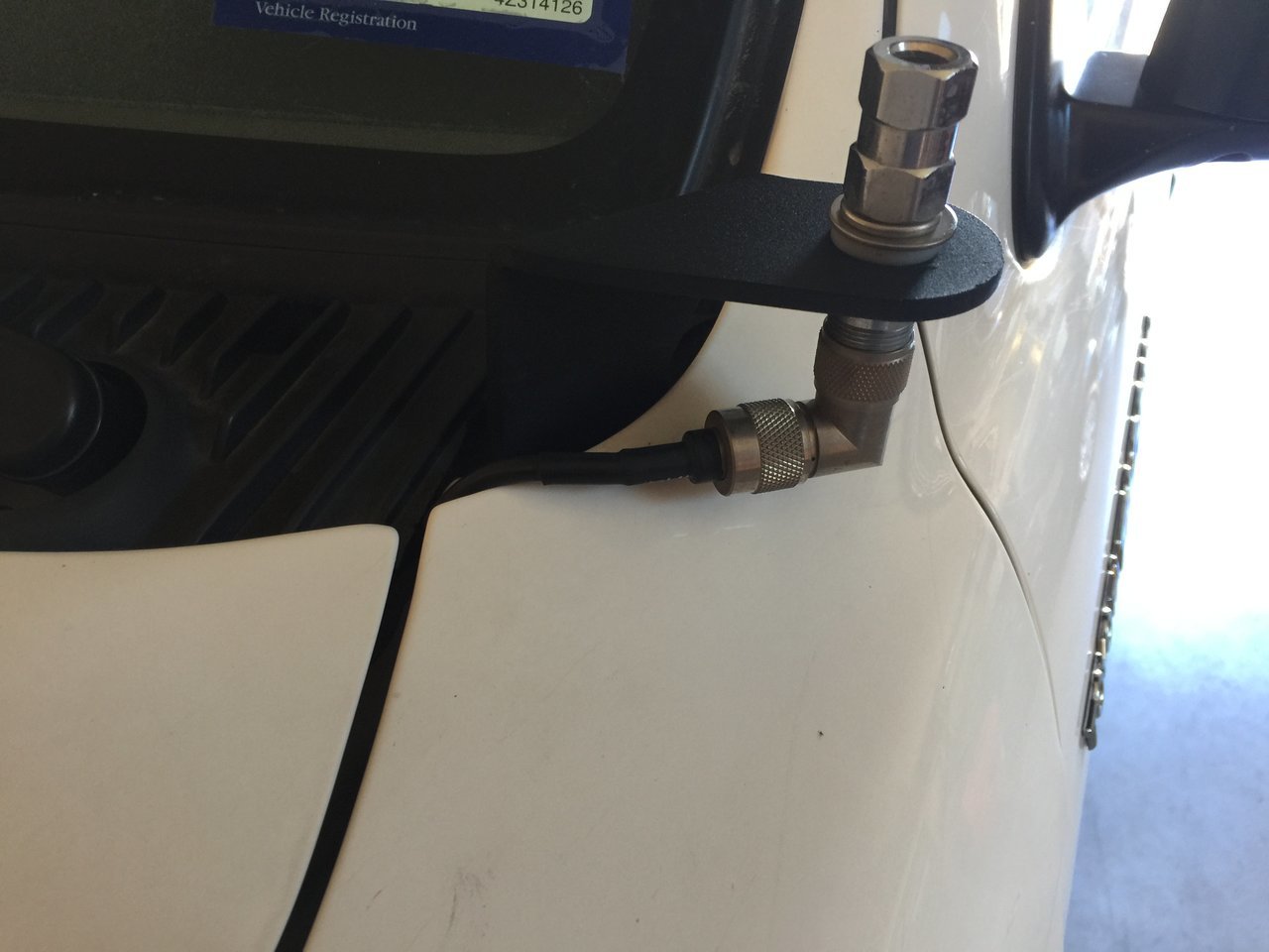

    Routed my antenna wires, which are mounted to the toolbox, along the inside of the chassis and up through the passenger side firewall, under the dash to the ash tray area.

    No, did not cut the bezel. Here is a higher definition picture, complete with smudges and dog hair, but you can see the radio and CB are simply stacked and inset into the opening. The Kenwood unit came with a surround bezel but the CB did not so I used none. Because the units and surround are black it works and looks nice. The real trick was measuring a half dozen times in order to get the radios aligned in the factory bracket and flush mounted.
    IIRC, the Cobra 18 model that I bought was designed to fit standard single din openings, unlike many of the other CB units whose dimensions vary so if you want one to fit the din opening that is something to be aware of.
    If I had it to do over again, I might opt for the small CB that fits the ashtray opening and use the double din for a modern radio/back-up camera. Getting more and more cars zooming through the parking lots anymore!

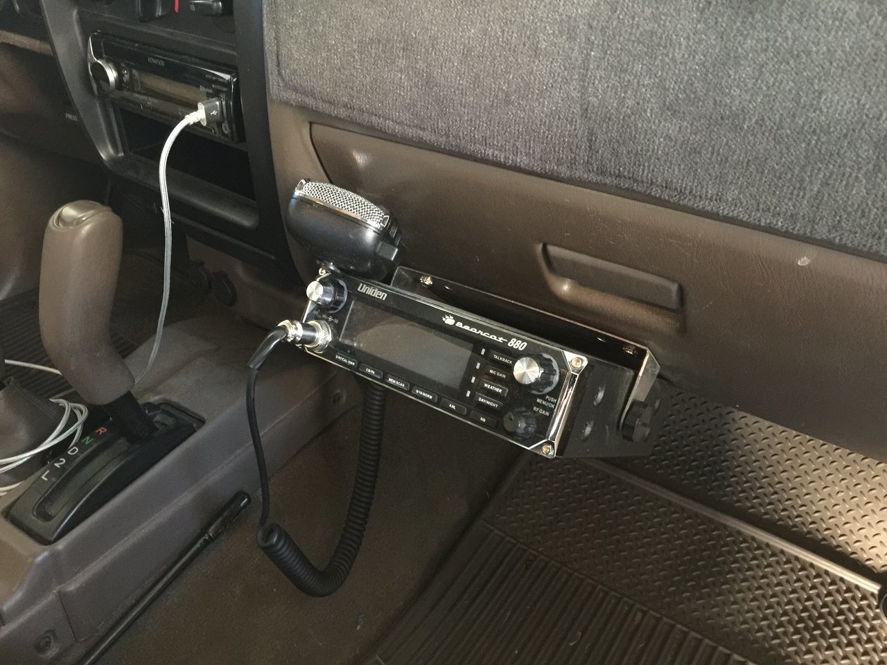

    I don't have a CB but I do have a scanner. Thought I'd add in my install location as another possibility for you. Mine's mounted under the steering wheel. Been there 8 years and never any ingress/egress trouble for this 6'1" guy.

    Pretty damn SLICK how you used the elbow!!! :thumbsup::fistbump::cheers:

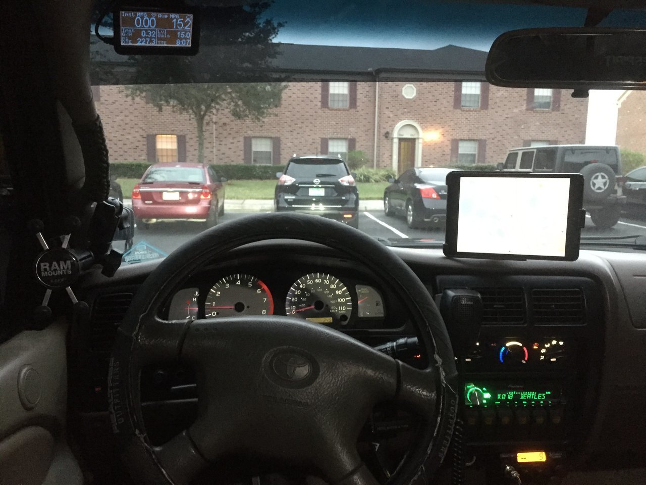

    WHAT CB is that?

    That looks like a Cobra 19 Ultra III to me.

    You can kind of see mine. Same exact setup. Is that the paranoid switch panel bracket?

    That’s what I was thinking. My ultra 19 fits perfectly in there
